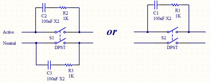

I'm building a chip-amp and thinking it can't hurt to use a C+R snubber over the power switch to reduce RF at turn-on. When using a DPST so both active and neutral are switched, is it necessary, pointless or bad practice to put in snubbers for both active and neutral sides (diagram attached)?
Good questiion.
Both contacts are effectively in series - 'though either side of the Tx primary.
You are protecting against contact arcing/erosion as much as anything. Since at that level the contacts will have different switching times and bounce, it would be better to snub both.
By a few orders of magnitude, put the snubber across the contact which opens first. If you can't tell which, then you need one for each.

Resistor in series with the capacitor (as shown in the attachement) or across active and neutral - I've seen resistors used across mains power and thought they were either part of a pi filter or something to do with passive power factor correction - I can find almost nothing on this on the internet (probably looking in the wrong places).
The audio amplifier application in question features a momentary self-mute on start-up (a capacitor pulling up the mute pin of the LM3886 for half a second) which may successfully suppress any switch EMI popping. In any case, protecting the switch contacts has got to be worthwhile.
From active to neutral? Um, both equipment and switch if possible. It's not a critical thing.You could put one snubber on the transformer side of the switch. Are you aiming to protect the equipment or the switch?

Thanks. I was momentarily worried that any leakage from the capacitors would cause some current in the rest of the circuit but if that were the case, one snubber on one switch would be just as bad and I've seen plenty of those designs.If you're switching both sides of the line, you'll need two snubbers.
Thanks, everyone, for your comments!
Putting a single snubber on the transformer side of the switch puts the snubber right where the main inductance is, and automatically snubs whichever switch contact happens to open first without needing two snubbers. With two snubbers, one across each contact, one of them is probably unnecessary but you will never know which one.
A single snubber at the transformer ensures that there is no leakage current when the switch is open. The only thing it won't do is protect the switch from any spike arising from the inductance of a long mains lead, but in most cases this will be smaller than the leakage inductance of the transformer. I usually just put a mains-rated 5nF or 10nF capacitor from live to neutral after the switch - no resistor as the transformer copper losses provide enough damping in most cases.

I can do either an X2 (fails with open circuit at extreme conditions) or
a 640V capacitor (no guarantee what it will do at extreme conditions but it can take a pounding re voltage). If the high voltage cap is more likely to provide a graceful and sustainable spark suppressant + RFI, I'll pick that.
I'm still a bit ignorant as to (a quite possibly imaginary) capacitor leakage causing a very un-green constant power drain. I've run a SPICE simulation at it showed a 2mV constant supply beyond the switch when snubbers were installed and after that it just got crazy (I think I've discovered the solution to infinite worldwide electricity - a Marsbar - um, don't quote me just yet) and the computer wanted a rest and have a cool sponge on its forehead (no, really!) - I don't trust a simulation with 'ideal' components.

These snubbers WILL (with proper R and C values) protect the switch, but will do little for the real problem, the "kickback" and ringing of the transformer's primary winding when a voltage as high as 160V is suddenly removed. Power transformers have a relatively large stray inductance, and the disconnection of the switch at any time other than the current being at zero crossing will cause a substantial voltage to appear across the primary, which then arcs across the switch contacts.
Snubbers with "proper" R and C values across the switches will indeed protect them, but will radiate the spike through the power line to be picked up by and interfere with other equipment.
The proper solution is to put a snubber across the primary, and use values that substantially reduce the spike. I just ran an LTSpice sim, with a SWAG at primary stray inductance of 1mH, primary DCR of 10 ohms, stray capacitance of 15pf (perhaps not significant here, but may make a difference without the snubber). I use two voltage sources and the "switch" thing to switch the voltage on and off at the peak, about 169V with 120VAC RMS input. With a C and R of .1uF and 1000 ohms the spike is 10.5kV. Fiddling around a bit, 4uF and a 10 ohms gives an overshoot peak of 15V. These may work with the transformer you have, but put in its DCR and stray inductance to make sure.
For best results make primary leads as short as possible, and put the snubber R and C right there at the lead connections, with leads as short as practical.
The LTSpice simulation file is attached if I did it right. A .txt extension was added because the attach thing didn't like .asc, so rename to remove the .txt extension to load into LTSpice.
With this, any voltage generated across the switch will be from the relatively small stray inductance of the chassis wiring and the power cord, which would have much less effect if any on other equipment, and shouldn't reduce the life of the switch.
Actually, the best position is across the contacts. Putting it across only the transformer neglects stray wiring inductance, from transformer to switch to power line. (And the stray inductance from transformer to switch *will* ring noticably, too!)
The most intuitive solution, put the snubber at the switch. When the switch opens, no other point in the circuit has higher d/dt. Put the snubber at the highest d/dt. This works for all switching applications: transistors, tubes, switches, relays, etc. In some cases, it's only a convienience (like here); in other cases, it is literally the difference between proper operation and instantaneous destruction! (IGBTs switching >100A are not appreciative of improperly snubbed circuits!)
In my earlier post, I recommended a Y1 type cap, which is rated for line-to-ground surges. X1/Y2 type are rated for line-to-line, which is also suitable here, though Y1 types are usually ceramic, and therefore will have somewhat better performance over 10MHz. In both cases, these capacitors usually come in 250VAC nominal ratings, but are specified for peaks of several kV.
If you use a fairly large capacitor (like 0.1uF), you will draw noticable current, but it is mostly reactive current, so the power meter doesn't see it. Such a large value isn't good practice though.
Interesting factoid: if you use a fairly large cap (like 0.1uF) into an unloaded transformer, the primary voltage will read higher than line voltage. This is simply because it's acting like a series resonant circuit. This is not dangerous (though it can result in unexpected voltages).
