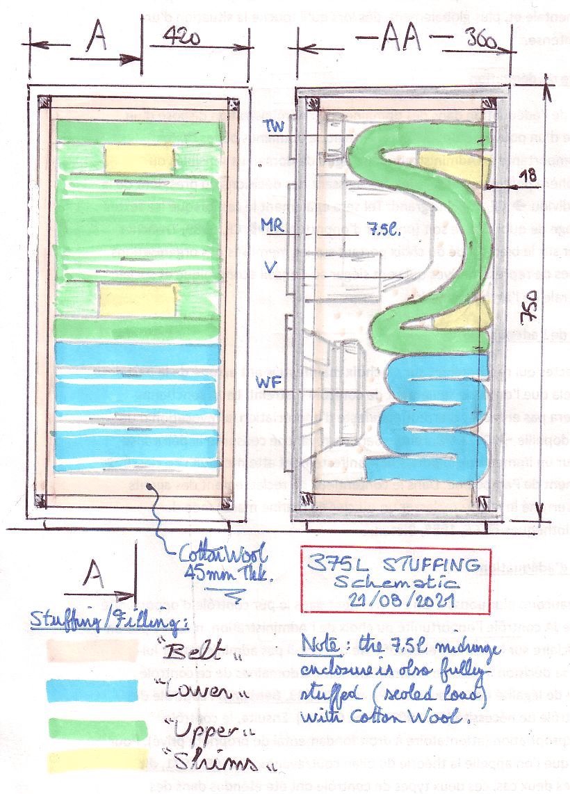

Don't use polyfill. It's only advantage is $$$. Use Fibreglass Roof insulation; the really nasty stuff. You need quite a lot .. about the consistency of a cushion. Try to fill all the internal volume. But leave a free passage between the bass unit and the port.
Audible advantage is much better midrange. How much better depends on the frequency range of the unit used.

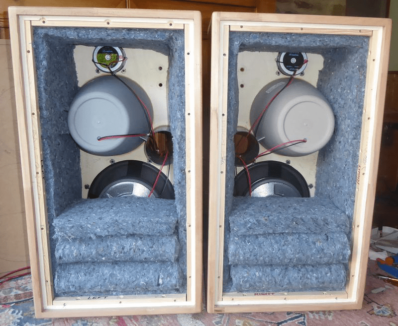

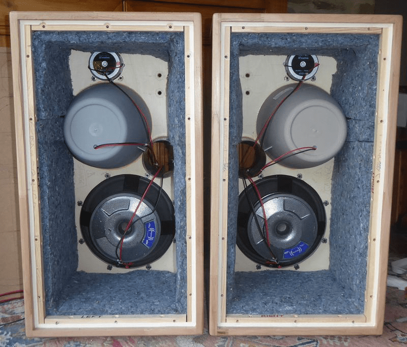

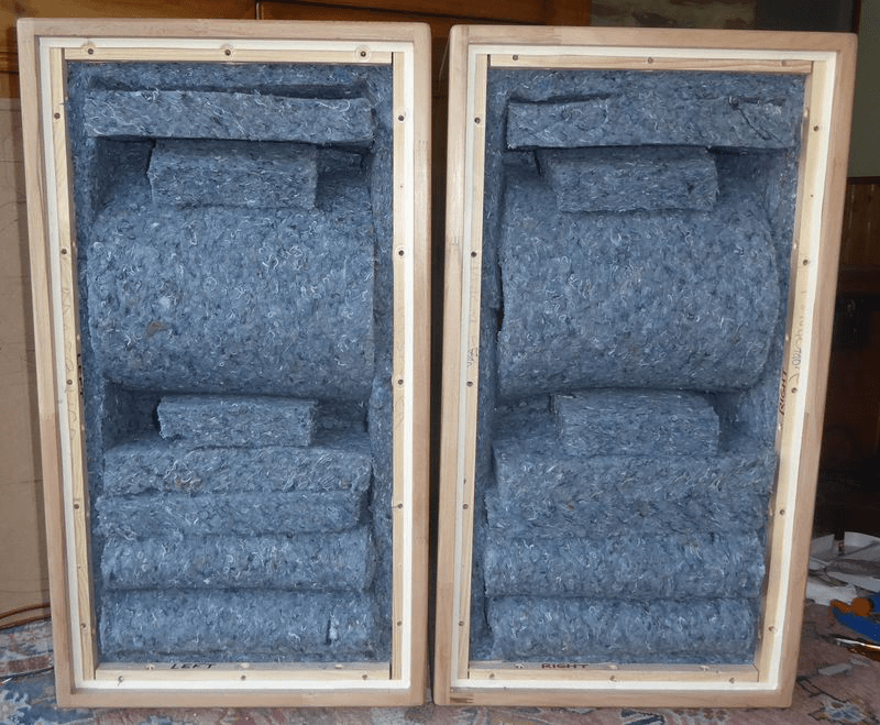

There they were

I have 2 pairs of Snell EII’s, both have a single polyfill sheet, several inches thick, running from the top of cabinet down past the woofer, but not all the way to the bottom (You can’t see the poly through the port). It’s a fairly loose affair, hiding the crossover and rear tweeter from view. Not “stuffed”.

I was wrong about the stuffing. Looking again (it had been a while), they do have their original stuffing, and it's installed as Pure_Brew describes. I'm going to leave it as-is.

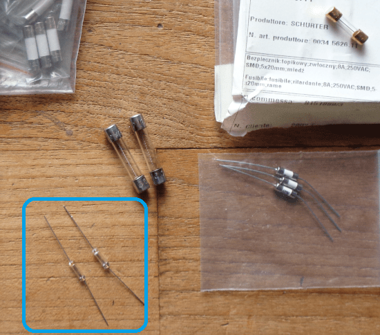

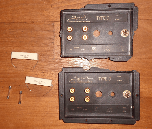

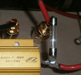

Peter Snell (R.I.P.) was an exceptional designer and his speakers sound magnificent, and as I don't think they can be "improved" I frankly wouldn't even touch them (Type D here) excluding the binding posts and their tray.
I replaced them with 2 pairs of good quality copper binding posts and a 10 mm polycarbonate plate.
I replaced the carbon resistor in series with the L-pad with a good quality wire-wound one (which in my ears makes a good difference, even when compared to "noble" " Mundorf ones).
I completely disconnected the rear tweeter wiring.
Also, I removed the fuse and its holder, and replaced the original Bussmann-Eaton fuse with a glass fuse (few cents each, from AE) of the same characteristics by directly soldering it between a binding post and the wirewound resistor (that's in seriers with the front tweeter).
I had already done it with the original fuse, but at the end of the tests I kept the glass one.
According to some listeners, the presence of the fuse (and its holder) is audible (if I remember correctly, I read it mainly referring to electrostatic speakers) and someone removes it completely.
I'm not of the opinion of risking so much, and the glass fuse seems like a better choice to my ears.
Since it costs practically nothing to try, I invite you to try it and then let us possibly know.

do you still have the original trays?
I'm sorry to tell that they are not for sale also and above all because they are visibly damaged as the thin plastic of the edges has not resisted several disassembly and reassembly during the years. :smash:
However, JFIY the glass fuses (not the ones in the photo which are the original ones) are 250V 2A Fast Blow 3x10 mm. directly soldered, like the following (they are extremely cheap and small, but they sound great to my ears, i.e. they don't sound at all).
https://www.aliexpress.com/item/4000340166381.html
