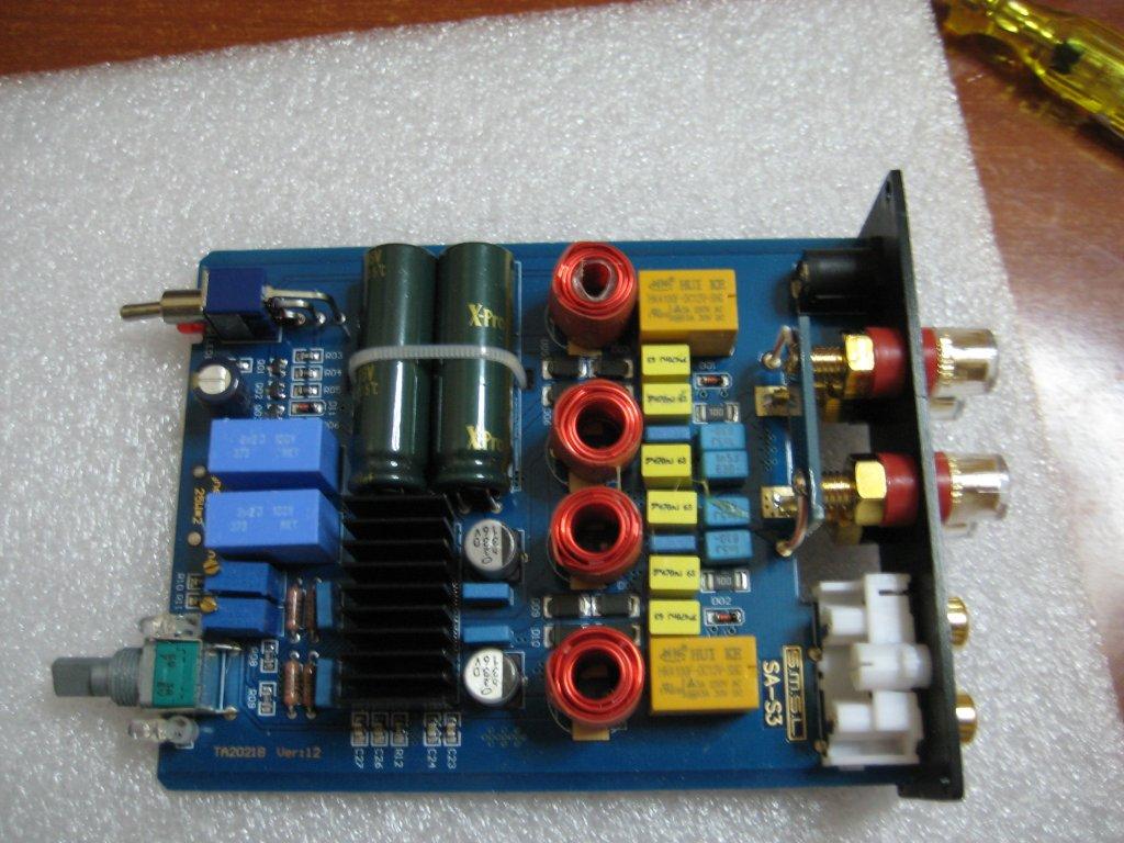

next up will be mods but will open it up and see whats in there first because I think it has some decent components already the info says it has 9000uf filter capacitor but with what ive read on the forum they can come with a mish mash of components heres a pic of the so called inside of mine any thoughts on mods ?

If you really want to take the best out of this amp, i suggest you the following upgrades.
A) Replace input caps (2.2uf) with good quality MKP caps (Jansen, Mundorf etc) you will have to transplant the amp to a bigger case, since MKP caps wont fit otherwise.
B) Replace psu caps with low esr caps (Panasonic FC, Nichicon, Rubycon, etc).
C) Bypass or replace the volume pot with one of a better quality.
D) Optimize output stage according to your speaker impedance.
