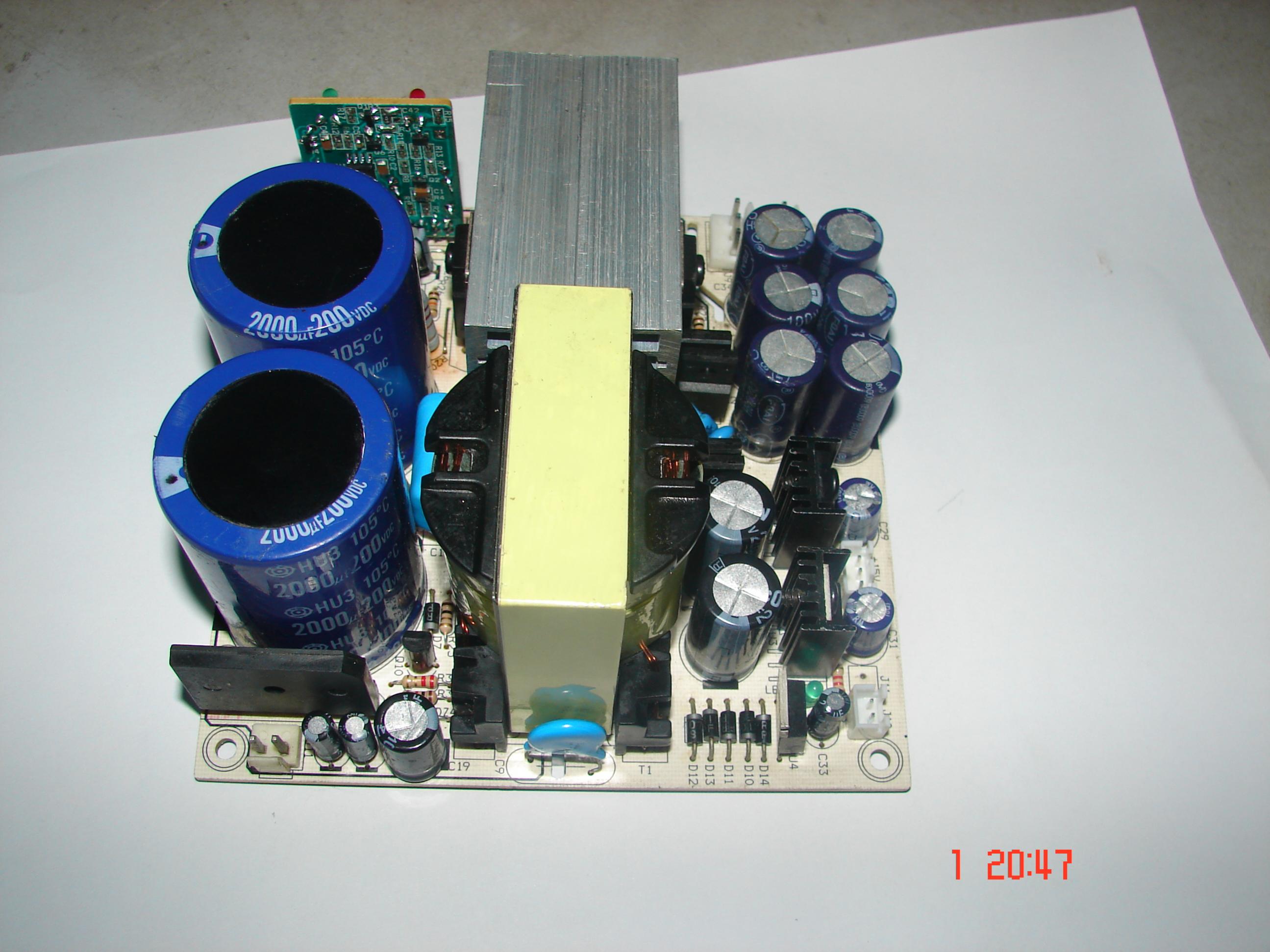

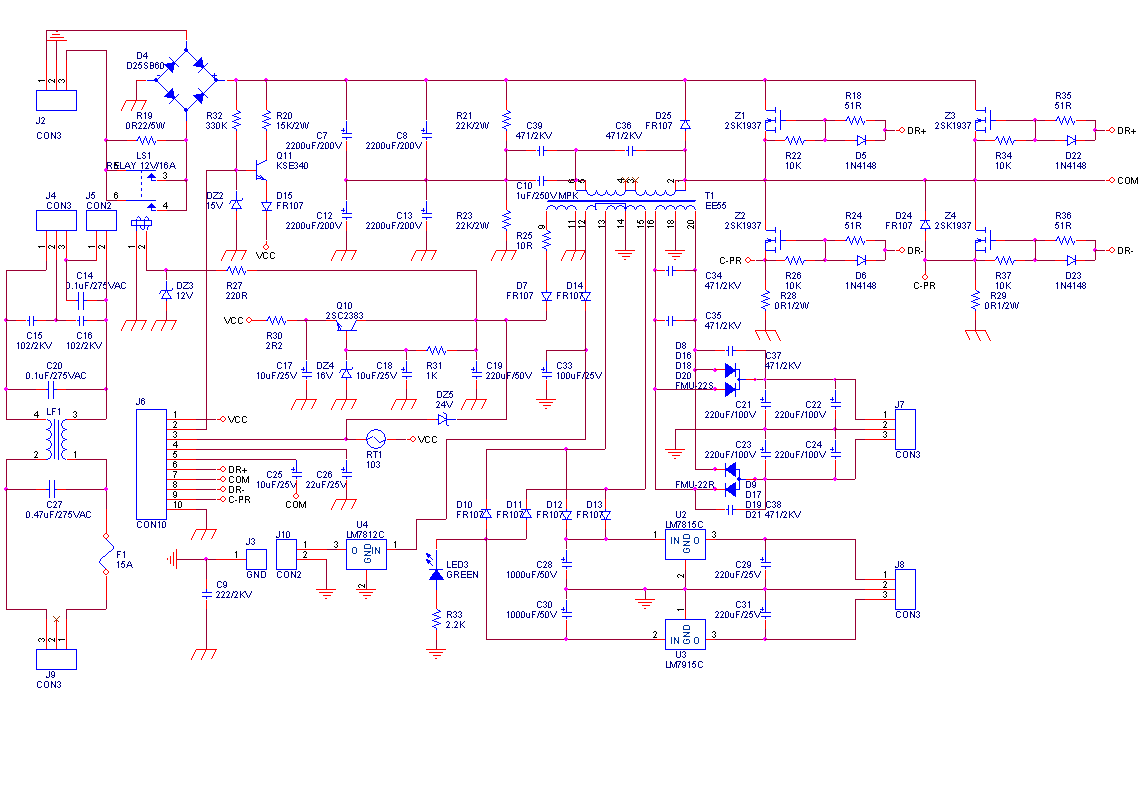

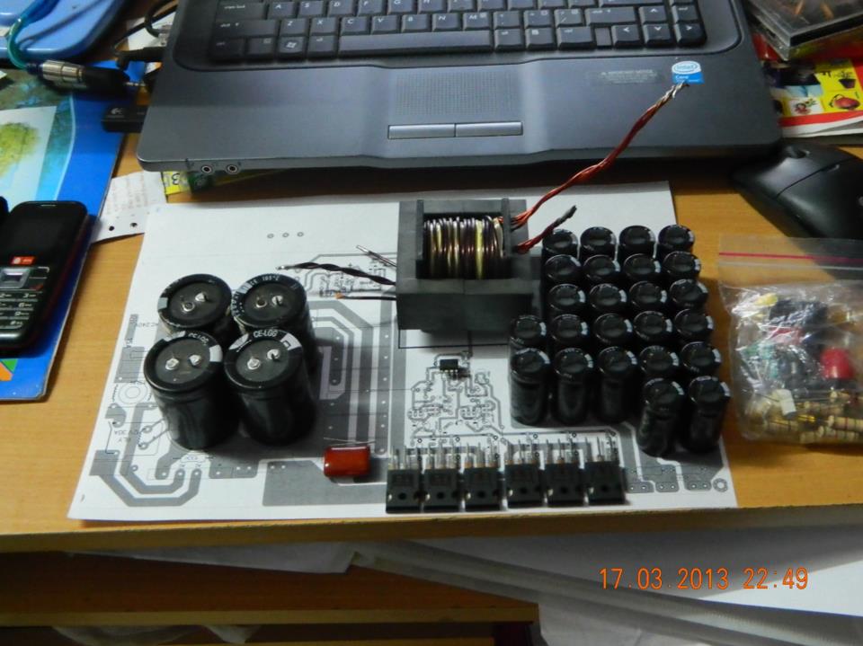

My design an switching power supply use IR2153 + mofet(or IBGT) for audio amplifier
+/-63V,12A (unregular)
+/-15V,800mA for pre amplifier circuit
+12V,800mA for protect circuit,fan,...
size 12x12cm
size 12x12cm

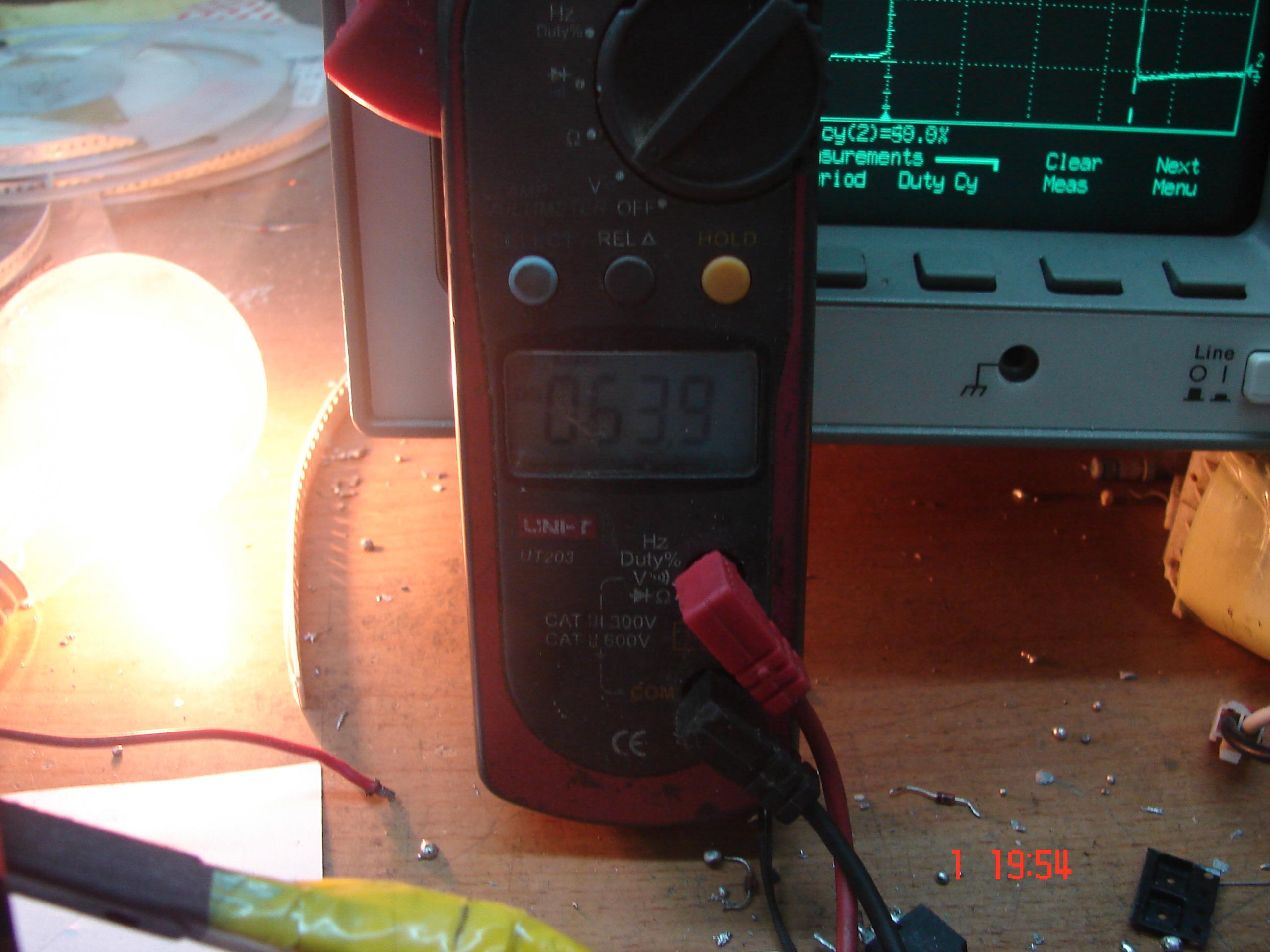

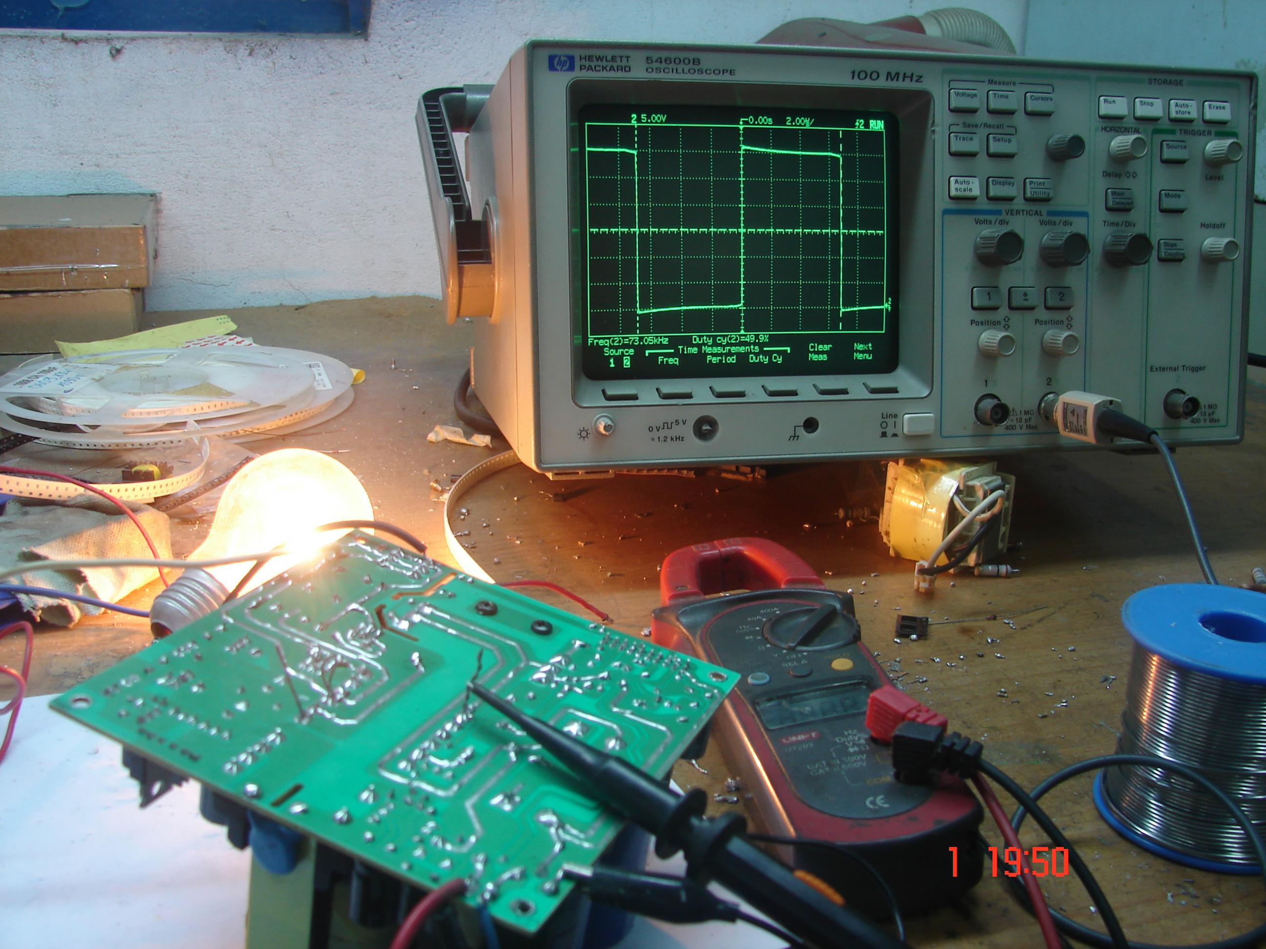

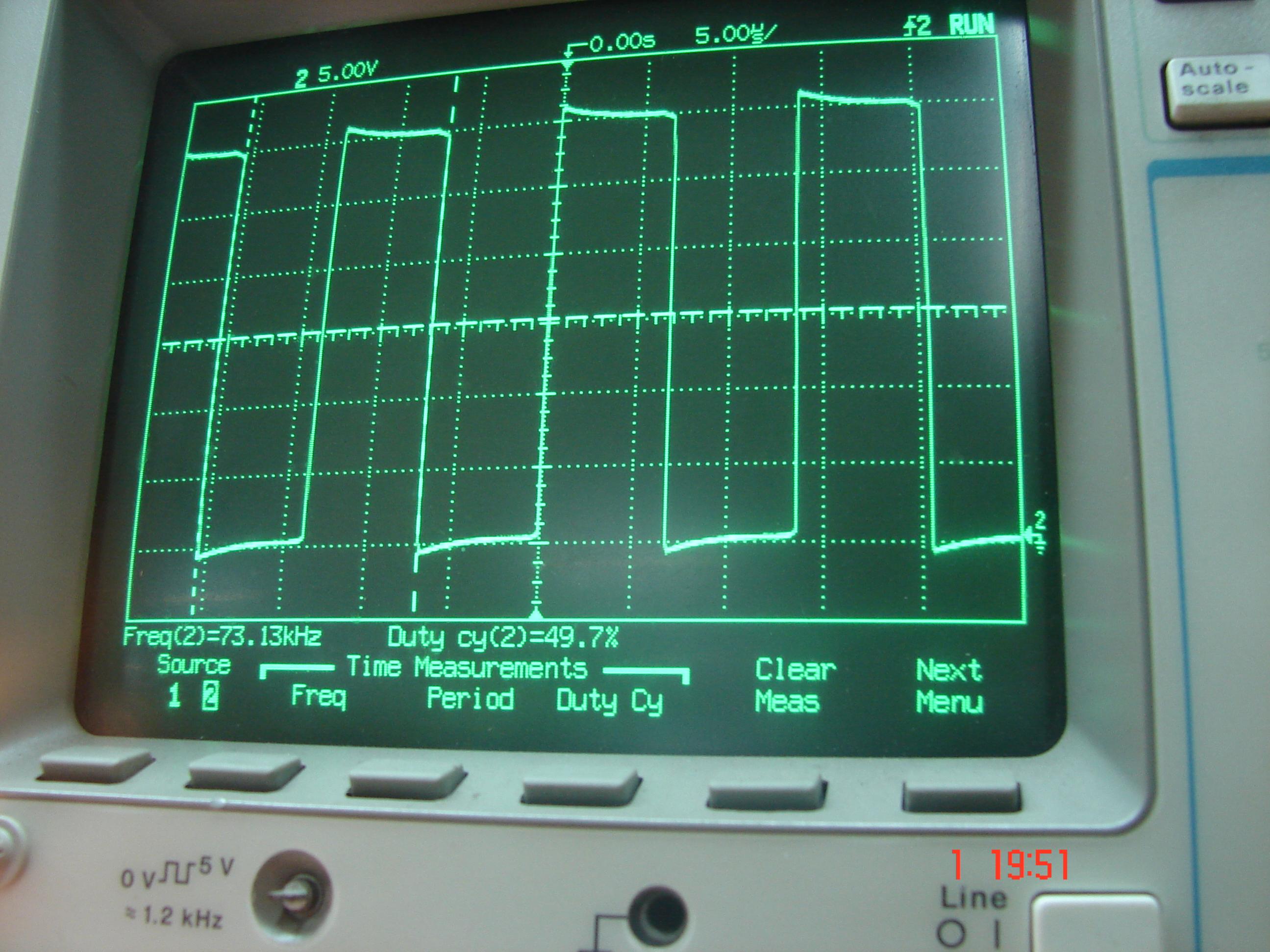

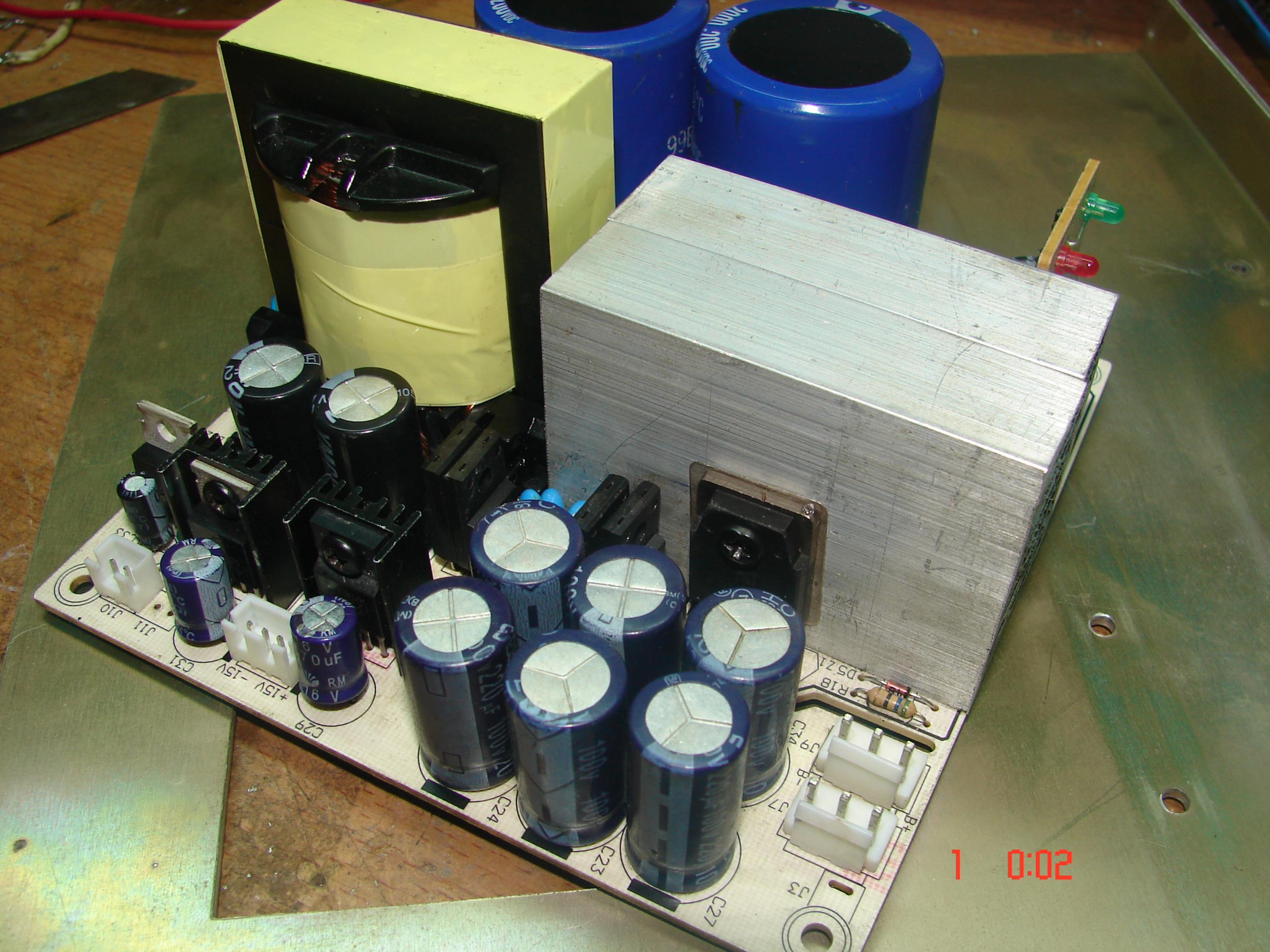

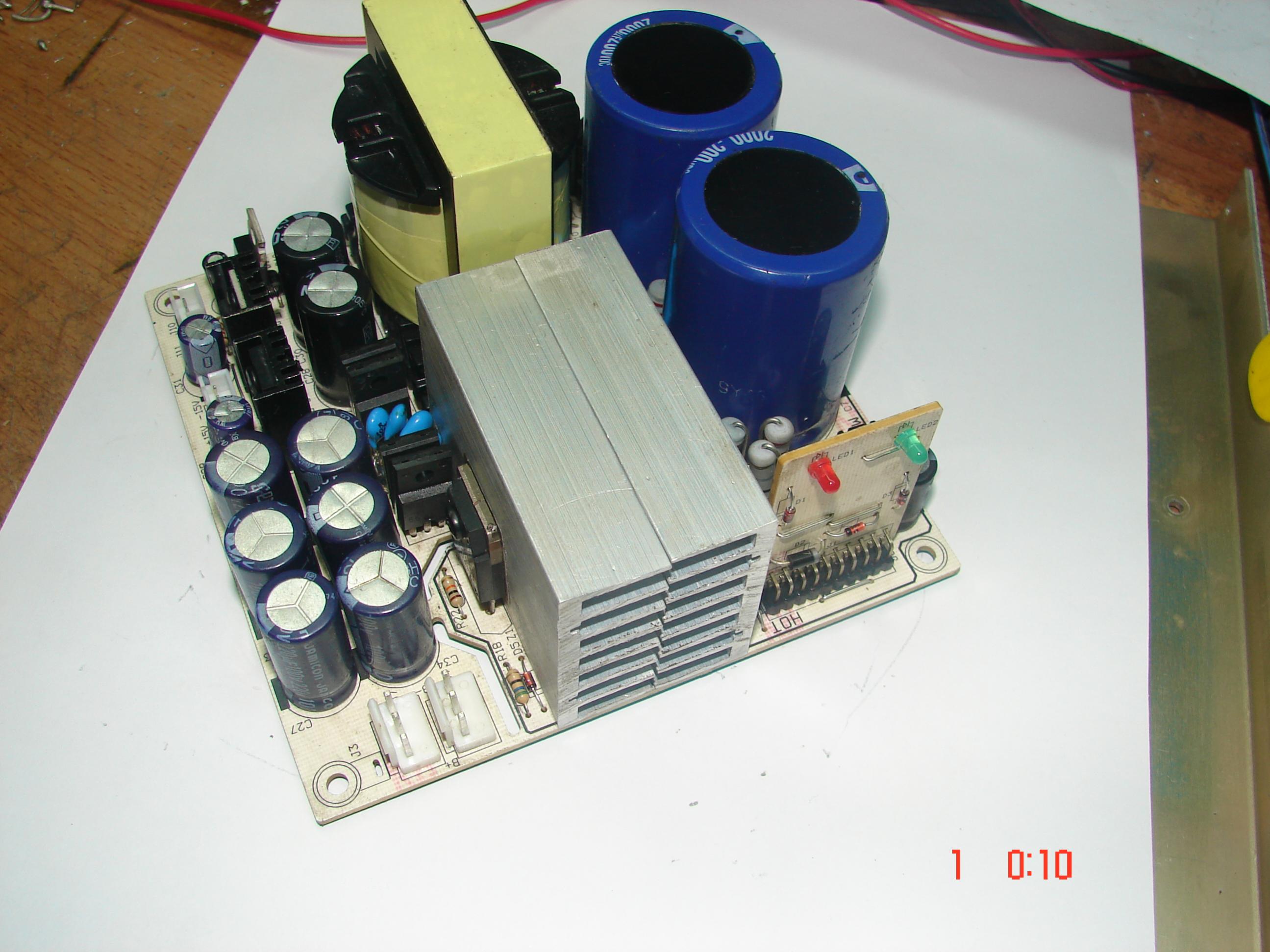

Testing with load is resistor 30ohm(4.2A) + 1 lamp(0.6A) = 4.8A from B+ to B- ( total 126V = 63Vx2)
P = 126x4.8A = 604W not use fan in 2h
Heatsink for mosfet about 95 oC,if use small fan is power higher
size 12x12cm

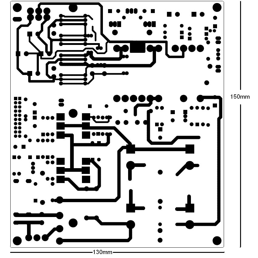

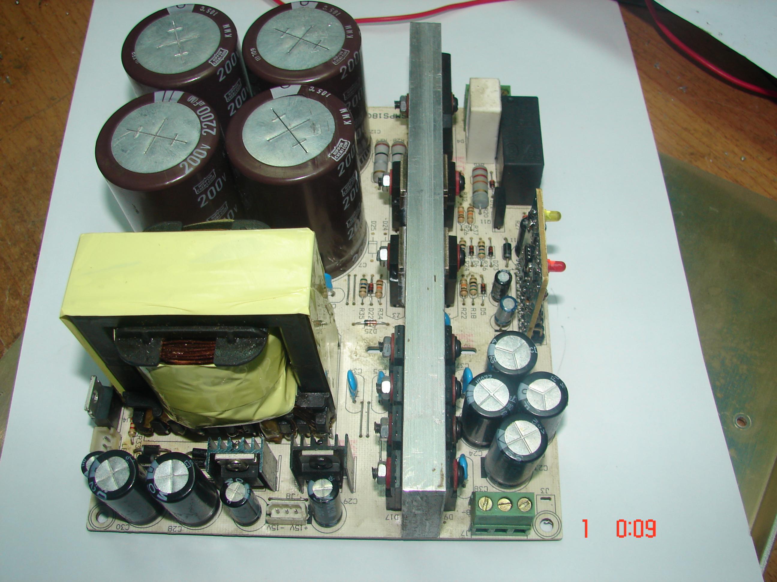

I have an smps about 2.6kw
+/-100V,26A,use fan for heatsink
Hi Hien.t nguyen
Very nice design
What it is the pcb size for your 2.6KW PSU
regards panslspan
Thank your interested
PCB size of smps 2.6KW is 130x150mm,switching transformer use EE55

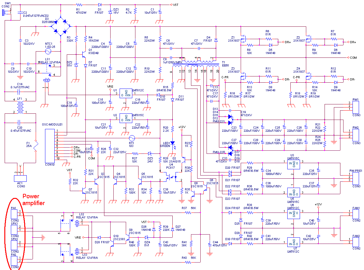

Hi Hien.t.nguyen
greetings is this full schematic
1 source of CPR signal
2 overcurrent protection
3 voltage feedback
warm regards
andrew lebon
Dear Andrewlebon
1. Point CPR is over current protect (about 20A at pri)
3. My smps use IR2153 unregular for main voltage(+/-100V),not need voltage feedback
My smps has been over voltage protect,over current protect,over temperature protect.
regards
Hi Hien.t nguyen
greetings can IRFP460 BE USED i have over 100pcs nice schematic
warm regards
andrew
yes,IRF460 use very good.
regards

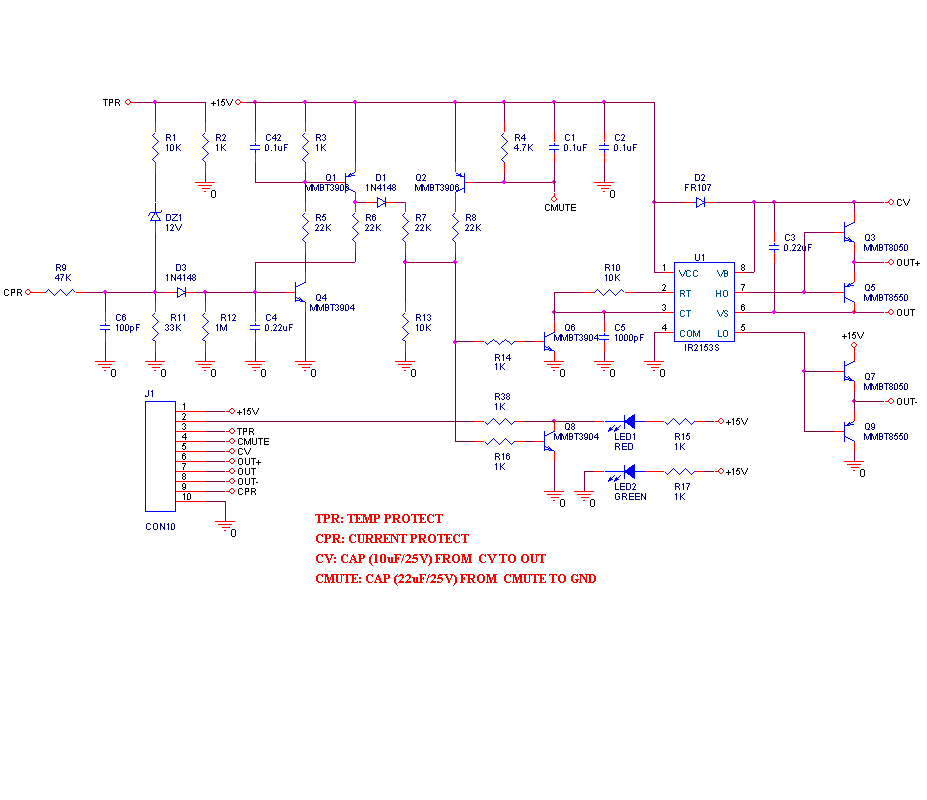

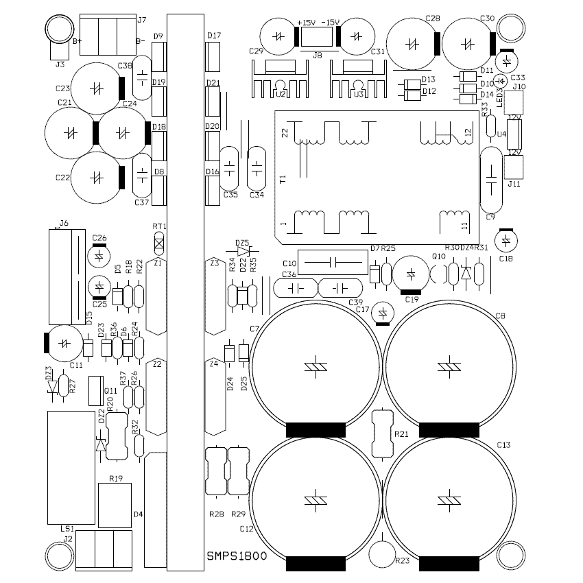

Hi Hien.t nguyen
You have a layout for this schematic #16, ( speaker protect) ?
Regards
panslspan
I am doing,but not yet
Hope I will complete soon.
regards
