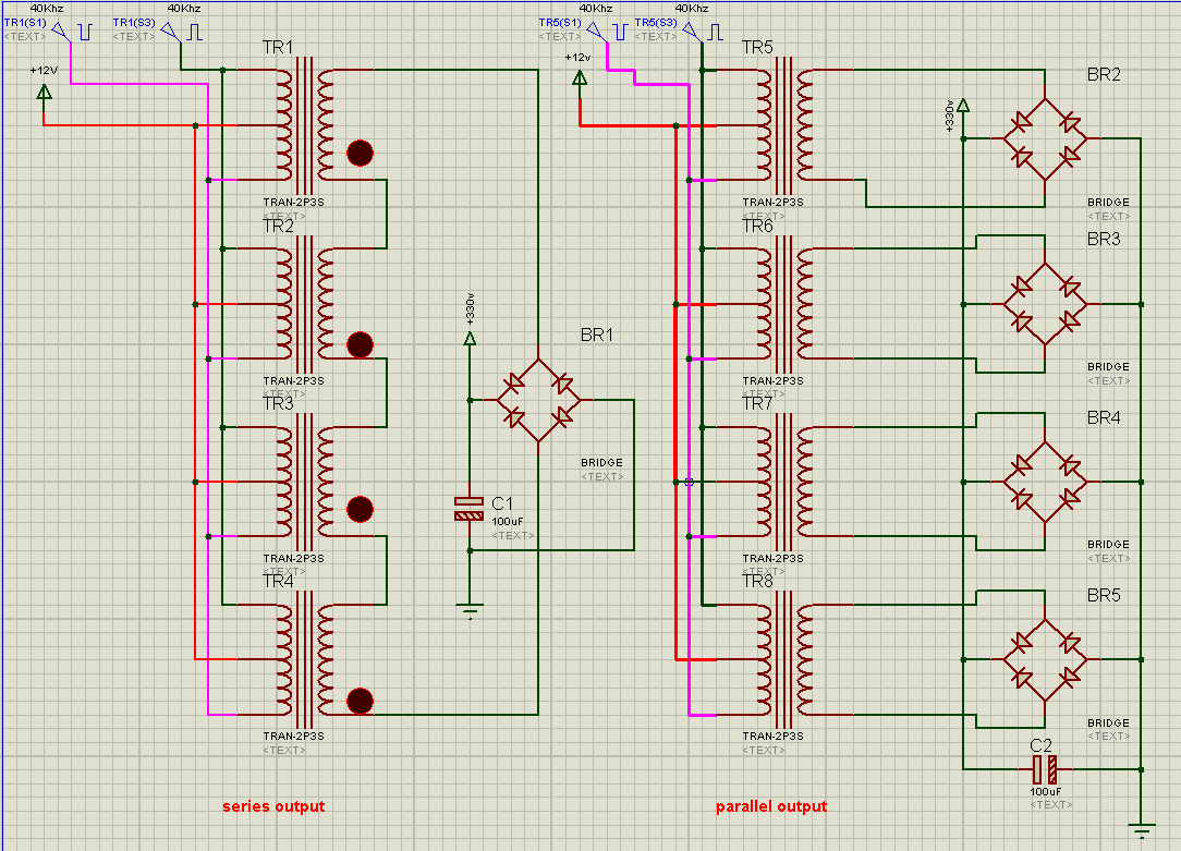

Either you do primaries in series and secondaries in parallel (possibly through individual rectifiers) or vise versa - primaries in parallel (possibly through individual inverters) and secondaries in series.hi,
Please help me with right answer. which is best and why?
i want to build 1000 watt converter from dc 12v (vin min 10) to 220ac
i have both sample from china.
thanks

You’re not going to get 220v AC out of either – both circuits show the output being taken from a capacitor fed from a bridge rectifier. So either way, the output is DC not AC.
The difference is, the arrangement you call ‘series output’ will provide a higher voltage but less current. The arrangement you call ‘parallel output’ will provide more current but a lower voltage – assuming that the transformers are the same in both cases.
What I don’t understand is – why don’t you use a single transformer, dimensioned to provide the output voltage and power you require? Why four output transformers?
do like this: primarys in || like in every high current app.
Then series secondarys, for current sharing

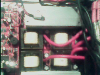

I know that its DC. then make it 50hz 220 ac square wave to final output. i have skip it. they use EI 40 core * 4. pri turn is 2+2 with 0.25mm copper foil 15mm width 12inch length, 40KHz frequency per mosfet leg. and secondary for 80v * 4 = 320V . they use 4 strand 0.70mm (22 no wire) * 12 turn. for 2000 watt continuous load and pick 3000 watt.😕 r they injecting current?
what do u mean by that.
u cant drew 100 of amps continuously from single 12v battery, largest 12v deep cycle battery in the market is 200ah, to keep safe in theory u can only take say 20 amps from it ok may be 40 amps is fine for it , but 166 – 300 amps no way,
It may explode,
Should use series output scheme, wire thickness depends on many things say for example ambient temp, so u have to try first to see if the wire can handle the amps without causing smoke
