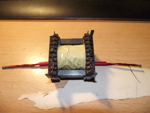

my trafo has 13 turns primary in 1 layers and 4 turn secondary top over primary.i can control secondary temp by cooling fan but snubber resistor is still problem
my Trafo:
The trafo looks good, but it will be better interlaying secondary and primary, as ½pri, 1 sec, ½pri. Take a reading to the Lloyd Dixon's articles at TI.com
you mean for example in first layer i wind 3 turn primary and 1 tun secondary and again 3 turn primary and 1 turn secondary and continue this way ?The trafo looks good, but it will be better interlaying secondary and primary, as ½pri, 1 sec, ½pri. Take a reading to the Lloyd Dixon's articles at TI.com
about Dixon's articles you mean those articles about winding losses?(skin-proximity)

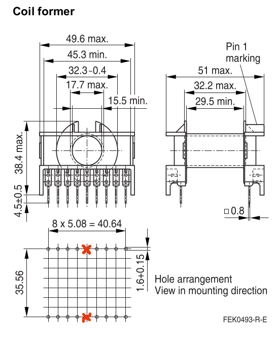

https://www.tdk-electronics.tdk.com/inf/80/db/fer/etd_44_22_15.pdf
The numbers appear to work out in terms of flux density excursion but as is often the case in a half bridge too low number of turns means you have to get creative with how you implement things. It may be counter-intuitive but sometimes more turns are better if the end solution is neater.
The following might fit.
Your winding width is 29.5mm. Take away 3mm margins either side. You are left with 23.5mm. Use 16 turns primary with 5 turns secondary. Wind the primary as two sections/layers sandwiching the secondary. Don't forget the isolating tape and try to be neat.

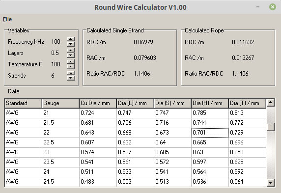

First section/layer two ropes of 6 by AWG 26, heavy insulation. Wind side by side as one layer of 8 turns with 3mm margins. Leave tails.
Three layers full width insulating tape.
Second section/layer two ropes of 6 by AWG 22, heavy insulation. Wind side by side as one layer of 5 turns with 3mm margins. Leave tails.
Third section/layer two ropes of 6 by AWG 26, heavy insulation. Wind side by side as one layer of 8 turns with 3mm margins. Leave tails.
With the tails parallel each section. You can do this because the windings are in the same layer. Then connect the primaries externally in series.
In terms of winding width things may be fiddly but overall height is about 5mm and you have just over 7mm.
As suggested losses are down to penetration/skin depth. proximity and layer factors. Splitting the primary around the secondary leaves the primary as, two, one layer items but the secondary becomes a half layer.
In terms of layers one of the important factors is overall height of the layer. Using a big fat litz wire/rope ends up with high height. Splitting to two or more windings in the same layer reduces that height but in order to parallel them they must be in the same layer.
That's similar to the twist in a rope. The twist ensures that the wires that are paralleled in the rope are subject to the same integral or overall flux and don't end up shorting any residual or minimise such effects.
The zip file is a program written in Delphi 4 that does the sums based on Dowell's paper. Should still run under Windows and runs under Wine in Linux.

thank you so much.
i rewind trafo according to your tips.
but what is benefits of this sandwich winding method?does it affect on reduce proximity effect?

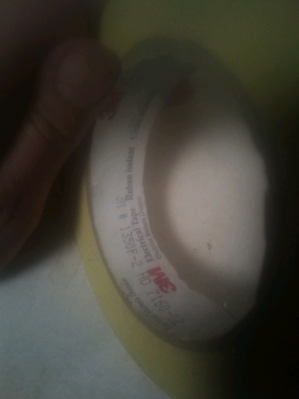

if i use three-layer insolation tape beetwen layers does it make heat dissipation problem?or not?
and finally isn' it better to use copper sheet instead of two bundle at secondary side(middle layer)?

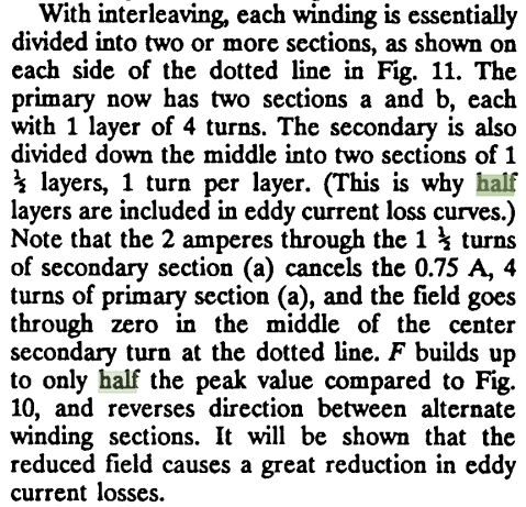

Full Fat Lloyd Dixon...
https://www.ti.com/seclit/ml/slup132/slup132.pdf
Interleaving reduces the layer/proximity effect. Covered in the above.
The tape is mylar/polyester 2mill [thousandths of an inch thick] and does not add much to winding height. There is no real penalty in respect of power losses.

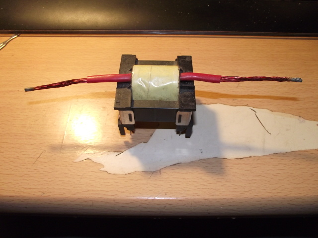

i wind trafo again according to sandwich method and test smps again.
i use LCR meter to measure inductance and leakage inductance.are these measured value especially leakage inductane sign of winding quality?

first thank you all especially MorbidFractal
i wind trafo again as you see in picture.
reduce freq to 80 KHz.
now trafo temp especially secondary temp is less and at full load it's under 70 degree.
now snubber resistor temp is under 80 degree
finally smps can run continuously under full load(36V/21A/750WATT) with above temperature and with a fan that temps become very lower.
but about trafo is that looks good and safe now?can i wind it better?what advice?

Looking neater. Your chosen 3 and 6 bundles appear to make more sense and get the job done. You might check losses using the calculator but if it is running at an acceptable temperature then...
It looks like you would achieve the margins on the primary but the secondary could be tight. Nice yellow tape. In part the remaining problem would be stabilising the margins. At the moment the problem is likely to be dressing of the wires as they exit the bobbin. It looks like your bobbin has a few war stories to tell.
Again this is down to isolation concerns and the obvious choice is to terminate primary and secondary windings on opposite sides of the transformer. My fault for not suggesting this previously.
Oh as an add. You should sleeve the windings as they exit to maintain the integrity of the isolation.
If you chop out the centre pin each side of the transformer then you end up with 10mm creepage and clearance, agency is 6mm, distance primary to secondary. Unfortunately that might not agree with your PCB.
However rather than having to wind from and return to one side of the transformer now, for example with the primary, you wind/terminate from one side the first primary section and terminate the opposite side. Then when you get to the second primary section you wind/terminate from the opposite side, series connection, back to the first side.
Your secondary windings just go straight across. If you want to be adventurous then you could bring the secondary ropes out as flying windings using the two notches in the top of the bobbin.

i have a question.you said secondary become a half layer.i want to know what is half layer?i can't understand why it's half layer?why it isn't one layer between two layer primary?The trafo does not look good. It is an abortion that is waiting to kill you.

It's down to how the MMF builds up as you traverse the windings. Non-interleaved you get a single peak in the middle. Interleaved you get two lower peaks, with a zero crossing.
Associated energy/loss is square of this.
A four layer primary split into two sections becomes two two layer sections. The cumulative MMF in each section, opposite each side, is halved.
A sandwiched four layer secondary straddles the zero point and behaves as two two layer sections.
A sandwiched three layer secondary straddles the zero point and behaves as two one and a half layer sections.
Using the graphs is a bit of a pain which is why I wrote the program. Using the program is also a bit of a pain because you still have to make intuitive choices and manipulate the results.
Note that it has an input for layers that includes half layers.
