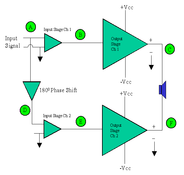

Using a bridged topology would eliminate the need for a large current return to a virtual GND or a DC blocking output cap. You can use a higher Z floating reference halfway between B+ and GND 0V as the input source common so the output of each amp will be halfway between the B+ and 0V. This is the best way to get 0VDC output from a single end power supply, especially with only 30V. 50Wrms @ 8R is possible from full bridge topology.
My proposal does not have 4 times output power as your has, but it does has advantages: simpler, cheaper. Just two resistors in the simplest case. And no turn-on pop as for the "standard" method of adding a capacitor in series to the speaker.

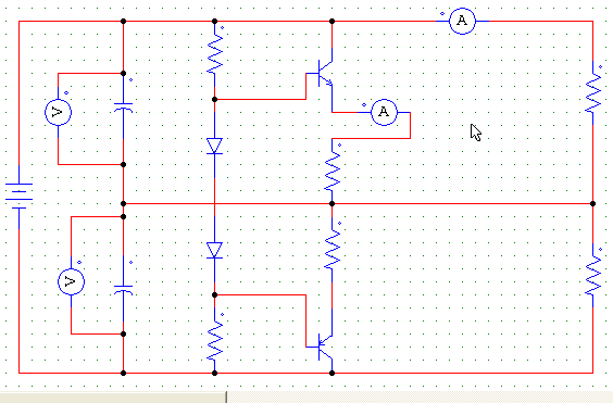

Hi!
i m posting here again so as not to start a new thread..
i m about to test a rail splitter like this one
i want to split a 30Volts into +-15 and i m not to sure what should the rating of the capacitors be...25volts would be ok ???

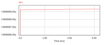

i run a quick n dirty simulation with psim of the divider with a resistive load showing that the voltage across each capacitor is from zero to nearly 15 volts...
so this is the schematic and the voltage across one capacitor.
also for 1,5 amperes at the positive rail (through the resistor from +15 v to ground) there is 1,5uAmperes at the emitter of the respective transistor

The component values in your circuit are not shown....
The capacitor must be rated for 30v plus margin, so a 35v type should be ok. You must account for an unbalanced bridge, for example if the load from gnd to - is shorted. In this case the capacitor from gnd to + sees the entire voltage from the rectifier. If you do not want to cover this situation then a +25v type should be ok.

Are the diodes as the bases LED's? If you use regular diodes, the circuit won't work.
the component values are the same as the ones in the link
wich means 5k for the base resistors, 2.2 ohm for the emiter resistor and the diodes are 1n4148.. also the capacitors that form the virtual ground(them not shown in the link) are 4700u
why you think it wont work??? i breadboarded it and tried it with no load connected and it was halving good enough the voltage...
and the capacitors why should they be 30 volts ? i mean since all the time the voltage across them is 15volts..or not ??

You need to calculate all component values to your needs, just take over the principle:
- the emitter resistors (4.7 ohm) set the output impedance (beta * R3, beta * R4), it should be large enough so the transistors do not get overheated during continuous short of + to gnd or - to gnd. That 4.7 ohm or even 2.2 ohm will burn the transistors.
- C1/C2 should be chosen large enough so that their output ripple is kept low - the inital circuit totally oversizes them. Their output impedance at 20Hz is 8.4 ohms, which is not necessary to drive the base of a transistor
-R1, R2 must be able to supply the transistor's base current at maximum collector current, plus some margin (typically a factor of 2 to 5)
- C3, C4: as large as money can buy
It will work, but it will have very poor characteristics. The original circuit will operate in pure class B mode. If this is acceptable for your application, everything is fine. If you want nice regulation, class A will be needed. In this case you have to add more bias voltage to the transistors. This is often done by using an LED (1.5 v) instead of a diode (0.7 v).why you think it wont work???
Connect an AC load to the output and watch the voltages with an oscilloscope.i breadboarded it and tried it with no load connected and it was halving good enough the voltage...
I explained that in post 11. Just consider making a short between gnd and +. The result will be that the capacitor between gnd and - sees the full voltage from the supply.and the capacitors why should they be 30 volts ? i mean since all the time the voltage across them is 15volts..or not ??
