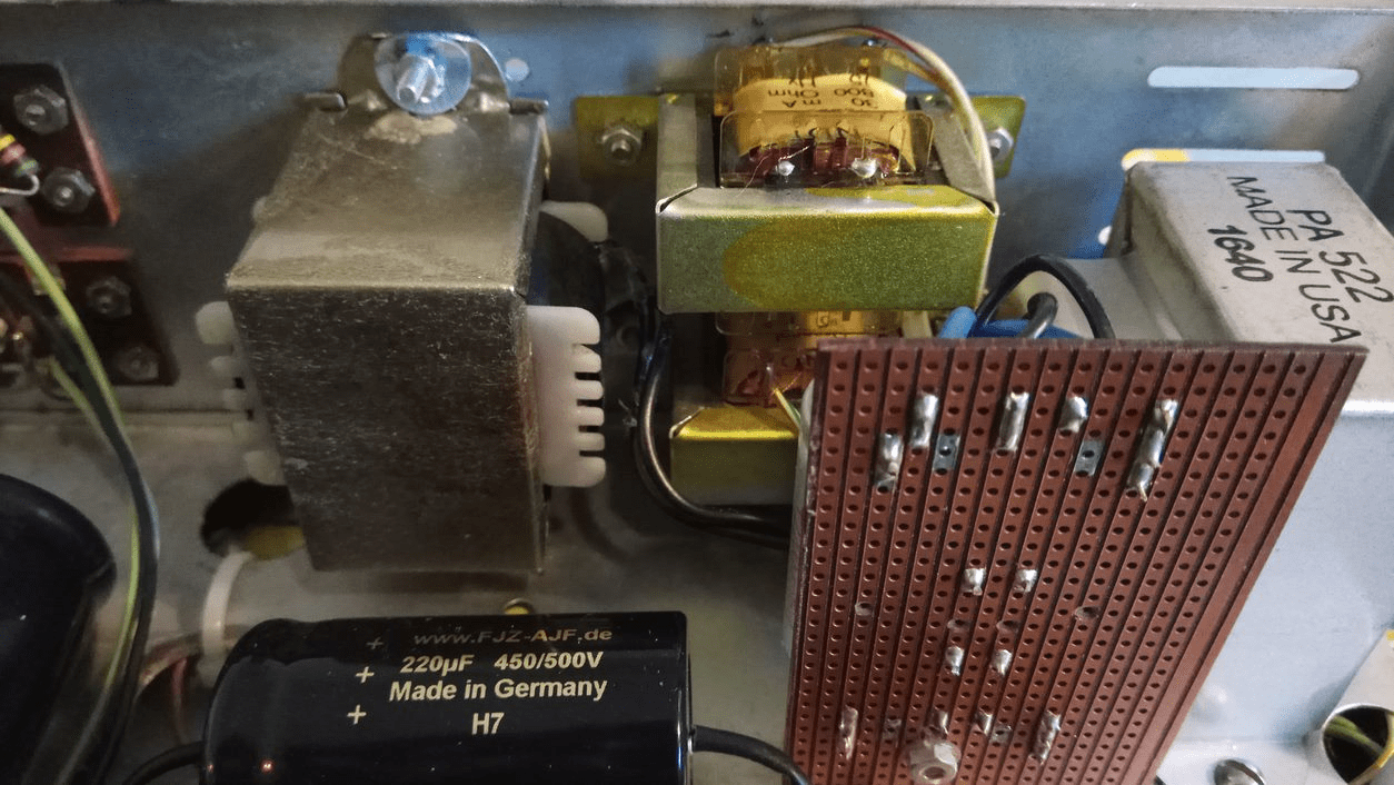

The pic below shows my heavily modded Dynaco PAS3 preamp. From right to left, the silvery thingy labelled "PA 522" is an aftermarket power trafo after the original one burned. The 2 yellowish ones are chokes made in Germany, their sizes are similar to the one the OP posted. I initially tried a choke input with one of those, and it buzzed, very loudly. Tried silent blocs, they didn't help. I finally bought the left most one, from China, and it's alright. The configuration is LC + 2 x (LC).
The moral of the story is: a LC topology is BRUTAL on the head choke: it has to comply with electrical rules such as critical inductance, and also mechanical ones, such as robust construction, and oversizing.
