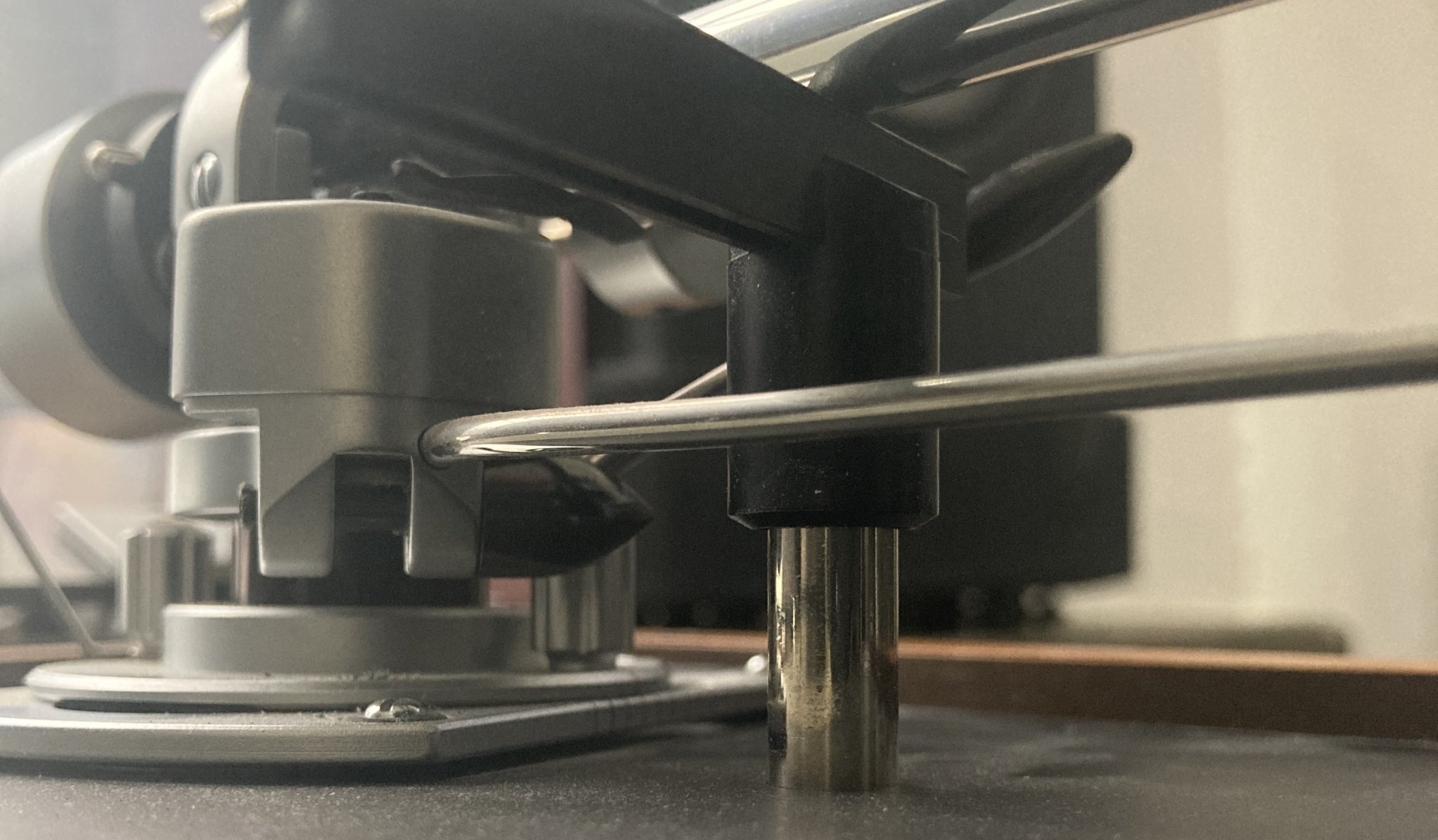

I would like to re-install the original tonearm-lift, which was replaced by thorens's front-"switch".
I have the lever and was able to insert it, but it seems something is missing:
The lever can be rotated 360° (there's no upper/bottom stop), and the tone-arm literally falls down, there's no "break".
Oh wow, this seems to be it!
I found another one BTW: https://audiokarma.org/forums/index.php?threads/sme-3009-series-2-cueing-dashpot-cleaning.916950/
Let’s see how far I‘ll come with it.
