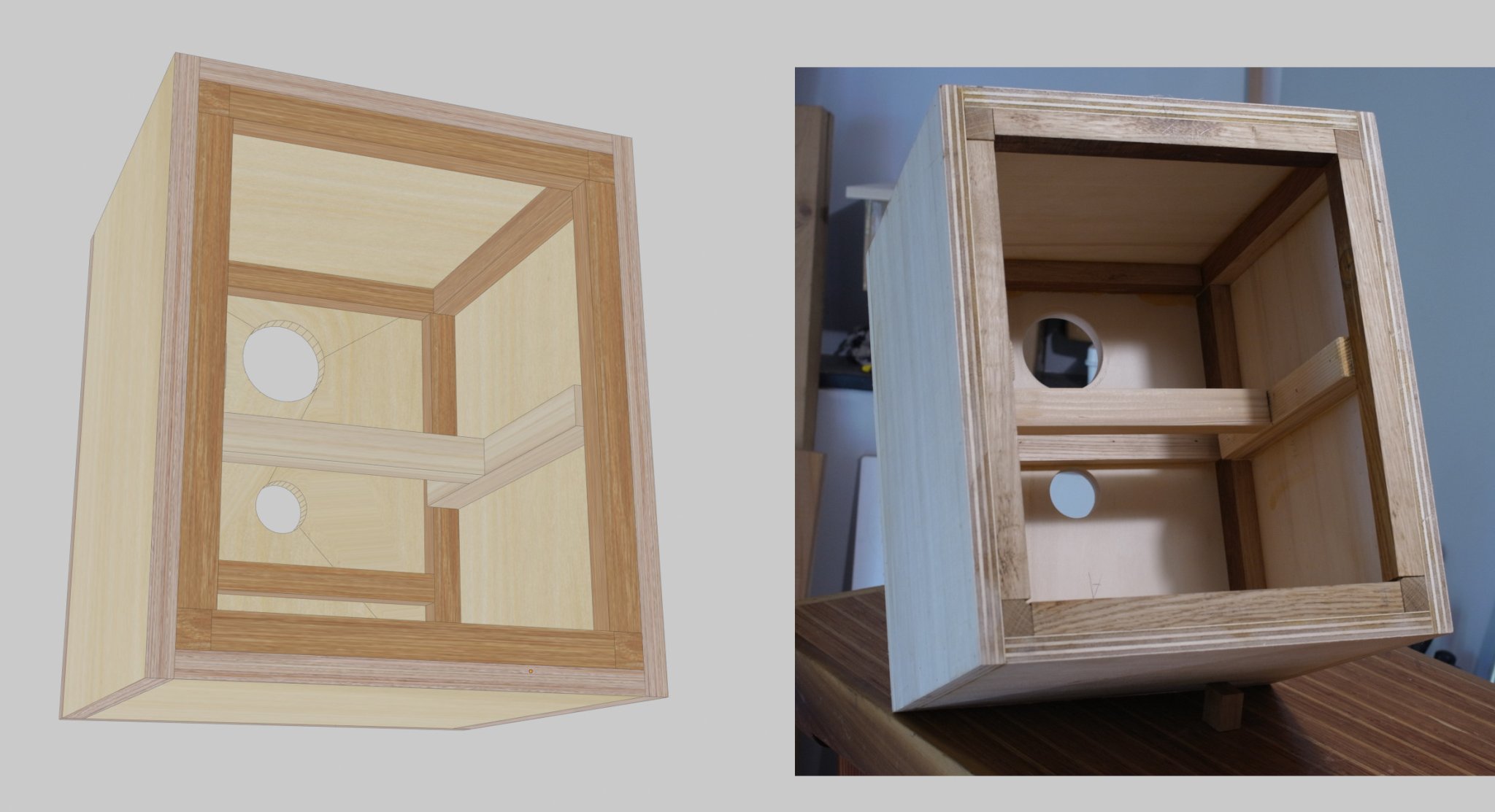

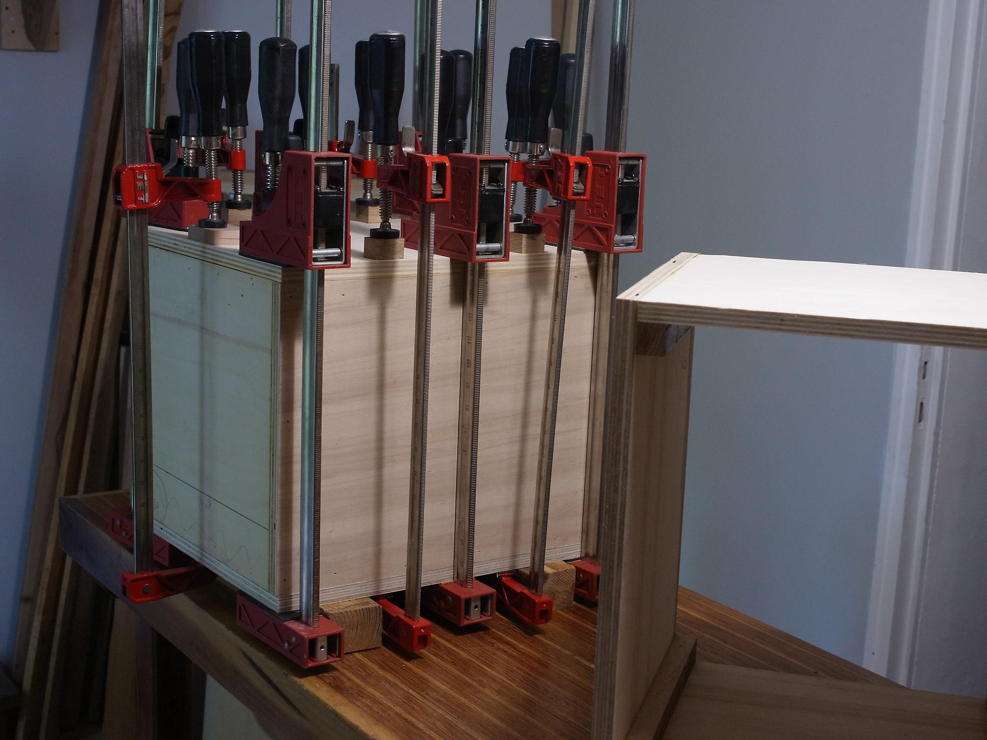

Gettin' there. I had a big pile of oak sticks lying around which I used all along the inside edges. Everything is glued, clamped, and nailed (brad nailer). The oak sticks already tame any resonances, and the inner brace should do the rest. I think whatever resonances are left are out of the frequency range that this subwoofer will play at anyway.
I will add some padding on the walls though, for good measure.
The protective grill I bought won't fit, too shallow 🙁 I guess it works only if the speaker is mounted from the inside. Maybe I'll find another good grid later.

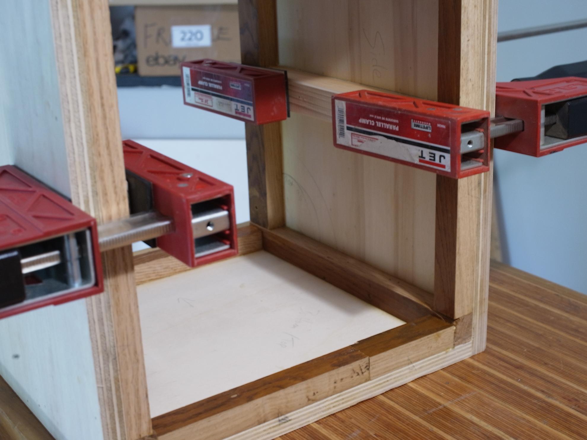

Some progress pictures:
Gotta know when to add what...
You can never have enough clamps.
Pretty close the the drawing 😉

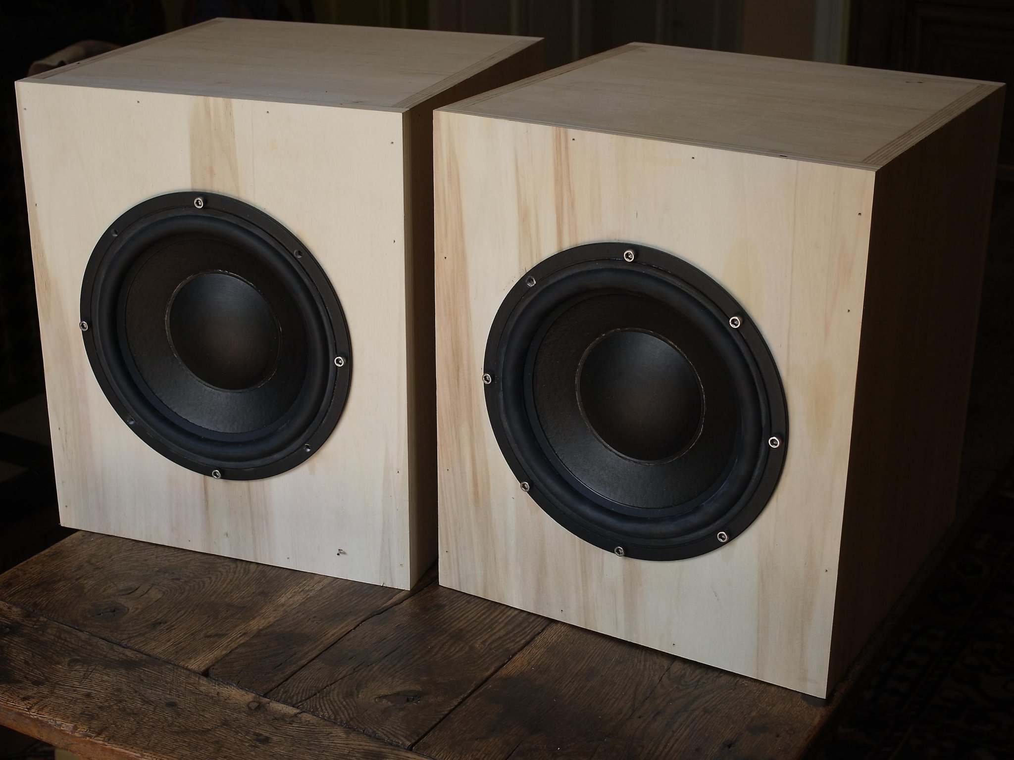

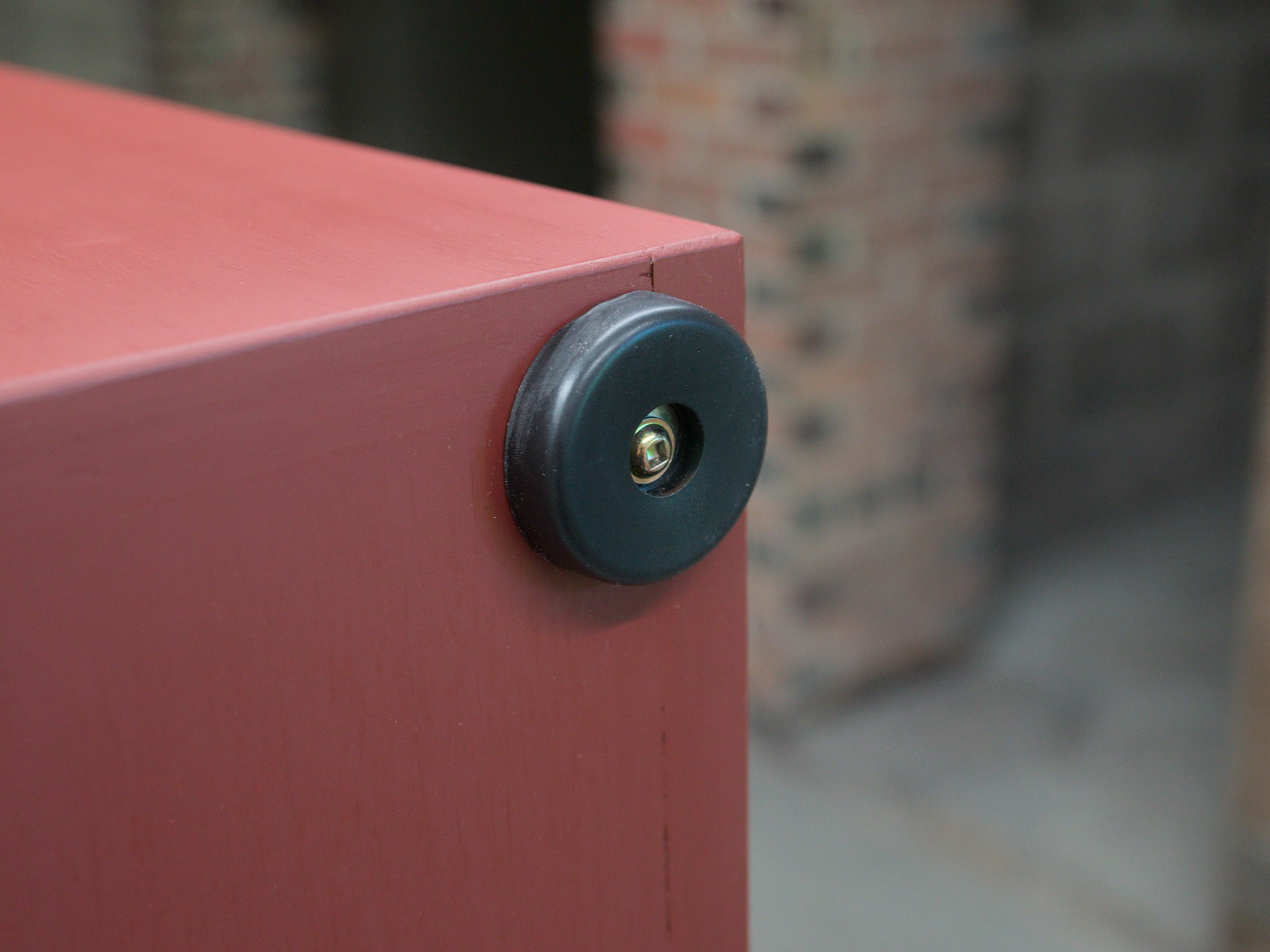

Done!

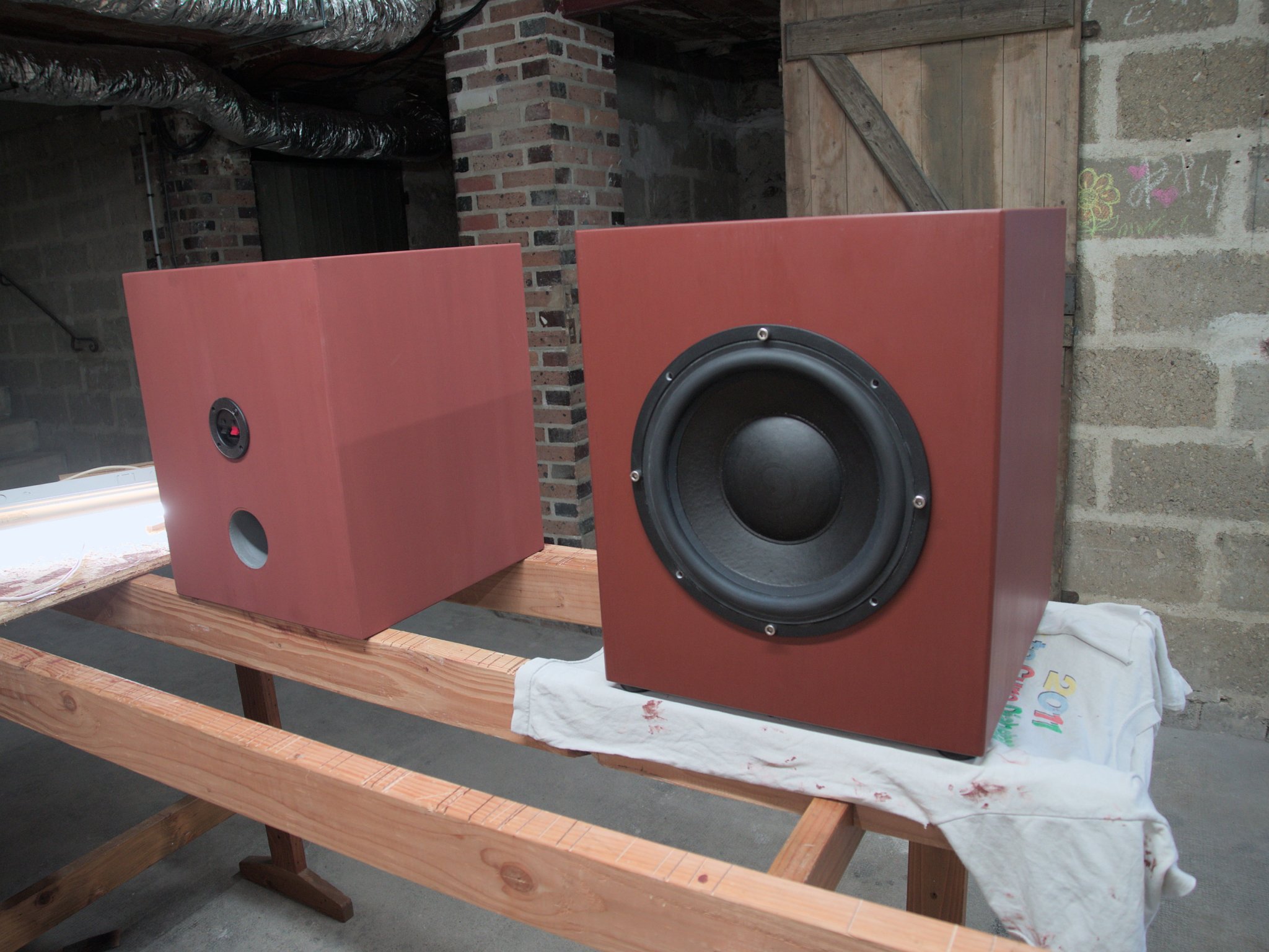

Painted them with Milk Paint in "Barn Red". Kind of a cool color, in my opinion 😉

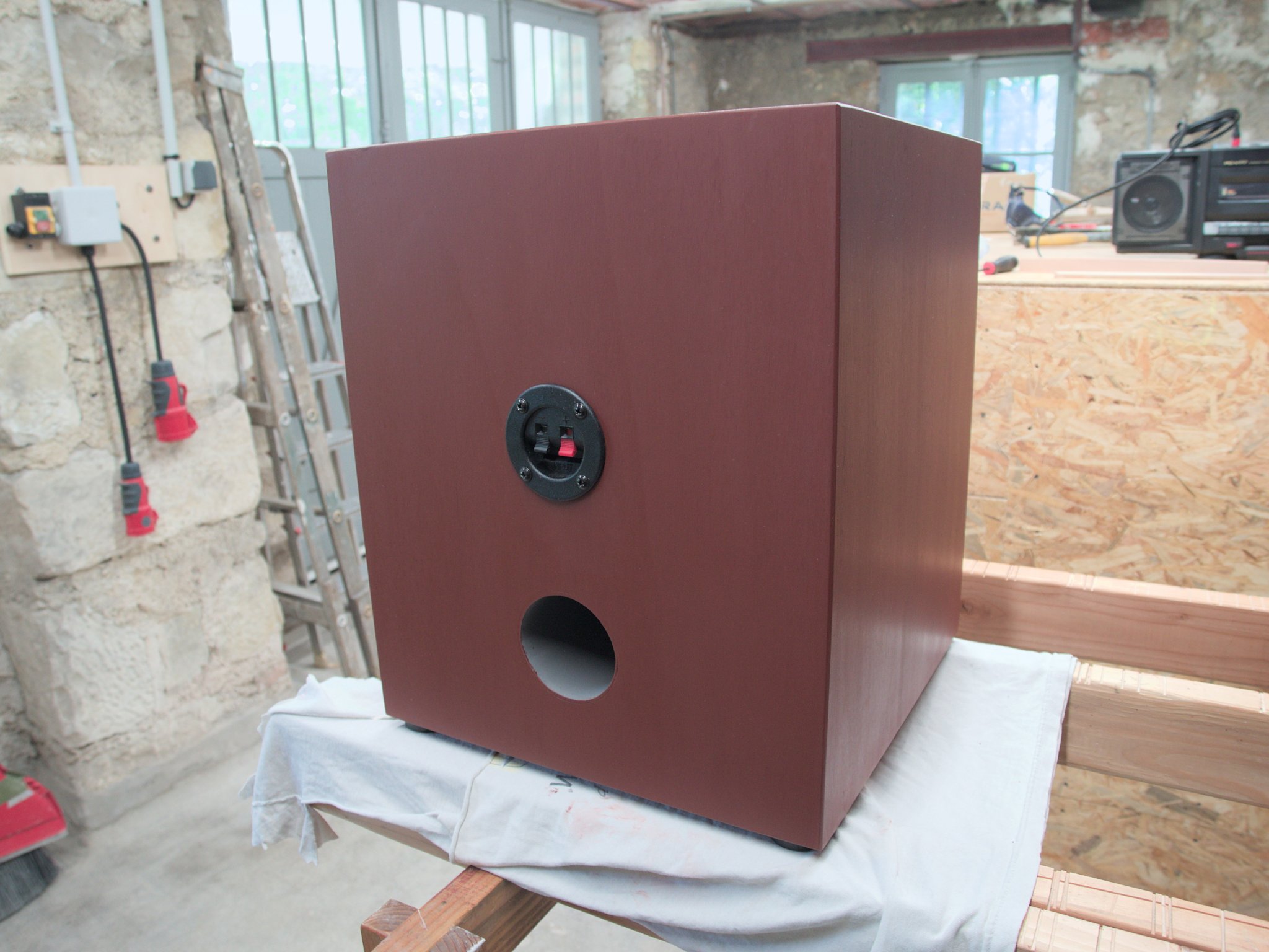

Added some simple terminals, that's good enough for me:
And some simple feet as well:

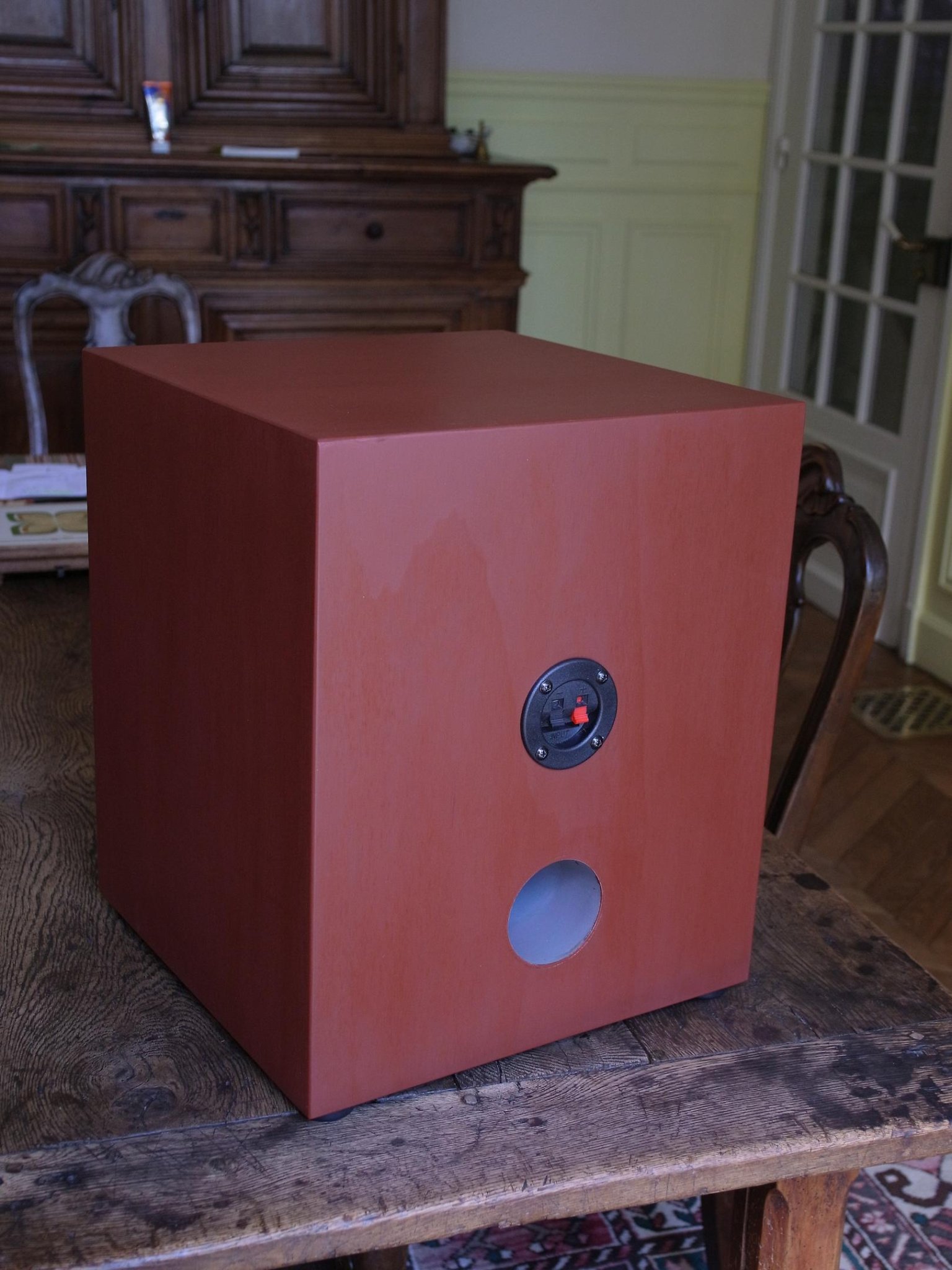

Applied Bees Wax after two coats of milk paint:
Next time I'll choose a black pipe... will look a bit neater.
