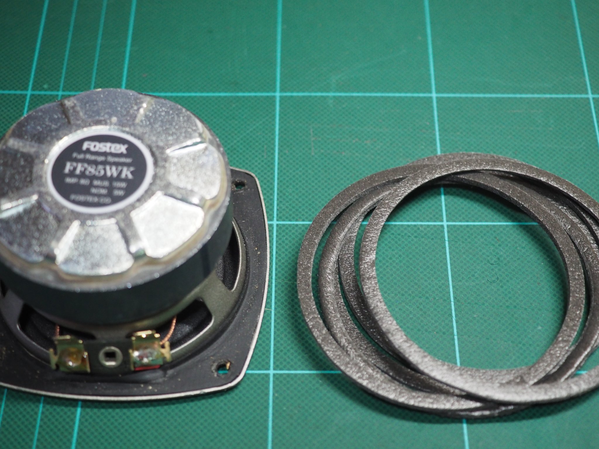

For small drivers, I've used craft foam sheets from the dollar store. They are approx. 2mm thick, and come in different colours.How do you do it? What’s your material? Rubber, foam rubber, putty?
jeff
Thanks for the link. I had a box of the thicker tape, I believe, once.
Perhaps very thin rope caulk would work, a few millimeters thick, if it exists. I’m looking for something smaller for a smaller driver. I’m thinking of gasketing drivers as small as CHN-40 & ScanSpeak 5F.
The very few new drivers i use that don’t come with foam gaskets i usually use closed cel foam insulation tape/darught exclusion tape. I also have a bunch of extra faom gasket material (MA often ship excess), i can make them out of.
dave
Pretty sure all the Mark Audio drivers come with gaskets, so not sure why you would need to make them?I’m thinking of gasketing drivers as small as CHN-40 & ScanSpeak 5F.
jeff
This past week I started printing gaskets using TPU material on the 3D printer. It really works well. I needed 40 gaskets for some 1" Aurasound Cougar drivers and this was an easy solution. I printed them 0.6 mm thick and using the ironing setting they look good. These needed to be just 2 mm wide in places, so foam tape wasn't an options. I found that a light wipe of olive oil on the print bed made these delicate parts easier to peal up. I have also had good results using poster putty. It will hold a driver in place and can be removed and reused.
