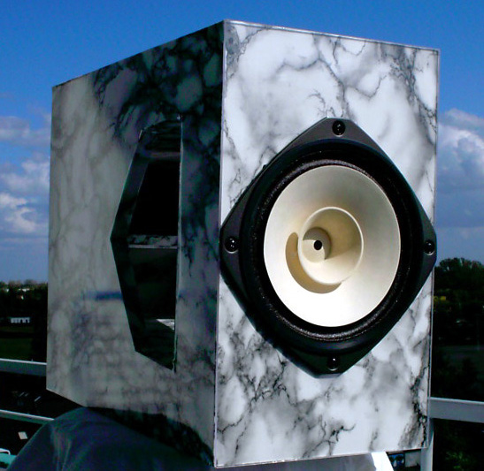

I haven't heard it but Horst's Trumpet-Sat looks like a nifty design (his picture is above, here is the web page):
Trumpet-Sat
However you'll need a woofer.
Trumpet-Sat
