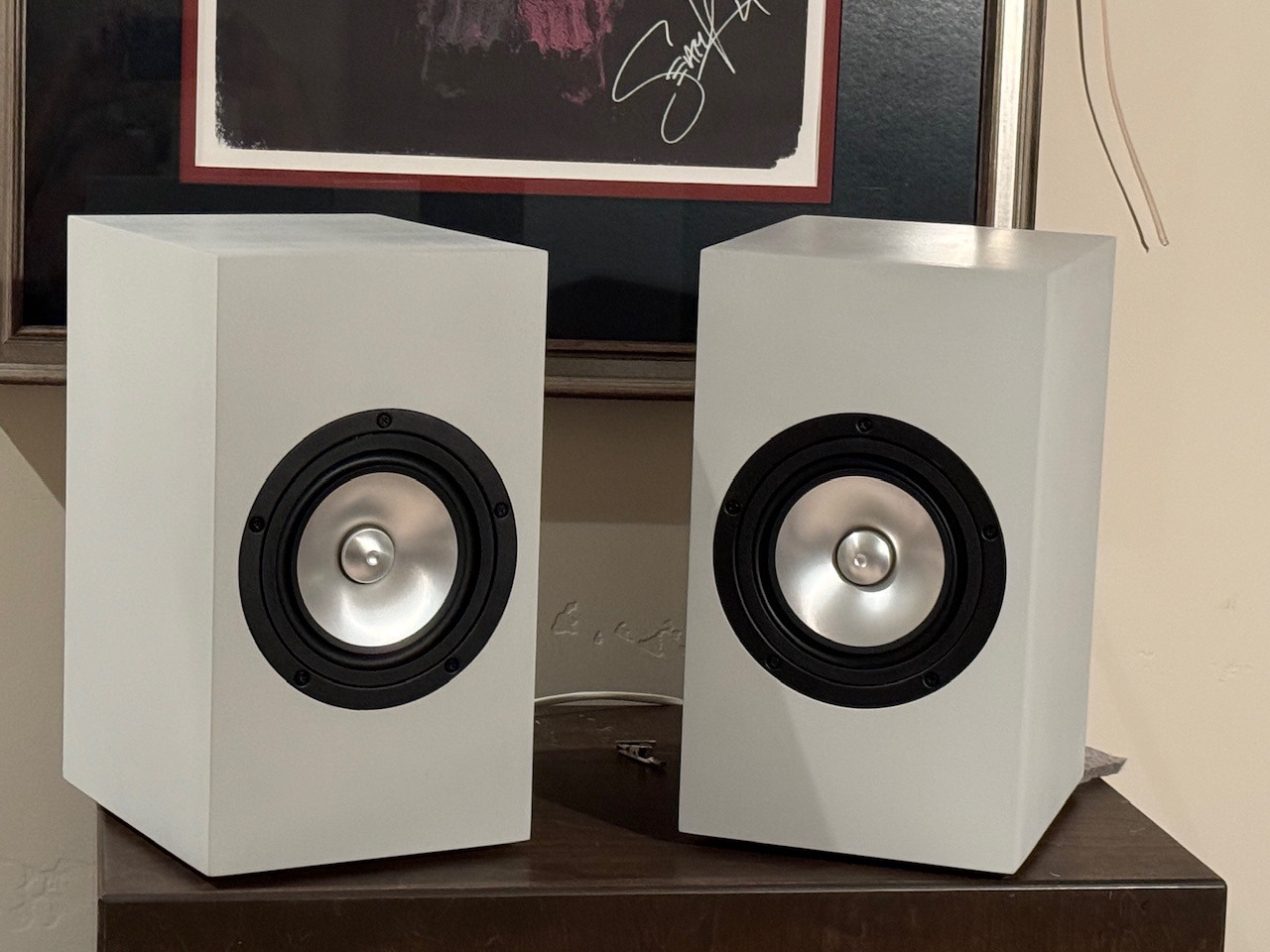

ordering SL11-SD enclosures. Trying to decide on a driver.
They can be ordered with the following Mark audio drivers.
CHN 110, Pulvia 11, MS11, MAOP11
Internal Cabinet Dimensions
Height: 310 mm
Width: 165 mm
Depth: 200 mm
Volume: 10.23 litres
Ported
Leaning towards CHN 110 but little concerned about the box size. Thoughts and recommendations appreciated.

They're part of a handful of simple kits I did for KJF Audio (I don't get anything out of this so no conflict of interest), which were designed to accept all of the current 5 3/4in MA drive units with minimal changes. The LF alignment & objective is different with each model of course as they have varying Vas values and levels of EM damping. The Vb stated above is slightly incorrect since it doesn't account for the varying amounts taken by the different drive units & venting.

Since that isn't very useful 😉 with CHN-110 installed, the alignment is roughly a well-damped Pi-Align with a slightly raised tuning to provide a touch more output in the octave above Fb which suits the driver's response characteristics & allows a stock vent to be used. Pluvia 11 has a slightly higher Fb & slightly flatter response (still mildly damped) around Fb since the driver has more EM damping & again, this suits its basic response characteristic. It wasn't designed for MAOP11, but it shares similar basic LF characteristics to the Pluvia 11 it's based on, so the same applies there. Alpair 11MS falls roughly between the two, again suiting its response character & EM damping. There isn't a 'best' because, particularly with unfiltered wideband drive units, a given fixed alignment on an LF graph doesn't really tell you much about the general balance of the speaker and what tends to work well for a given set of available dimensions. It's basically a mechanical / acoustic variation on the old 'smiley face' EQ curve. If you start out with a flat line & boost one end of the response, the speaker will usually sound unbalanced. Kick both extremes up, it will typically sound as though things have come back to neutral again. Technically they haven't as far as the bald FR is concerned, but that's how it's gererally perceived. This is over-simplified but you get the general idea. For what it's worth, I prefer CHN-110 and Alpair 11MS in this enclosure -the general balance of the drivers suits me, especially 11MS (albeit at a price). The Pluvia I tend to prefer in different sorts of loads. But that's just a reflection of my taste rather than anything functional: while you can easily hear the differences between the drivers & their alignments (as you'd expect / hope), they all work well, and for the price / size I suspect most people would be happy with any of the available options.
Love reading your replies! Always entertaining and enlightening—even for those of us with little subject matter knowledge. I ordered the boxes along with the CHN 110s. Be fun to explore Mark audios most budget friendly line. Dave often speaks highly of these drivers too. Maybe I’ll try the 11MS later.Strictly speaking, 'none, none and none'
Fun “quick” build! Not bass monsters—did not expect them to be. Still breaking in and sound lovely! Pair well with a subwoofer. Might try to sneak these into the living room with a small tube amp…see if the wife notices. 😜 Thanks Scott! @Scottmoose
