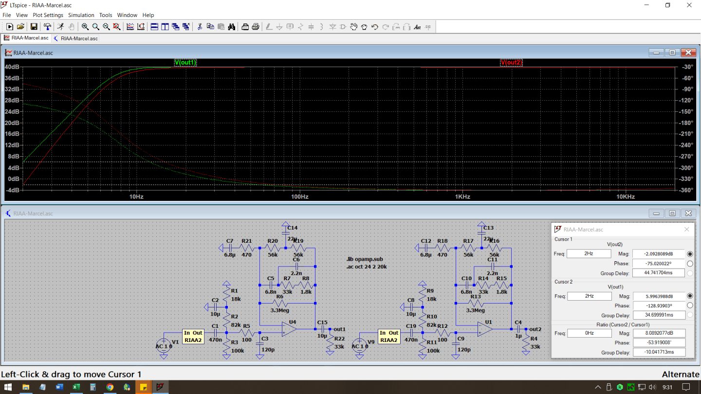

Why not use C3-R5 too to get a steeper slope? Provided that you have control over the impedance of the next stage, if e.g. with the shown R5=33k you make C3=1u, you get an extra 8dB attenuation @2Hz (see attached) while still keeping the 20-20k FR within the same +/- 0.13dB. Just an idea.
Cabirio
