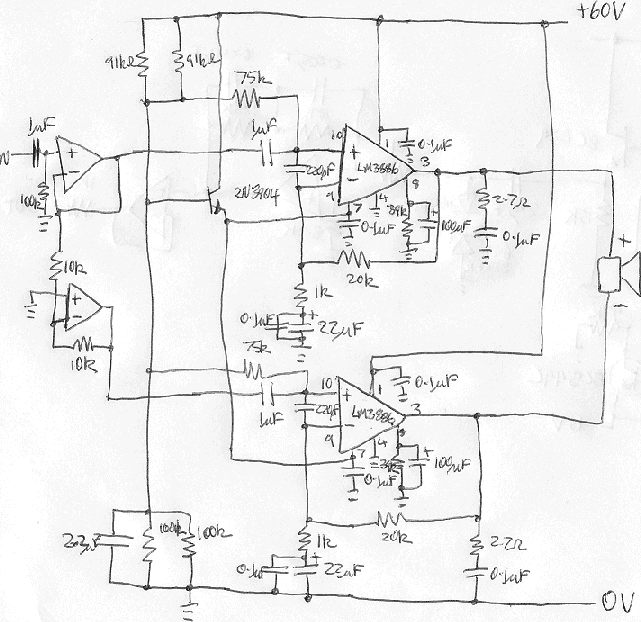

You could instead just run in bridge configuration - full wave rectify the ac, to get ~60VDC, then buy an extra pair of 3886s and run them in bridge configuration - that way, no need for the 338s or an output capacitor, and also no need for heaps of capacitance on the supply rail. Cost will probably be about the same - the 3886s are only a few dollars more than the 338s, but you will save this when you don't need to buy extra power supply capacitors for the output capacitors. Oops - someone has already said this.
On another note, using the 338s won't work here anyway - you need isolated transformer secondaries to achieve this. If you are thinking that you could just regulate the 60V to (say) ~25V and the other ~50V to get a ±25V supply, it won't work - current cannot flow from the 50V regulator into the 25V one (as required for a positive output) - current can only flow out of the 338s.
Chris.

I know it isn't the chipamp topic, but please post a link or a schematic of the lm3886 bridged configuration with single supply.
Look at the data sheet for the single supply application. Now, some components here you don't need: get rid of the big 4700uF output capacitor. You shouldn't need the parallel inductor/resistor combination at the output either. BUT you MUST keep the capacitor Ci (connecting the feedback loop to ground), otherwise the output won't be centred around mid supply rail.
You need two amplifier stages, and you want the output offset voltages to be pretty much the same. Thus it would be a good idea to reference each 3886 (of the one channel) to the same voltage, i.e. the voltage divider formed by the 91k and 100k resistor, the 0.1uF capacitor to ground, and the transistor. So, it would be a good idea to only build one of these voltage divider circuits to supply both 3886s. However, the increased current requirement means we should half all resistors - just put two 91k in parallel for the top and two 100k in parallel for the bottom. The capacitor is a little bit too small in value in my opinion. Increase it to 2.2uF. So now you can reference two 3886s to this voltage divider (sort of like a virtual ground if you will).
Now all that needs doing is to invert the input to one of the 3886s. Just use a dual opamp package, connect one as a voltage follower, connect its output to one of the 3886s. Connect up the other opamp as an inverter, connect its input to the voltage followers output, and its output to the other 3886. That should be it!
I will try drawing some schematics, give me a few minutes.
Chris.
Chris.
Ok, here's the schematic.
For the opamp you can use something like a TL072 should be fine. If you must, you can use something more exotic, but the values of some of the resistors around them will have to be changed if it isn't a FET device - i.e. the 100k input resistor should be smaller at say 33k, and the ground at the noninverting input of the lower opamp should be connected by a 5.1k to ground instead of directly to ground (to balance bias currents).
Also please note that the opamps will require a dedicated suppply of ±15V. This should be easy with all those extra windings on the transformer - just use a LM317 and LM337 to regulate the positive and negative rails respectively. The 'yellow' and 'black' windings look ideal for this (assuming I read correctly that the yellow output is ~20V).
The 2N3904 transistor could probably be substituted with another small signal type - eg a BC546, just be careful of voltage ratings (i.e. probably want Vce,max to be >60V - 546 has 80V max).
Also, before connecting a speaker to the outputs, make sure that the voltage between them is less than around 0.1V.
I know that the diagram is a bit messy and that some of the diagram from the other side of the sheet has scanned through, so if you can't see what I have drawn, please ask!
My god that file size limit is annoying - I'm actually just under the limit and it still won't work!
Finally got it.
Chris.
Finally got it.
Chris.
