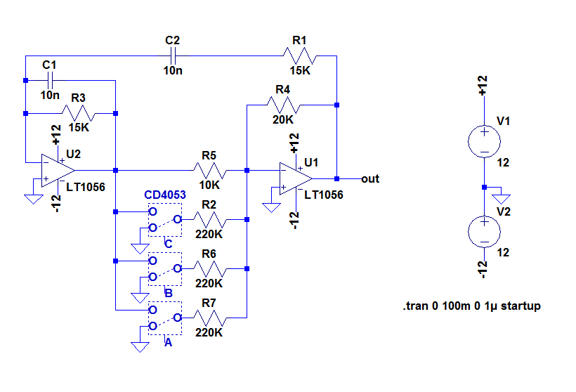

I am going to illustrate that point, based on the classic jFET VCR example:
First is the classical implementation, with all its known issues.
This basic circuit can be improved by using a more clever summing scheme, to improve the accuracy and speed of response: SOTA.
Both the previous circuits suffer from a residual non-linearity and limited dynamic range.
It would be interesting to find a corrector network, to lower the distortion and improve the dynamic.
Only the last circuit would qualify, because it brings something new.

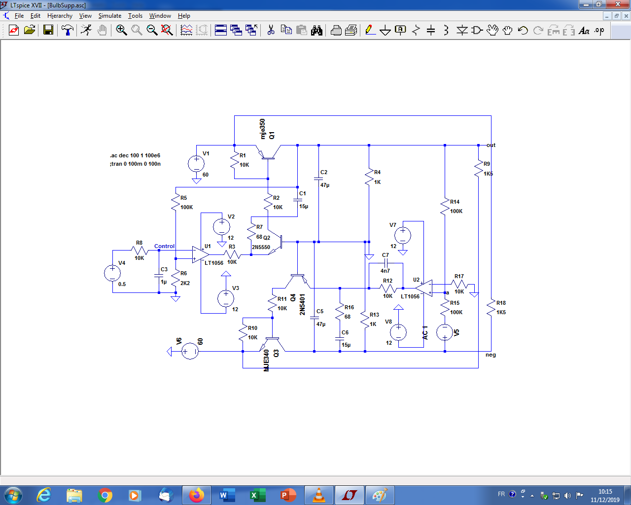

I am going to prime the discussion by presenting a gain control based on lambda/Early effect.
The Early effect, and its FET counterpart, the channel modulation are non-linear effects.
They are generally seen as a problem, because they increase the THD of amplifiers, but would it be possible to take advantage of them to create novel types of VCA's?
The answer is (apparently) yes. This drawing illustrates the principle:
The output resistance of the transistor can be modulated by the collector current or the Vce.
The dependence on the Vce is what causes the non-linearity in amplifiers, but Ic provides a convenient, direct means of controlling the resistance.
Of course, using a single transistor would be somewhat impractical.
A push-pull configuration seems ideal, since it neatly solves DC issues etc:
Now that there are two active elements, the Vce term disappears, meaning the synthetic resistor becomes linear (assuming the Early law is cast in bronze, which is not exactly the case unfortunately).
Things are not that simple though, mainly because complementary transistors are a fiction that doesn't hold in reality (in silicon at least).
Parameters differ widely, and Vaf (Early voltage) is heavily affected: PNP's have a much lower Vaf than NPN's.
The solution is to go all PNP:
This is a first, half-practical example. I will examine later its shortcomings, and possible remedies.
I will also introduce a figure of merit, to evaluate more objectively the various alternatives.

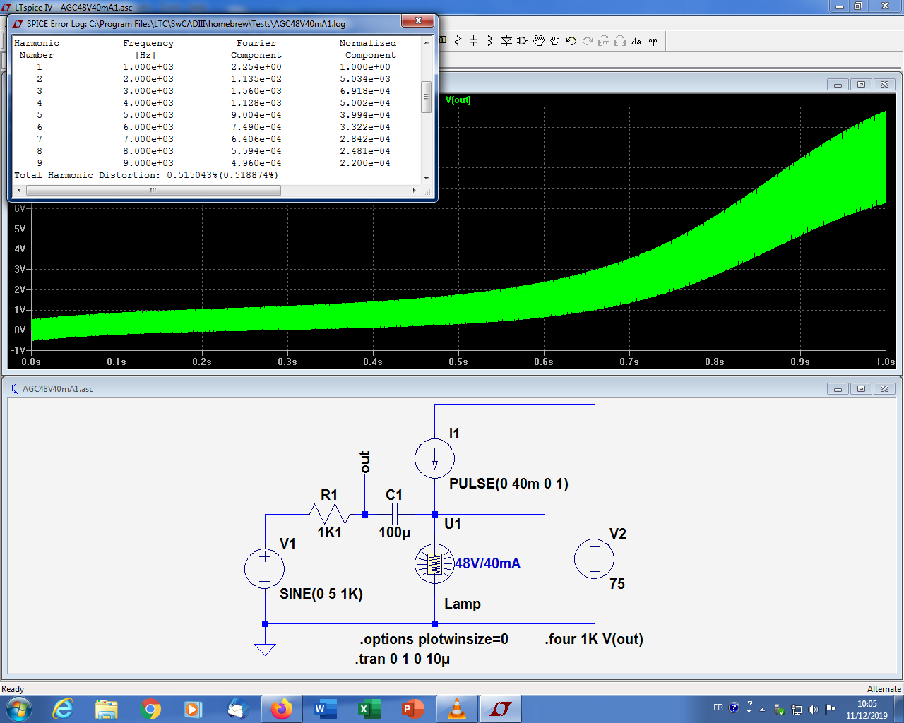

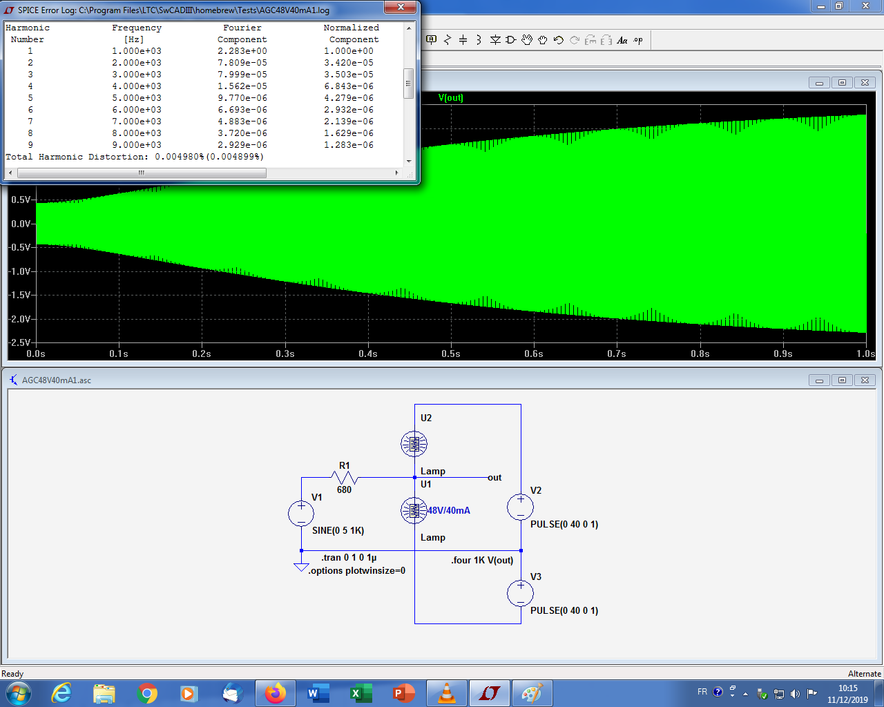

The simulation shows an amplitude sweep, from 6Vpp to ~0.6Vpp

The THD is not bad either: depending on the attenuation, it is comprised between 0.012 and 0.07% (real, measured), and it is certainly perfectible.
This is of course much too high to be used directly in a low-THD oscillator, but the amplitude-controlled signal will be diluted in the much larger direct, uncontrolled path: depending on the component accuracy and other parameters, the dilution factor could be 1:100 or 1:1000, or even more.

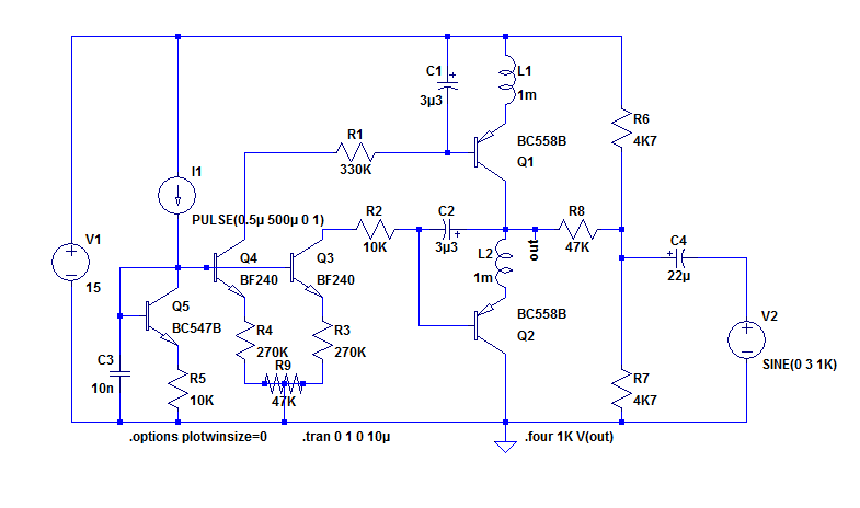

This is the actual circuit (used for the measurements):

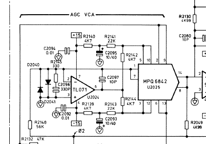

How do you compensate different gain in the output stage? Bottom is a follower, top is an amplifier.
how much of this is implemented if any in either analog multipliers or the chips like the SSM: https://www.analog.com/media/en/technical-documentation/obsolete-data-sheets/165661290SSM2122.pdf or its "improved" http://www.soundsemiconductor.com/downloads/ssi2164datasheet.pdf . The benefit of monolithic design is matching to a degree that can be difficult with discrete parts. They claim .05% THD at unity gain and 1 V out. The .05% would be attenuated by the mix ratio and necessary gain control range for the oscillator itself.

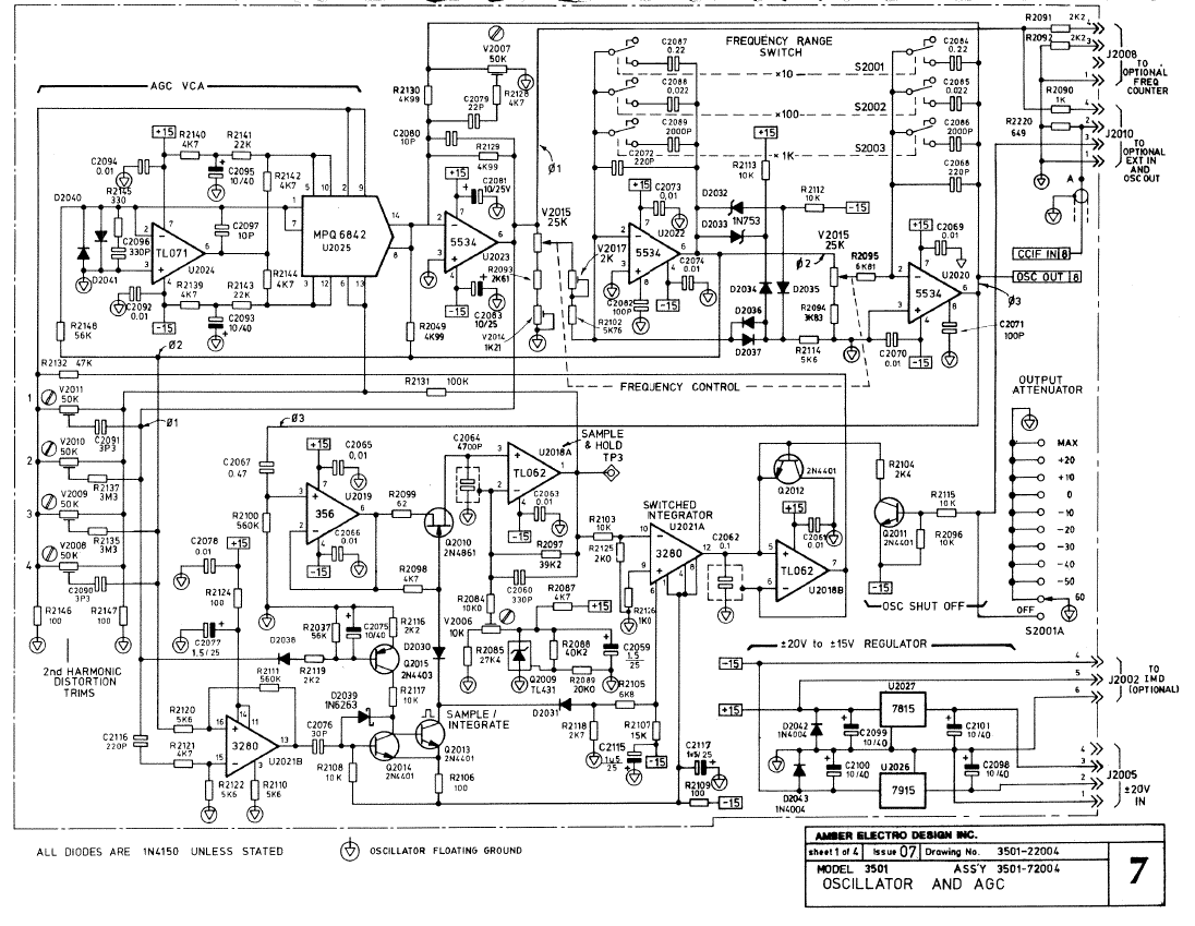

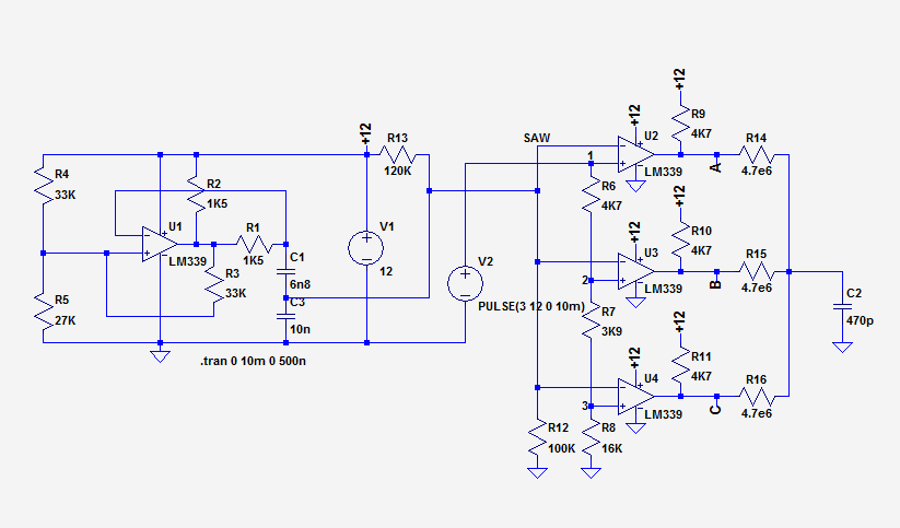

If you are looking for novel solutions there is the one suggested by Davida, using a SAR ADC to sample the wave at its peak and then use a multiplying DAC for AGC. The combination could be enhanced with a micro in the middle to very quickly stabilize the amplitude very precisely. The multiplying DAC can be very low distortion and it would only be steering the signal, not passing all of it. Add two more multiplying DACs for frequency tuning for a very clean solution.

get one of Victor's anyway. There is so much technique involved at these low distortions his oscillators are a real value. similar types of hand adjusted products (precision dividers, thermal converters) cost thousands. it will still be useful when Elvee gets through his efforts here.
You are probably not interpreting correctly the circuit: there are no followers and amplifiers.How do you compensate different gain in the output stage? Bottom is a follower, top is an amplifier.
Q1 and Q2 act as current-controlled variable resistors, and the signal source is V2, coupled through C4 and R8 which forms the upper part of a voltage divider.
Analog multipliers generally operate on translinear principles, either explicitly or implicitly.how much of this is implemented if any in either analog multipliers or the chips like the SSM: https://www.analog.com/media/en/technical-documentation/obsolete-data-sheets/165661290SSM2122.pdf or its "improved" http://www.soundsemiconductor.com/downloads/ssi2164datasheet.pdf . The benefit of monolithic design is matching to a degree that can be difficult with discrete parts. They claim .05% THD at unity gain and 1 V out. The .05% would be attenuated by the mix ratio and necessary gain control range for the oscillator itself.
This works differently, and even with a crude discrete + breadboard implementation it achieves 0.012% (~4x times better) for unity gain and 6V output (it could be 10V or more with identical performance)

Some explanation about the circuit in #2: L1/C1 and L2/C2 combat the noise: the capacitors provide a low impedance shunt path for the input noise in the frequency range of interest, and the inductors degenerate the transistors at frequencies higher than the useful frequency range, but this is far from ideal: it is obviously frequency-specific, which could be OK if you build a single frequency oscillator but is problematic if you need to cover the audio-range.
There is another problem: the capacitors impose a significant response time, which is problematic if this block has to be included in a servo loop.

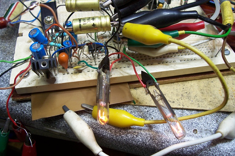

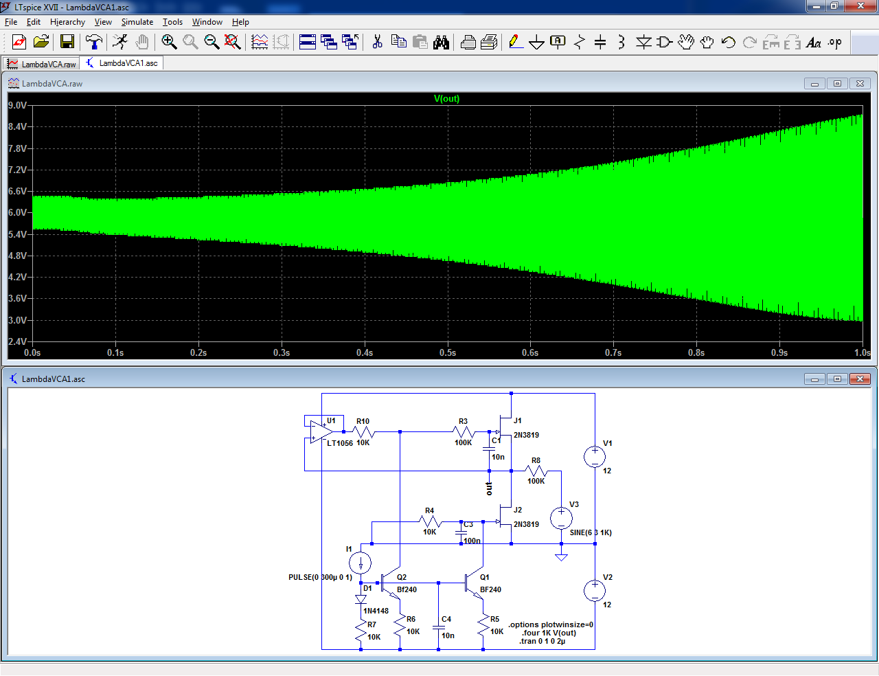

It is possible to use a similar junction modulation effect with jFET transistors: it becomes the lambda-VCA:
In the real-world prototype, I used a U405 dual JFET rather than two matched 2N3819 (this would be tedious considering the huge dispersion of FETs) and the opamp is 1/2 LF353.
This incarnation is somewhat more attractive than its bipolar counterpart: it does not suffer the same kind of noise problem, the time-constants are under control, and the THD remains practically flat for the whole amplitude range at ~0.018% average.

The figure of merit for the bipolar version is 120.
The THD surges to 0.045% just below the max level, at 4.5Vpp.
It is probably caused by an imperfect matching of the BF240 driver transistors: at very low currents, the dynamic BE resistance dominates.
At higher currents, the emitter resistors and trimmer dominate, meaning the balance is perfect.
At the maximum amplitude of 6V, there is a residual distortion of 0.012%, certainly caused by the varicap effect of the various junctions.
It is why I changed the BC547 for BF240, because they have a lower absolute capacitance.
For the FET variant, the figure of merit is 333: the distortion at 6Vpp is relatively large, 0.018%, and it is certainly caused also by varicap effect.
The series resistor is 100K, explaining the larger figure.
With FETs having a larger lambda, the series resistor could be reduced, but such FETs would probably have larger capacitances too, because many parameters are correlated.
I just ran across this interesting AGC block for an oscillator in the Amber 3501 I'm about to calibrate. The MPQ6842 is a quad complimentary transistor (probably long obsolete). It would be interesting to copy the circuit into spice and see how it works. The associated oscillator is pretty good, in the .001% range I believe normally. This unit is quite long due for calibration so its not representative.
Thanks, that's certainly unusual and interesting.
Could you show a little more of the context, to see how 2,9 and 6,13 are controlled?
Here is the whole oscillator. Its a good implementation. The H2 null uses an H2 derived partly from the AGC itself and feeds back a proportion on the DC gain signal to null the second harmonic. Getting this right turns out to be not real easy.
The S&H for level is interesting. The actual AGC is done with an optocoupler. The optocoupler can work well but is slow and has a significant voltage coefficient.
Thanks. I will need to redraw the circuit with explicit transistors to understand how the gain cell core actually worksHere is the whole oscillator.

I have revisited an old classic: the light bulb.
Historically, it was the first control device of early oscillators.
It has the advantage of combining the amplitude acquisition, loop filtering and gain control in a single cheap.
For me however, its main disadvantage is the combined amplitude acquisition, loop filtering and gain control: you cannot design a system with arbitrary characteristics, you can at most change the lamp, but that's limited and that's about it.
I am only interested in methods allowing a complete control of each aspect, and this rules out the classic lamp and thermistor.
However, it is possible to use a lamp with an external control: it can be controlled with a DC current:
Such a simple implementation has a number of drawbacks: a variable DC voltage is now mixed to the signal, and the bulb generates a fair amount of H2, because of the asymmetrical operation of the circuit.
Arranging two bulbs in a bridge configuration kills two birds with one stone: it eliminates the DC issue, and the operation becomes symmetrical, eliminating most of the distortion:
I have built a specialized supply to test the principle in reality:
It is overcomplicated and suboptimal in many ways but it does the job.
I needed to add bleeder resistors R9 and R18, because without them the regulators lost the regulation when the control was too low, due to the AC signal exceeding the DC output current (I used a very high drive signal, to be able to see some distortion).
All of this could be improved and rationalized in a real build.
This is the test circuit:
With an input signal sufficient to get 10Vpp output at the minimum attenuation, the THD was flat at 0.0015% between 10 and 4Vpp (the minimum).
The minimum is relatively large, because the signal is sufficient to cause a significant self-heating.
The 0.0015% could be lower in reality, because my THD meter is not in top shape, and that is in fact its own measurement floor.
Note that lamps were not even properly matched: some DC voltage was present in the output.

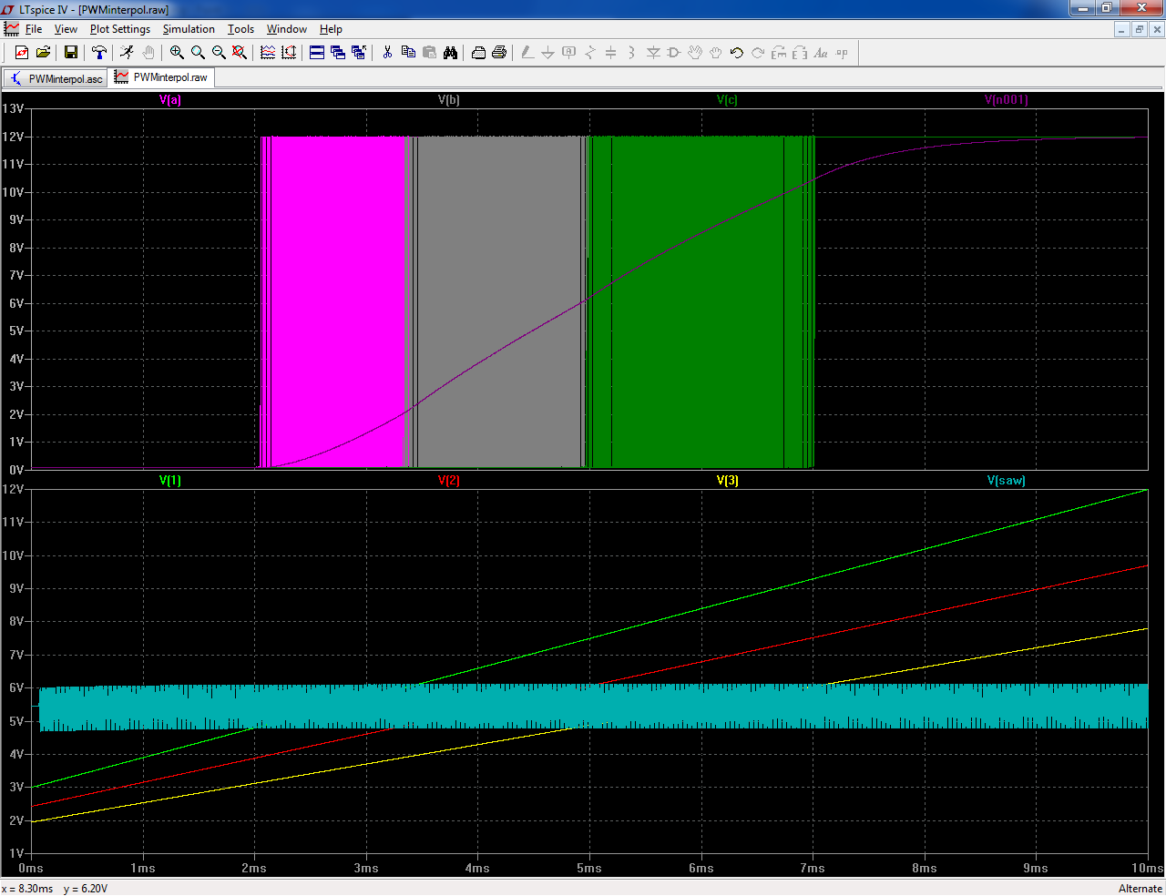

PWM control
Here is another scheme I tested:
The idea is to use a PWM control to vary the gain. If the carrier frequency is high enough compared to the oscillator frequency, the carrier residue will be attenuated naturally by the Wien (or other) network.
I have used a carrier of 100kHz for the evaluation, but in reality the frequency would be higher.
This is how it could be added to an oscillator (there are other possible options):
Here, two methods are combined to improve the granularity/dynamic range: first, a coarse, "bargraph" D/A converter adding the 220K resistors to the gain as needed, and an interpolator based on PWM to ensure a smooth transition between the discrete steps.
The modulator could look like this:
A ~sawtooth generated by the oscillator on the left is compared to various scaled versions of the amplitude-control signal (V2).
The role of R14, 15, 16 and C2 is just to visualize the combined effect of the three PWM outputs.
Here are the waveforms (n001 is the synthetic output on C2):
This control scheme has the advantage of introducing no THD: the resistance of the CD4053 is negligible compared to the 220K of the resistors.
It does introduce non-harmonic residues, but they can be filtered, implicitly or explicitly.
It might also be possible to generate a signal in antiphase with the PWM, but having no LF content, to cancel the residues
