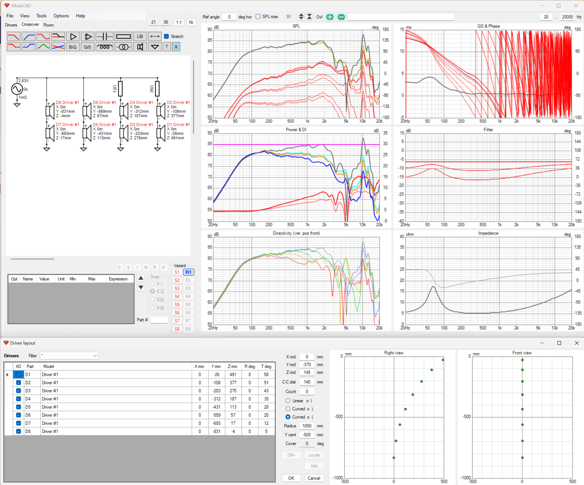

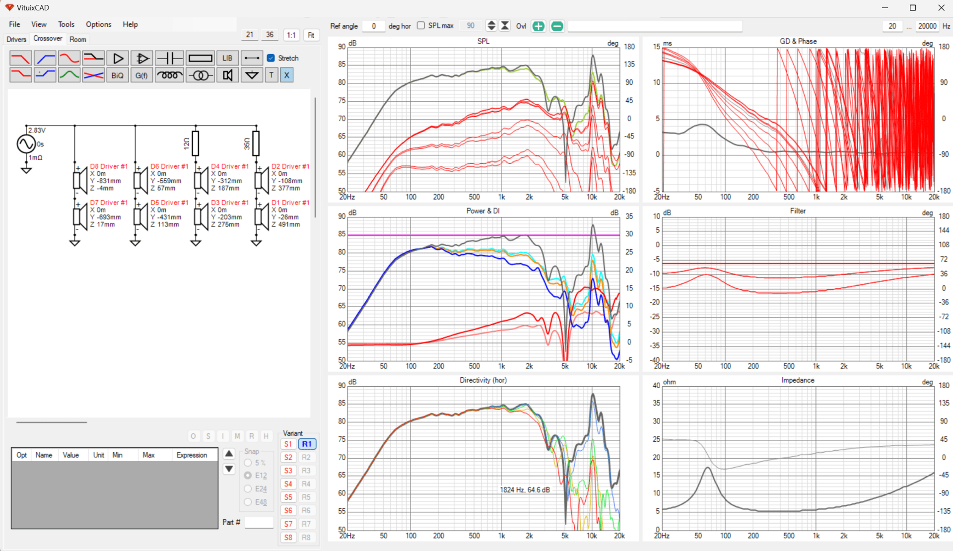

Here are sims of the vertical and horizontal response, and includes the layout of the midbasses in the array.
This is simmed with the microphone three feet off of the floor, or about where our ears are.
This sim includes directivity and baffle step, as generated using the VituixCad diffraction calculator.
It's interesting to note how low the efficiency is below 300Hz. Something I don't like about the arrays I've heard at places like Guitar Center is that they sound very 'thin.' I'd long assumed this had something to do with the tall/skinny shape of the cabinet. While that IS true, it looks like what these long skinny arrays need is a bunch of EQ to bring up the low end to match the lower midbass and midrange. Basically, those Guitar Center arrays would probably sound better with some EQ.
When I say "Guitar Center Array", I'm talking about all the prosumer line array stuff you see for sale in their pro audio departments, which are largely very tall/narrow arrays such as the ones from JBL and Bose.
Also note that the entire passive network consists of just two resistors. (For now. I intend to add a tweeter.)

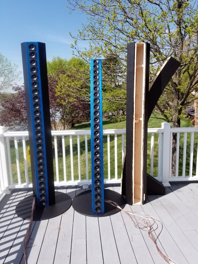

I've done that with a straight-line and CBT both built with the same set of 24 3" drivers. The drivers were mounted on a removable baffle, that fit into either the straight box or the CBT box.
Drivers were wired in 6 groups of 4 drivers. With 6 amp channels. Both magnitude and delays could be set very finely.
But that limited the ability to do magnitude shading for the CBT, to 4 drivers per group, rather than 24 discrete channels as would be ideal.
By the same token, when trying to mimic the CBT with the straight-line, both magnitude shading and delays had to be set 4 drivers to a setting.
The straight-line did a pretty good job replicating the CBT, but not quite.
First thing I noticed listening to just one of each, was the CBT's apparent acoustic center (using ears) stayed at a pretty constant height on the speaker with varying listening distance. The straight-line CBT mimic center moved up and down the line more with listening distance.
In stereo, the CBTs held better imaging with different room placements. Maybe better tonal consistency too....but i would need to go back and check notes on that one.
I guess for a really valid test, 24 discrete channels would be needed. But i felt i learned enough from just 6 to skip that complexity....
