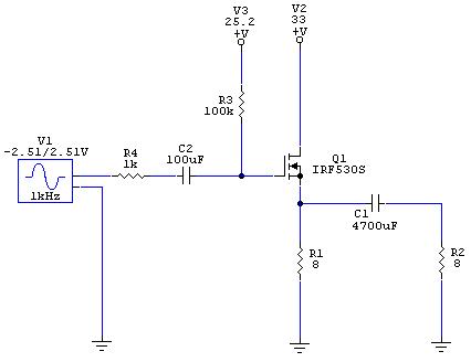

simple MOSFET source folower suggest me please
I found this schem in internet
http://home.zonnet.nl/tschrama/owndesign.html
can anybody suggest ?
how can I build power supply?
or more
I'm a newbie
some parameter
generator: 1K Ohm amperes: 2.618 Amp
device: IRF530S power@1%2/3rd: 7.558 Watt
z-Bias: 100K Ohm dissipation: 86.39 Watt
Bias Voltage: 25.2 Volt rendement: 8.749 %
z-source: 8 Ohm gain: 0.908 x
output capacitor: 4700uF Z-out: 0.2588 Ohm
supply: 33 Volt -dB @ 10 Hz: -0.6614 dB
z-speaker: 8 Ohm -dB @ 100 kHz: -0.0323 dB
rimple rejection: 0.648 %
THD@0.33Watt THD@1Watt THD@3Watt
0.125 % 2nd 0.223 % 2nd 0.432 % 2nd
0.006 % 3rd 0.022 % 3rd 0.079 % 3rd

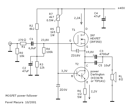

Hi aiwonsi,
yes, you can use lower voltage for lower power. In that case you have to maintain at Gate of T1 voltage Vs/2 + 4V. That means that for supply voltage of 24V you need 16V at gate of T1. This can be done by changing of R3 value. The circuit as shown (mosfet power follower) is not much sensitive to supply voltage ripple. The supply ripple rejection is about 60 dB, standard bridge and cap supply can be used. You will find one on my web page, same address as shown above. Fig.5. In case of more questions you can send me an e-mail.
Pavel

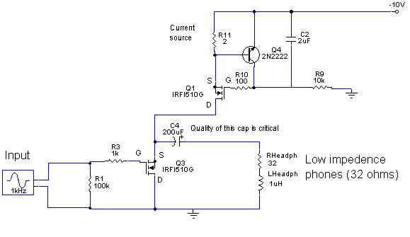

The Mosfet source follower should be built with a current source bias. An N channel mosfet will provide a lower ouput impedance and the speaker load should be in parrallel with the follower as in this circuit. I have used the IRF150 and IRF250 with great results. You need a huge heatsink.
The http://home.zonnet.nl/tschrama/owndesign.html
link doesn't work for me so I can't tell what the circuit under disscusion there iis. For a single ended mosfet follower like the rest of the circuits under disscussion there is no crossover distortion because there is no cross over between P and N channel devices.

Hi aiwonsi,
I made that website.....:bawling: .. a long long .. very long time ago .. :att'n: ... At the time I was just beginning to understand electronics and was playing around with a Spice simulator.. I was just trying to see how a simple source-follower would perform.. There where no intensions at all to build it , just to show the performance as calculate by the spice simulator.. To make a real working amplifier out of it I suggest reading the ZEN articles and the www.tubecad.com ... then you'll learn enough to build a simple amplfier/power follower.. The current design needs a rimple free bias supply, a gate-snooper resistor, don't forget the terrible efficientcy of less than 10%... The Boys on the forum here have given you good advice.......read on 🙂
Please people.. it does not reflect my current state of understanding audio electronics :clown: .. please save some tiny respect for me.. at least I had the nerve to admit I was the auteur.. I will take the website offline as soon as I remeber how I should do that.. .. reading the website I really don't know what I was thinking ... I think I had too much wine...
Thijs
