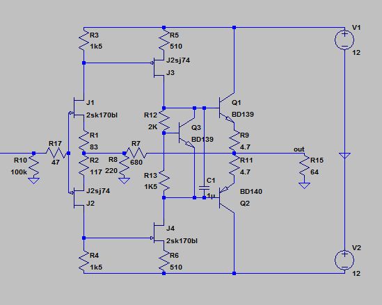

You can certainly do something with those parts. For something a bit different, look at Figure 3.17 in Douglas Self's Small Signal Audio Design book. If you don't have it available, it's essentially a differential pair with an emitter follower as the output stage which is driven by the inverting output of the diff pair.
Your J74 FETs might work as the output stage similar to this:

Honnestly... I think this kind of amp would be a better use of those jfet : The α20 Line Stage Amplifier (no need to order a pcb, use it as inspiration). More current output, some gain if you need it
Getting the extra parts (a few transistors and a pair of trimmers) would cost you next to nothing from reichelt, you already have the most expensive parts. You can use it on a +/-12v supply made with 7812/7912.
Well, you could replace the VAS transistors by more sk170, sj74, depending on the idss you've got (do you have complementary matched pairs ?).
You really need to get PNP transistors though to get decent current without an output cap. If you go on ebay.de, you can easily get 10bd139-bd140 pairs for 5€. That will allow you to build a much better amp.
Here is the general idea (R1-R2 is a 200r trimmer to set the output offset due to mismatch in jfet, r13 a 2K trimmer to set the output current, R5-R6 set the current in the VAS and have to be adjusted according to the idss of your jfet, the more the better, R7-R8 set the gain):
If you insist on using your parts... just make a kind of darlington with 1 2SK170 and 1 bd135and stick it on a 100maq ccs made with another bd135. You'll have no gain and you'll need an output cap. No need for input cap if you use a +/-12v supply.
PS: there might be a virtue with output caps in discrete design. No risk to get murdering offset at the output if your parts aren't well matched enough or trimmers go bad.
