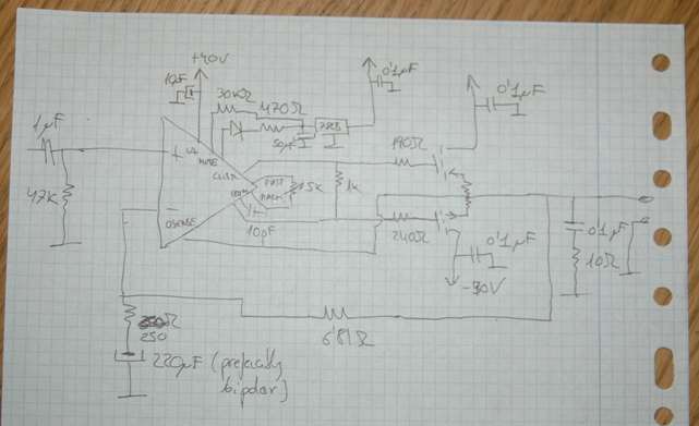

I'm at the university right now so i can't post any schematic. I will tell you hopw i did mine this evening (Evening in spain 😀).
What i've to write is exactly a part list since i need to do a second channel amplifier for my bedroom one and i must buy identical parts to get good stereo matching.
Sorry guys but i have NO time! i've drawn this in 2 minutes. I hope that it hasn't any mistakes and that it works for you.
The upper fet is the 2SK1058 and the lower is the 2SJ162. Voltage can be increased to +/- 50V as stated in AN-1645.
The V- connection of the LME49810 is missing. It goes to -40V bypassed with 10uF like V+. The LME49810 ground is also missing, of course it's connected to ground!
EDIT: connect feedback, decoupling and input to a single point and connect this point with a single wire to the star-ground where speaker return, ic ground, decoupling ground and supply 0V go.
