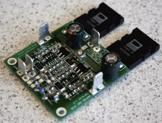

If you want cheap and simple, go for a Gainclone.
I'd steer clear of T-amps now simply because Tripath have gone bankrupt, and although Cirrus Logic have bought the T-amp technology rights, they aren't producing parts. National will probably keep the LM3886 going for quite some time.
I'd say that a well constructed Gainclone will easily better the sound of the NAD amp. My Gainclone keeps up with an Arcam Alpha amplifier costing at least 3 times what the Gainclone cost me to make :)
