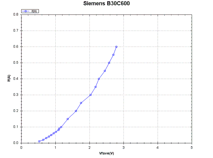

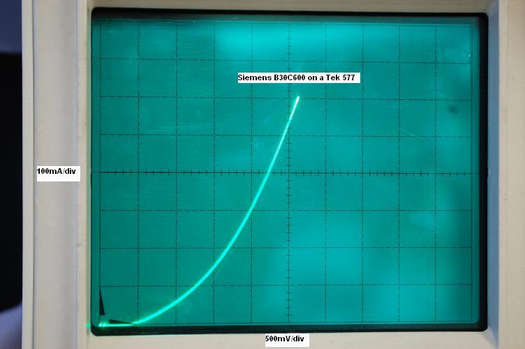

I've attached the Vf vs If curve as measured from a working part off a Fisher 500C for the benefit of those interested in replacing the original with a silicon diode.
To the mods, if this is not the right place please move it to the appropriate location. I reckon it should be in the tubes area since no modern design incorporates selenium rectifiers 😀
The peculiar axes (bilinear current, and opposite way round to the normal convention) hide the fact that this appears to be not much different from a pair of silicon diodes in series.

Actually I just tickled the X and Y values out of the graph to figure slope & intercept. (and therefore, forward cutoff voltage and equivalent series resistor value). Magic of EXCEL, and taking the two visually different segments
Vf = 0.51, Req = 7.3 ohm ... and then the second part in parallel:
Vf = 1.14, Req = 9.3 ohm ... in parallel with the first one.
HOWEVER, that being said ... there are a couple oddities in play: one is the forward voltage of 2.5 ... has a current-flow of 0.42 amps. My recollection of selenium-stack rectifiers was that each section (plate) is only good for like 20 volts reverse or something like that. Since they're technically a kind of Schottky, forward voltage drop can be low. How many plates though does this unit have?
As I found, there really isn't an exact silicon replacement. Pretty close is a standard silicon rectifier in series with a 7 ohm resistor, and from the diode-resistor point, another silicon rectifier with a 9 ohm resistor "across" the first resistor. Simple, and will have similar I:V characteristics. Just a bit higher shift in the forward conduction voltage, is all.

Hitachi-nut: Selenium rectifiers deteriorate with age;
your curves bend in the "wrong" direction, and there is that "knee" in the middle - both indicating your specimen is no longer in its original condition;
these flat Siemens had spring loaded plates or pills inside, and if they became loose over time, it may look like yours ...
max voltage for Se was 18Vrms per plate, so B30C600 had 2 pills per branch, total of 8.
voltage drop for Se was usually 1V at indicated max current (actually lower than Si).

OK. I have attached an updated plot, this time with the axis swapped and used a different free CSV to graph program, not M$ Excel. I have also the characteristic curve of one of the bridge legs using my Tek 577. The axes units and scaling are very close making comparison easier.
I forgot to add on the original post that the plot was the average values of the 4 legs, hence the kink on the curve.

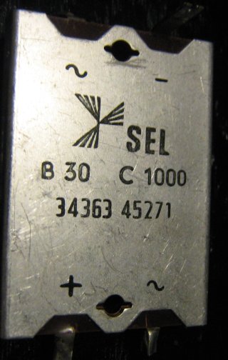

I found this flat Selenium rectifier from SEL (Standard Electric Lorenz) in my junk box
B30C1000 quite similar to the OPs.
Here's some raw data and comparison with modern Si. If someone wants to compile a plot pls be welcome to do so.
B30C1000 Se Bridge SEL flat pack 30Vrms/1A Ifav C-Load
KBU4D Si Bridge 150Vrms/4A
1N4002 Si Diode 100Vrrm/1A
1N5402 Si Diode 100Vrrm/3A
Idc[mA]...B30C1000...KBU4D...1N4002...1N5402
..50........0.39..........0.69.......0.78......0.72 V
.100.......0.45
.200.......0.53
.250.......0.61..........0.73.......0.81......0.76 V
.300.......0.64
.400.......0.71
.500.......0.76..........0.77.......0.83......0.78 V
.600.......0.80
.700.......0.84
.800.......0.90
.900.......0.94.........0.79.......0.85.......0.80 V
up to 50% rated load Selenium has actually lower voltage drop than Si
and even above it does not loose much.
So for the low voltage 30V device it seems feasable to just drop in a properly rated Silicon bridge for a Se rectifier. Series resistors may only be helpful close to max load. And if the designer choose 50% max load Si seems to be right on spot.
The situation is quite different for the higher voltage parts where Se has to use multiple junctions in a stack.
I happened to also have a E250C50 Selenium half wave rectifier 250Vrms/50mA.

A Si 1N4007 of course would still be around 0.7V.
Still - does it really matter whether B+ is 200V with Selenium and 212V with Silicon ?
Maybe not if it wasn't for control of inrush current or HF noise which is definitely worse in Silicon. Of course one could also place 15 Si diodes in series, a penny a piece.
