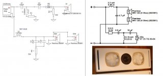

I thought I would share with you this project. Prototype crossovers were just finished. It uses the same drivers as the LM-1.
It's pretty simple, though definitely not done. Need to do something about it's physical location before I can finish voicing it.
And the predicted response. Keep in mind I have yet to finish tuning the ports or the crossover:

Hi Erik,
Went down this road a few years ago with Peerless 4ohm drivers (from the early 90s). So wanted to build a updated version for stereo listening.
A few questions:
What do you think about a narrow baffle, with front slot ports, similar to the attached pic?
A quick look at Madisound's website, the spec sheet calls for .3 - .4 f3 box, any thoughts about going with a .8 box?
Any concerns about stacking the drivers in a straight line?
What was your xo point?
Posting the xo from the project from a few years ago, we started with a 6.8uf series cap (tweeter), then moved down to 3.9uf which does sound really nice.
I believe the general consensus is the xt25 is a fine tweeter, if crossed over high.

A simulation of the LM-1 Center shows a crossover at 2 kHz and a distinctly falling frequency response. I don't know whether the double magnet tweeter allows a lower crossover frequency. A guy in Germany even did an MTM with the XT25 TG30-04 crossed at 1.65 kHz (Bausatz Samuel HQ – Heißmann Acoustics). The opinions are divided. 🙂
Thanks Dissi!
Yes, the frequency resposne is more or less as you say but the difference between the tweeter and bass hum is not quite as exaggerated, please see the measured graphs from the blog. Also, the tweeter is smoother than predicted by your cool charts, especially below 20 kHz.
The larger, dual magnet XT25 can be crossed over lower, but I didn't feel the need. Zaph claims that the small XT25 has a lot of distortion below 2 kHz but I did not find this to be true at least with the dual magnet.

I'm not very experienced with slot loading, so you'll be on your own there. 🙂 Having the 2 8 ohm woofers allows them to attach directly to the amplifier, for best damping. Look at the final impedance plots, the speaker is really easy to drive so no reason to try 4. Also the sensitivity matters. Having the 2 8 Ohm drivers gives 3 dB more than 2 series 4 Ohms. Makes it match the tweeter more easily.
The tweeter is deliberately offset, allowing smaller distance between all 3 drivers, plus minimizes diffraction effects.
Try WinISD for box simulations if you'd like to compare cabinet sizes.

Dissi,
The low pass filter 1.6mH coil actually is high impedance, around 1.2 Ohms since I used two small coils I had lying around. 🙂 It actually helps smooth out the FR as well as keeps the minimum impedance above 4 Ohms and damps down the bass a wee bit.
