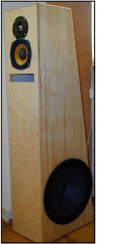

Does anyone here have experience in using side mounted woofers? I'm curious about how high you actually have to cross them over to get good integration, and what factors play into this.
When playing around with something like a 15" woofer, you're going to find that the front baffle gets huge. At the same time, smaller drivers don't always cut it. Putting the woofer on the side seems like a decent compromise. It also might get you a larger baffle, and thus better wavelaunch. (Depth causes less spouse aggravation than width, IME)
Obviously, the time difference will need to be compensated, and there may be other things that one will have to compensate for. I imagine lobing could get pretty weird with low order crossovers.
Anything else to keep in mind? And, again, how low does one need to cross over? I know of at least one commercial speaker that has excellent performance with a side mounted 10" woofer and a 250Hz crossover. Don't know what they've done to it, though.

The speakers I last built use a side mounted 12" crossed at 120 hz. No problems. It lets me keep a narrow baffle and uses the depth behind the speaker instead of placing a small speaker a few feet into the room, I place the speaker almost against the wall and still have the baffle out where you want it.

There are a lot of interesting things you can do with side-mounting, especially with regard to the acoustic loading. Study the NHT 3.3 and see how it's done by a real master of speaker design.

For those who have posted about good results with <200Hz crossover frequencies, thank you, but my concern was whether or not I could expect good imaging while crossing at >200Hz, and what means I would need to employ to achieve said imaging.
The advantage of a narrow baffle does improve imaging by itself, but when using a side firing woofer design, IMO, it is not recommendable to cross higher than 200Hz. Period. I would say 150Hz is still a bit high. Remember you only want the side firing woofer to reproduce the spectrum where the sound is almost unidirectional, by means deep bass.
IMO you should go for a midbass and not a midrange on the front, and try to get your XO point down to around 100Hz.

The advantage of a narrow baffle does improve imaging by itself, but when using a side firing woofer design, IMO, it is not recommendable to cross higher than 200Hz. Period. I would say 150Hz is still a bit high. ..IMO you should go for a midbass and not a midrange on the front, and try to get your XO point down to around 100Hz.
The NHT 3.3 and 2.5 used a XO of about 100Hz. But this means a relly big inductor (10-12mh) in th LP network.
I was looking at designs from Audio Physic (I'm told they use Wavecor drivers) and Morel which crossover over a little higher (still the inductor will be quite big). Does this rather large inductor create problems like stored energy and rob such a speaker of dynamics?
Due to WAF contraints I am considering building a speaker using a 5" mid-woofer mated to a pair of larger 9/10" side facing woofers (push-push).

I would like to drive this speaker from the front channels of an AV/HT reciever. However that means building a LP crossover in the range of 100Hz. I am not confident of this and would prefer to biamp the speaker (using the AV/HT for the top end and a dedicated subwoofer amp) but most AVR/HT recievers do not allow biamping of the front channels. Any ideas?
I got this design to work realy good, the 12" cut at ~100, the 5" has no high pass. so they work in parallel up to cut off for 12"

That is fairly easy. By setting the front to small and 100Hz low bass goes
to the LFE output, use that to drive the amplifier(s) for the bass end.
rgds, sreten.

I have Teledyne AR9s in my main system. Placement is critical. They have 2 side mounted woofers facing in opposite direction. When carefully placed and equalized they produce the best bass I've ever heard. A detailed explanation is avialable on the Classic Speaker Pages website. Tim Holl explains exactly how it works and how it crosses over to the 8' front mounted lower midrange. Work on side mounted woofers was pioneered by Roy Allison who left AR and started a company under his own name.

Get to know the options settings of your AV reciever. Have the fronts set to
large and the rest set to small. All you need to do then is turn off the LFE
feed to the sub for music, all bass will go the fronts. With LFE on bass
should go to the sub and the fronts. Unprocessed stereo in will have
no centre or rear output. You could biamp the fronts by using plate
amps for the bass end and passive filters c/o for the mid / treble.
rgds, sreten.

Dual side firing woofers down at the bottom do have some nice advantages, not just the form factor. Dual opposed helps with vibration (turn off one and the box will vibrate much more). The upper limit is related to driver size as they move away from omni radiation. You can probably also run it a bit higher, factoring in speaker boundary issues and bafflestep. If you cross the woofers at say 100 Hz you might find the woofers get a smoother response than the mids due to the elimination of floor bounce. You can also sort out bafflestep if your woofers run up a bit higher, potentially bringing up the system efficiency a bit. Let's say you have bafflestep coming in around 300 Hz, you can avoid any loss by using sensitive woofers and bringing them in here. It's a bit of a jugggling contest. Personally I'd bi-amp it at least, or even make it completely active, combine a MiniDSP and multi channel amp modules in one box.
