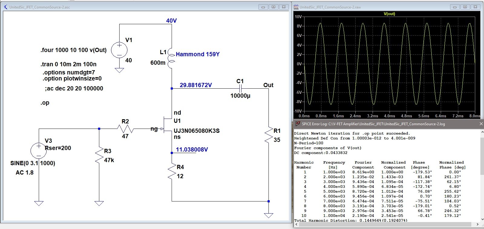

Being a brute force type of guy, based on my experience with the UJ3N065080K3S, I just simulated a variation of one of my prototyped amps for lower power output into a 35 ohm resistive load.
The attached results is for 1 watt output into 35 ohms with 0.15% THD. Frequency response at 30 Hz is down about 0.5 dB. Dissipation of the JFET is about 17 watts. Bias current is about 900 mA with Vds = 19V.
It would be easy to breadboard such a circuit for experimenting.
