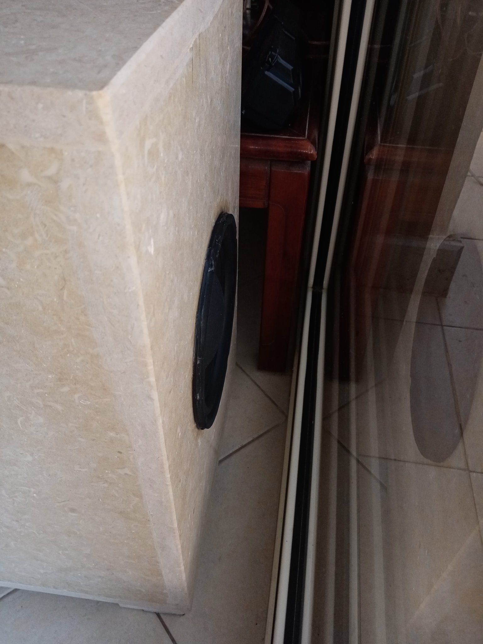

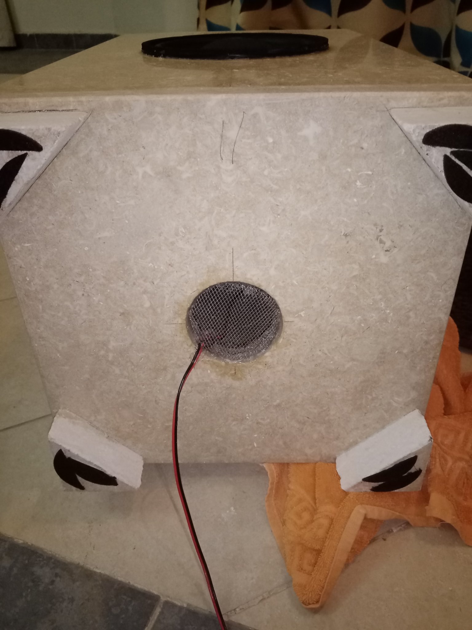

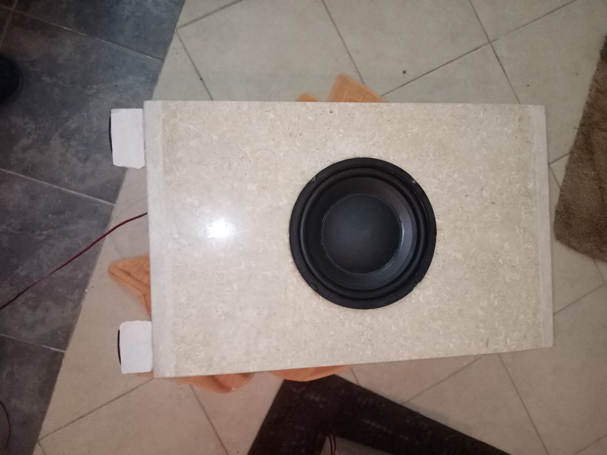

Here my marble subwoofer with 8 inch driver.

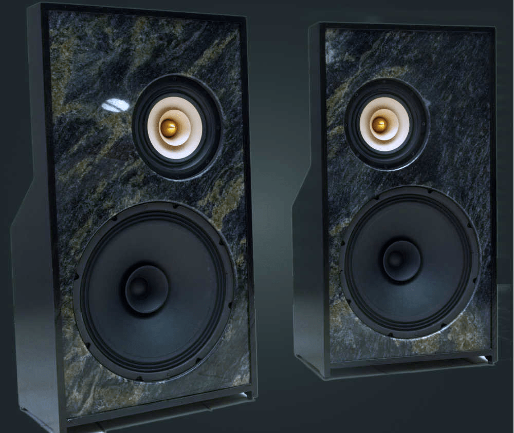

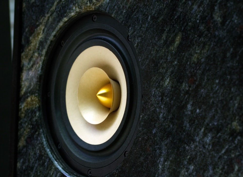

Mine are from composites.
One layer of plywood, one layer of honeycombed aluminium, and one layer of a stone called blue barracuda.
Plywood is 15mm, aluminium is 6mm, and the stone is also 6mm. Baffle distortion is non-existent. Each material canceling each other.
That good-looking that they look like renditions! Well done. It's been a while since I have come across someone pulling off a departure from norm, looks magnificentMine are from composites.
One question, is the aluminium honeycomb the core in the sandwich?
Yes, it’s actually: stone-plywood-aluminium-plywood-stone.One question, is the aluminium honeycomb the core in the sandwich?
May I please ask the reason for the plywood, that bit doesn't make sense to meYes, it’s actually: stone-plywood-aluminium-plywood-stone.
A couple of reasons.May I please ask the reason for the plywood, that bit doesn't make sense to me
First, it's a lot easier to screw in drivers into plywood. But, the main reason is since the stone and aluminium have very high resonances, the plywood helps cancel those. So, each material helps canceling the resonance of the others.

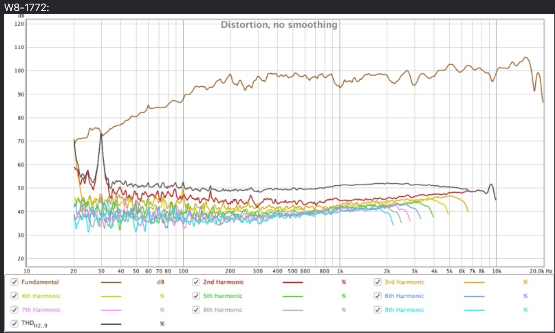

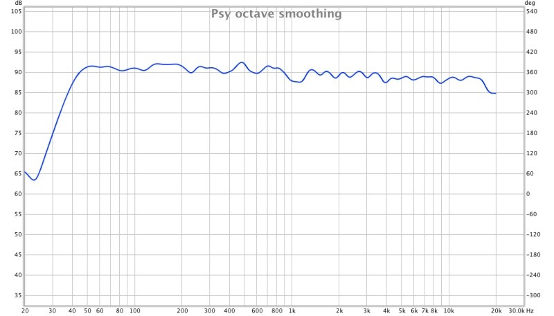

Here are the FR and distortion graphs for each driver. Disregard the spike at 30Hz, it was a sound card glitch.
Hi there, Studley.
The stone is called Blue Barracuda (I don't make the names!)
There is a factory here that can cut slabs down to 6mm thick while glueing them to 6mm honeycombed aluminum so they don't shatter.
Most places need to cut them to at least 15mm. The factory I found do these panels for expensive yachts, so they need to cut them thin as to keep the weight down.
It was only natural to use a layer of 15mm plywood in the middle to bind them up.
The stone and aluminum was cut using water jet cutting at the factory, and I glued the panels up to the plywood. Basically a flat pack for the stone (once I explained what I wanted to do), and I made the assembly, frame, and XO myself.

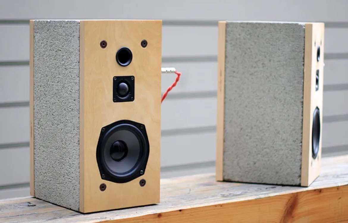

There are thousands of objects made from this light concrete. You find them quite cheap in Home Depot and gardening stores. Many could be used for speaker and subwoofer, just by glueing some baffle on one or two sides. If you like the look, don't mind the weight and follow the rules, like correct priming, I'm sure you may have great results.
