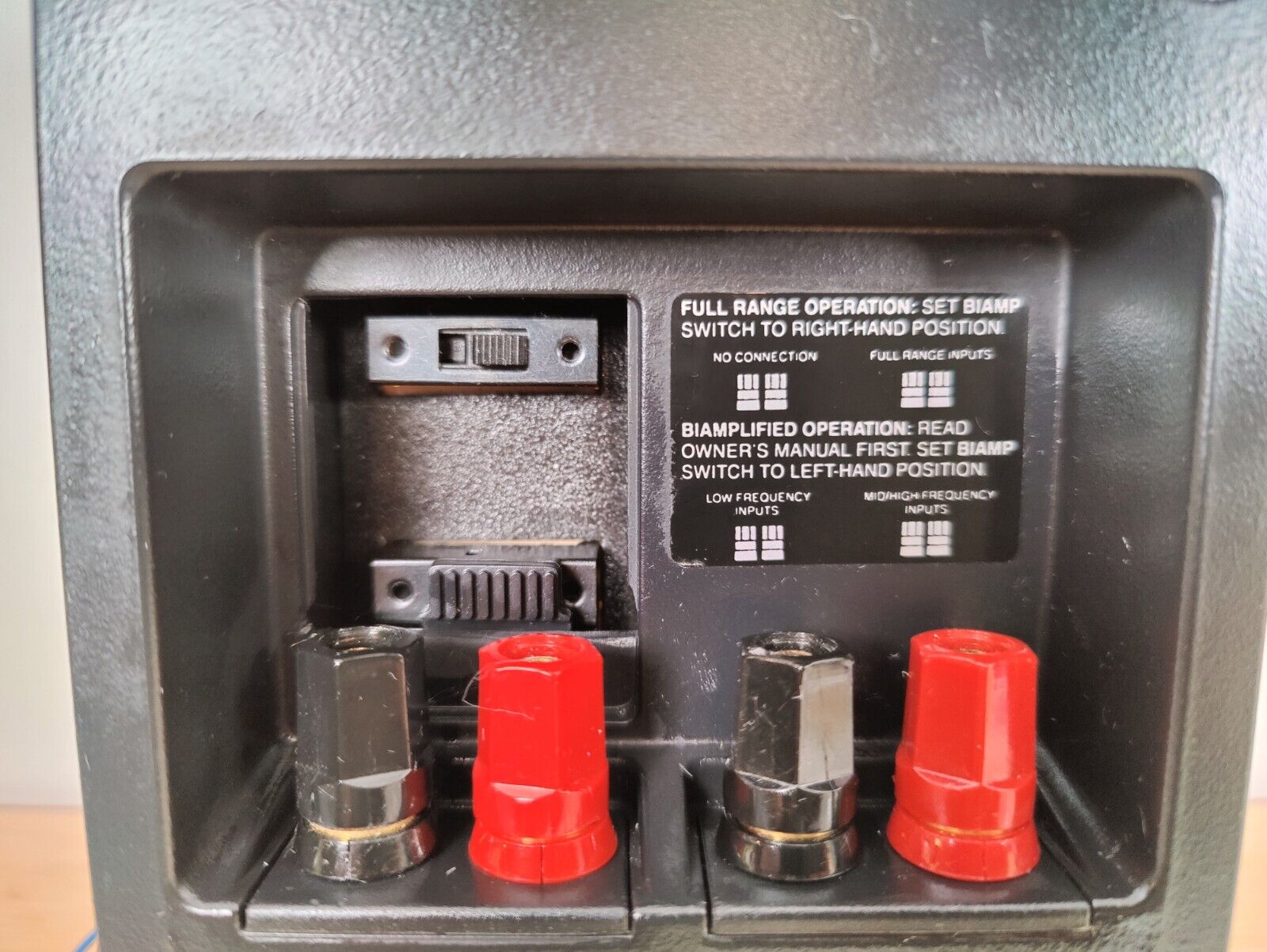

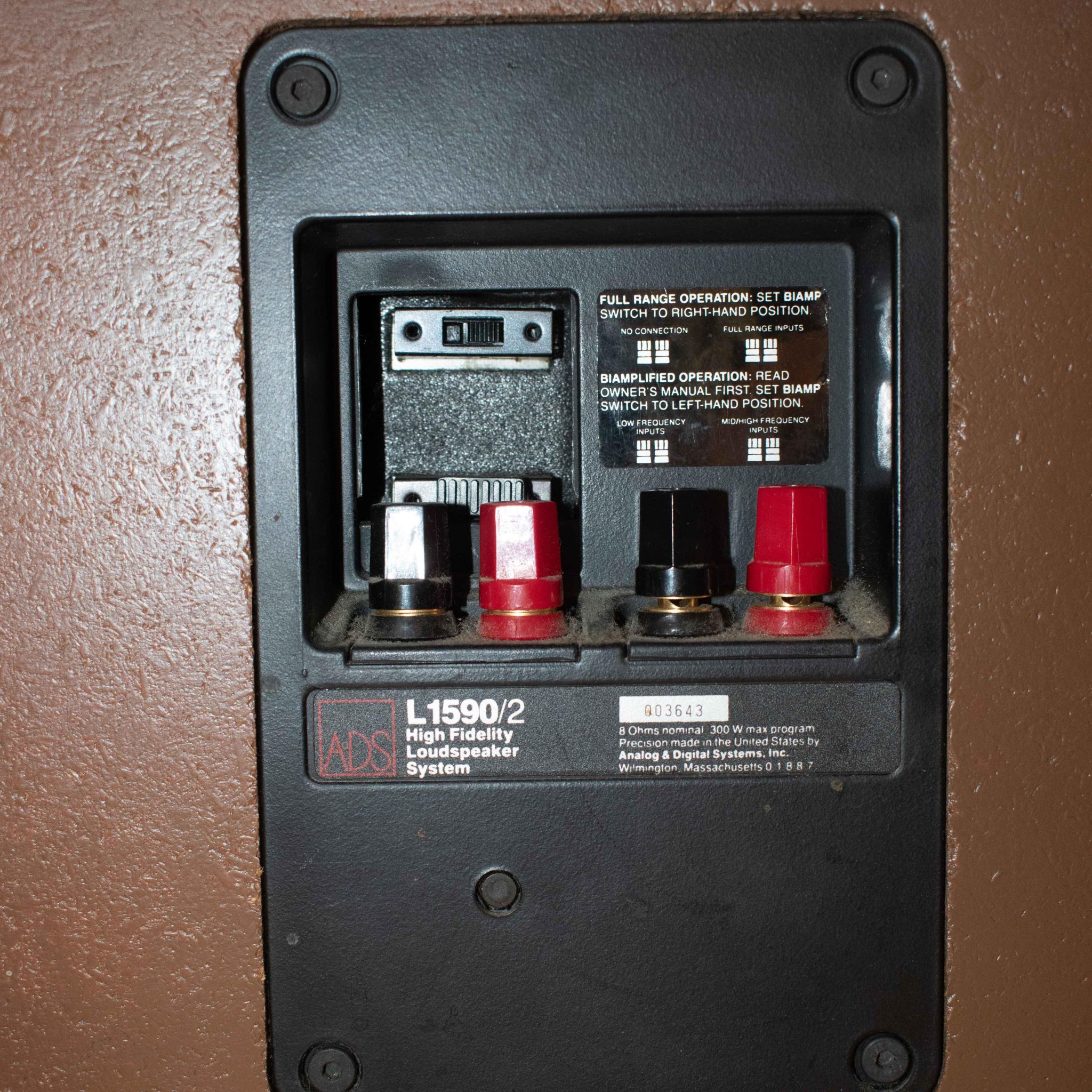

I forgot to mention on the first post that the L1590/2 speakers have bypass switches for the woofer section. They were designed to be bi-amped.I would not change the crossover unless you can be sure there is a problem, or you are testing a hypothesis.
