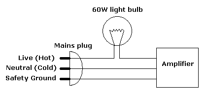

I would replace the blown diodes and power up, but make sure you use the light bulb as Andrew suggests. This should save your PSU if the amp chip has gone faulty. A 40W incandescent bulb should be OK.
Woth dual-mono design, I'd expect the other channel to be fine. You could totally disconnect the fried channel and see if the other one still works.Do you think both amp-chips are toast, or just the one on the board that caused the short?
This is a very good idea when you're first testing something. It's wired up as shown below.A bulb tester in the mains feed may have saved your amplifier & PSU from any damage. The bulb usually lights up to tell you the circuit is trying to draw too much power.

I was just about to ask for how the light-bulb test was supposed to be connected, but you beat me to it

I bought a new LM3886 chip for the affected board, but since Im still note entirely sure that the other one survived I will use the light bulb setup and test each amplifier board separate (without any load, just measuring DC offset at the output as suggested in the manual).
