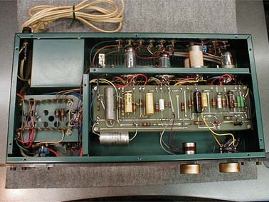

Such a circuit for a line pre-amplifier I have never seen before.
There are two negative feedback loops from the output:
1) One of the input of the last stage (470 K)
2) One to the cathode of the 6067 - first stage (100K+220K parallel in series with 2uF capacitor)
It looks a bit like a NDFL
The following questions arise for me to the attached schematic diagram (drawing and measure errors are not to rule out):
1) What is the aim of two volume controls (one on front site and one at the rear panel) ?
2) What is the name of the circuit topology behind the second volume control (last two stages with 12BH7 - at fist look a SRPP, but it isn't)?
3) The second volume control is inside of the globale NFB loop. Which consequenses are to expect in case of the different attenuator positions there?
4) The couple capacitor in front of the second volume control is a Sprague ceramic disc with a diameter of approximately 1 inch. What could be the advantage?

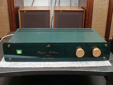

about
http://www.hifido.co.jp/KW/G0103/J/0-50/C05-25468-61439-00/
you will find some pics about this preamp.

There aren't actually two negative feedback loops in this design, the 470K resistor is part of the bias network for the 12BH7A, it is arguably partially bootstrapped by this connection..
The output stage is a white cathode follower..
The volume pot on the rear varies the available open loop gain that can be applied to the feedback loop, allowing one to vary the feedback margin. Presumably this would allow one to tailor the harmonic content of the output signal. Note that as designed it is quite possible to set it in such a fashion that either massive distortion or no sound at all will result. (As you approach the low end of the pot setting.)
The ceramic coupling cap is a fashion statement, and a highly non-linear one at that.
This seems like a fairly questionable design, the best I can say is that it is clearly intended to "interpret" the program material rather than reproduce it accurately...

A strange circuit. It has the standard mistake which everyone seems to make: volume pot slider goes straight to grid, so pot gets noisy and valve has no bias when pot fails. Putting a volume pot inside a feedback loop means that it is an effects box, not a serious preamp.
The RIAA preamp section is running the ECC83 rather too near the region of grid current at below 1V bias, so distortion is quite likely at the HF end where the cartridge impedance rises. The 3K cathode resistor will inject thermal noise. The 22K anode resistor seems rather too small for an ECC83. Is that really a 1G resistor in the RIAA feedback network?

The 1 G-Ohm resistor in the RIAA network isn't a misprint; the colors are brown-black-blue and the measured value is also 1 G-Ohm (exactly 1,06 G-Ohm).

Brown-Black-Blue is actually 10M not 1G, anything over 30M is going to be fairly uncommon. 1G resistors are extremely rare in the field although they do exist..
Yes, thanks for that advice. In the attachement you will find all the corrections, that I have found in the schematic by troubleshooting on the device. I have marked the changes with a black triangle.Brown-Black-Blue is actually 10M not 1G, anything over 30M is going to be fairly uncommon. 1G resistors are extremely rare in the field although they do exist..
Who knows the values of the Mallory multi-capacitor for filtering the heater voltage?
Even at 10M that feedback resistor could still be wrong. It ought to be something in the region of 1.5M, to give the 20dB RIAA LF shelf with the 150K. With infinite open-loop gain it would be 1.377M, but two '83 triodes don't quite give infinite gain - maybe a few hundred or even a thousand - so the resistor has to be bigger. If 10M is indeed the correct value, then the RIAA LF response will change as the valves age as there is virtually no feedback at the LF end. If 10M is too big, as I suspect, then this preamp might be fine for 'one-note-bass' when listening to reggae as the response will carry on rising past 50Hz (going downwards) instead of levelling off. You would also need a perfect turntable with perfect warp-free records. My guess is that the 'designer' is one of those who 'designs' by ear instead of using a calculator.

Maybee the feedback loop should be connected to the 6067 anode or to the top of the second (backside) volume control.
Better the latter, as the voltage rating is only 200V on that 2u feedback capacitor.
The White Cathode Follower is already feedbacked & low impedance by design and needs not to be in the feedback loop.
If done like that, the second volume control makes sense in setting the output voltage level to the power amp used.
Are you sure Mr tiefbassuebertr, that it is connected to the WCF output?

Yes, the NFB is connected to the WCF output as shown in the schematic. In the meantime only the WCF works as line preamplifier, and the first stage now is death include removed 6067 (best sound in this mode, sensitivity of follow power amp alrerady 100mV).
The multisection capacitors for the high voltage are in good condition (Mallory offered mostly high quality and long-life products). I don't know for this one in the heater circuit because the value of capacity is unknown (no sticker on it). Ceramic disc capacities (both RIAA and line part) I have replace through KP versions.
I am also of the opinion that the circuit design and the choice of certainly devices was not really the yellow of the egg. Until this day I haven't understand, why line preamplifier must have more voltage gain than unity gain (a general problem also by most of currently available preamps in my view).
But there are also some positive details to find:
- two identical PCBs with an intermediate metal shield plate
- no tube sockets on the PCB and therefore no thermal stress (screwed tube sockets on the chassis)
- component site = solder site, therefore no disass'y of the PCB's necessary by troubleshooting and replacing the devices
- partly DALE resistors in use (the other kind of resistors I don't know)
- excellent workmanship
If it was vice versa (circuit design almost perfect but unfriendly service) it would be more difficult for me.

The WCF's in you amp is almost right done, except:
The 47K grid resistor in the lower tube should be 470KOhm.
The output signal should be taken out from the upper tubes cathode, not the lower tubes anode.
A resistor of a few hundred Ohms should be in series with the output capacitor, to isolate the WCF feedback loop from capacitive loads.
A 100-470uF 10V capacitor over the lower tubes cathode resistor will make the WCF work better.
The 0,47uF output capacitor seems to small if you're load impedance is lower than 30-40KOhm...Use the 2uF Sprague "Black Beuty" (I think I see on the photo) instead. 200V will be enough from that point.
The phono stage I don't comment, as it's in need for a complete redesign.
