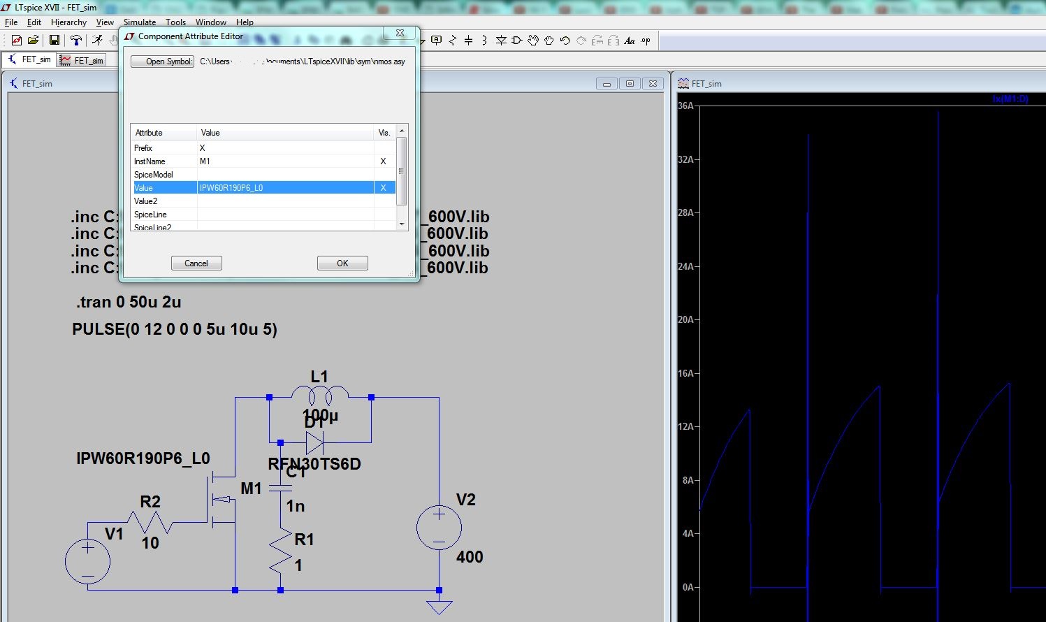

you can put .lib in some folder, in LTSpice add .inc to that folder, place nmos or pmos on schematic, hold CTRL and right click on mosfet and change prefix to X, to use subcircuit from file. Name of mosfet will be the same as in the .lib file (open with text editor). -L0 is level0 for basic simulation.
There are L1, L2 and L3 also, but I didn't get them to work, you change things. L0 works just fine
