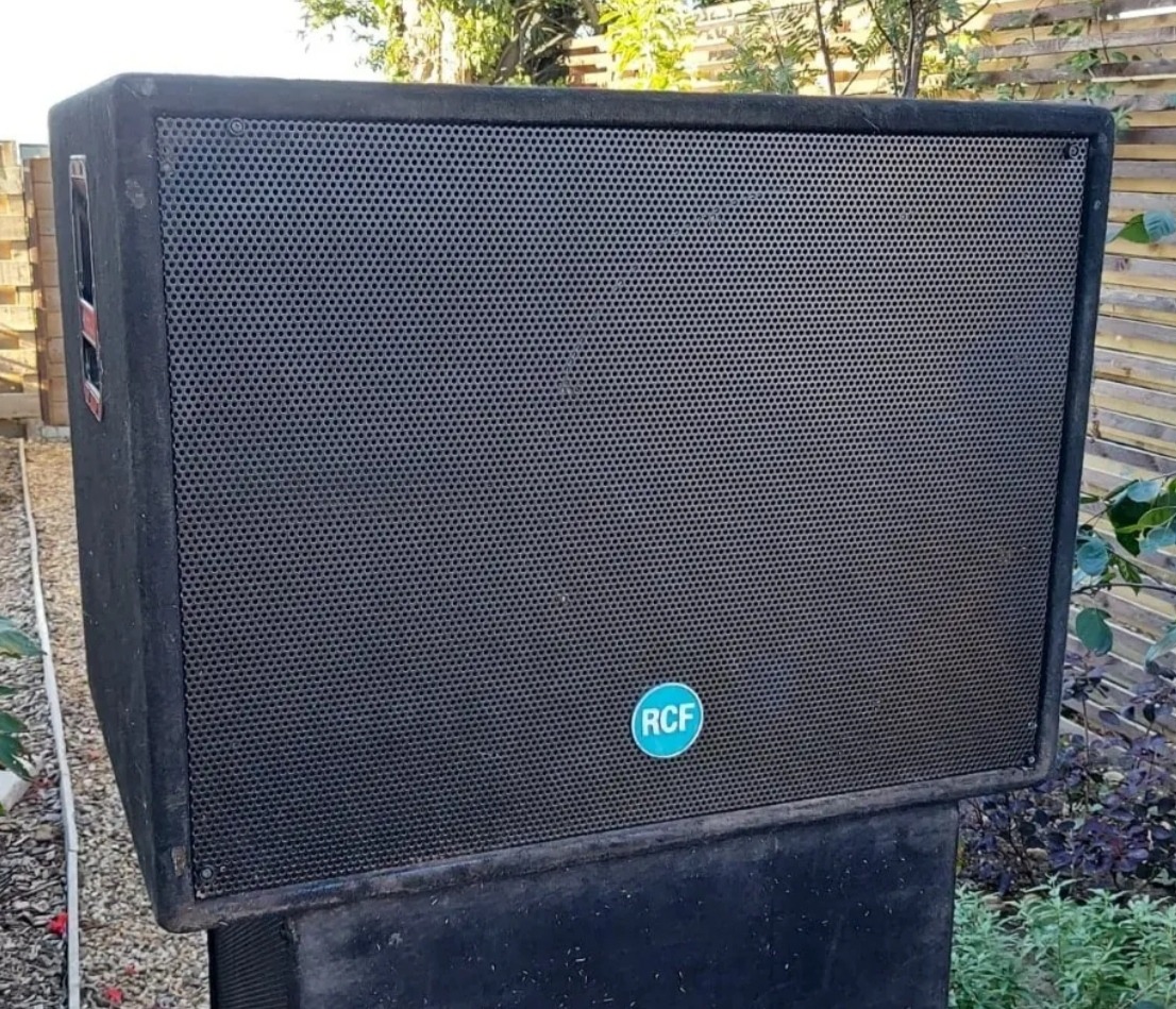

Ok cheers for your replies. The RCF subs are Event 18s, I'll have to look at the specifications again.
It's a beer garden festival but they say there could be up to 800 people so it must be a big space. There will be around 8 different bands throughout the day playing mainly rock music.
Maybe I'll just stick to what I have then. 2x Behringher amps, one running the 4x Peavey tops (2parralel on each channel) and the two RCFs with the other amp (one for each channel).

Moderator
Joined 2003
The RCF is 8 ohms, kinder to the amplifier. You certainly will have enough bass. 800 people is a lot for this set, but the advantage is that the neighbours won't complain too much.
I would recommend a small tryout though.
Set the crossover points as indicated, that will make it a little easier for the Peavey amp.
