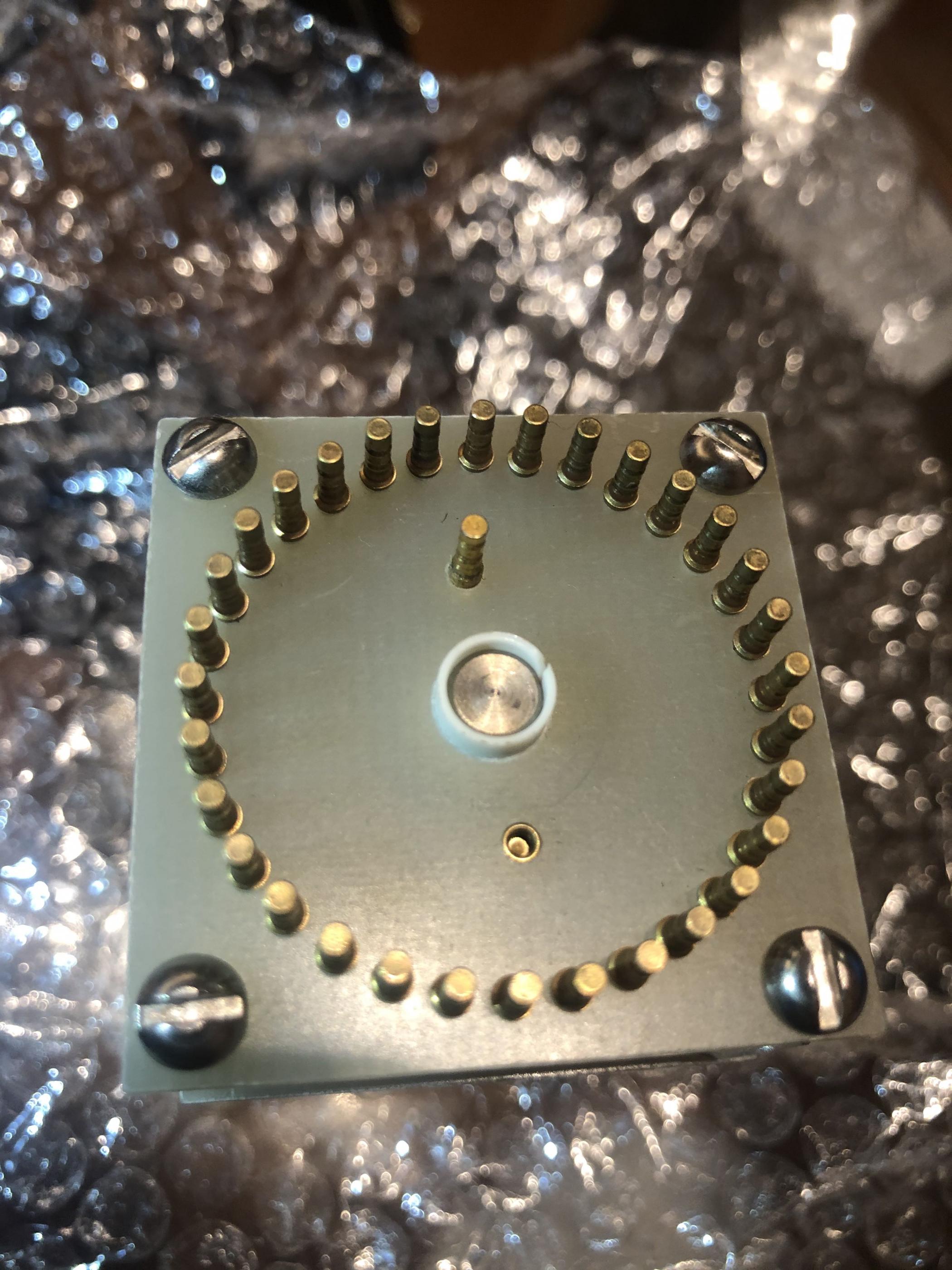

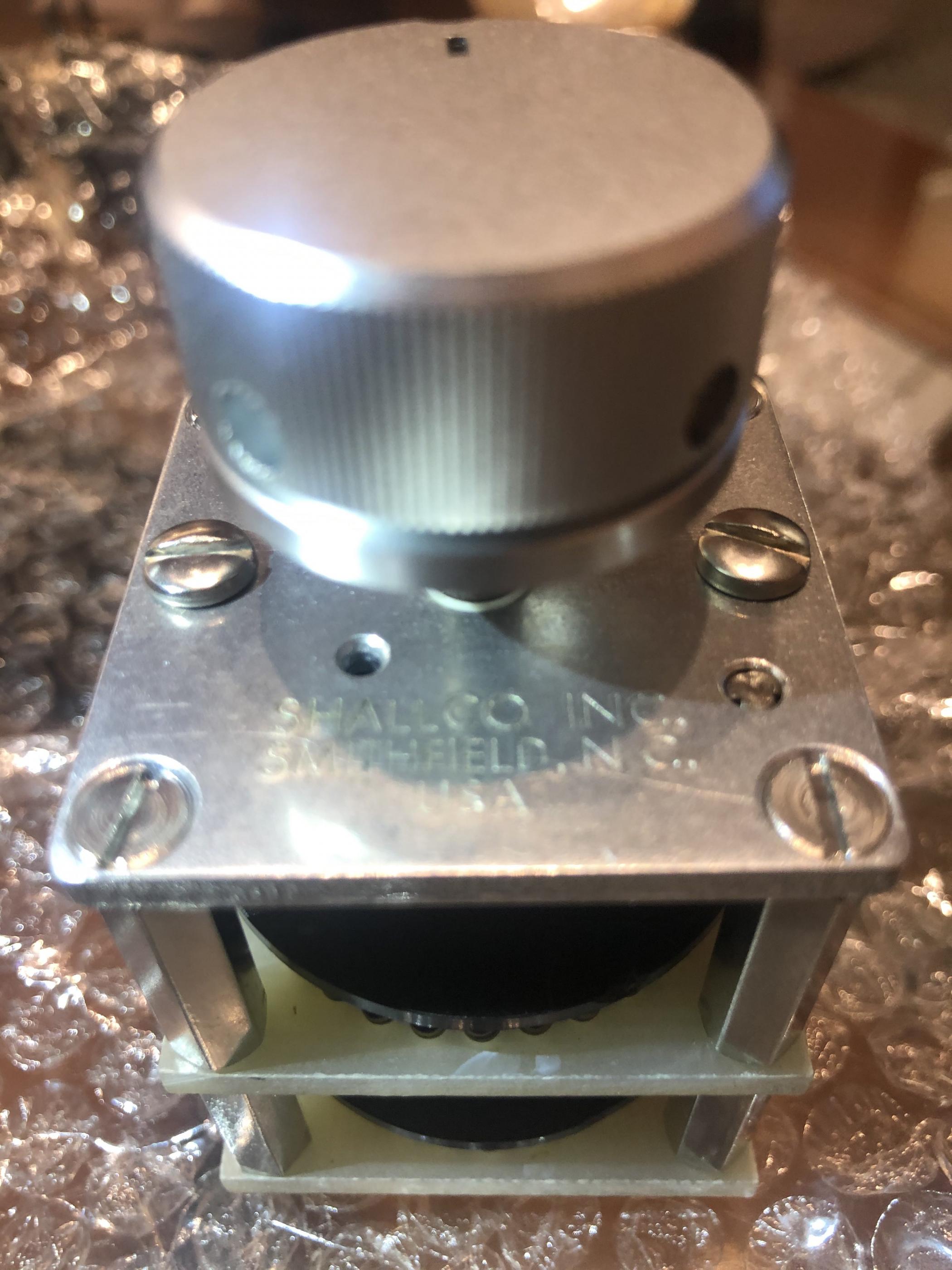

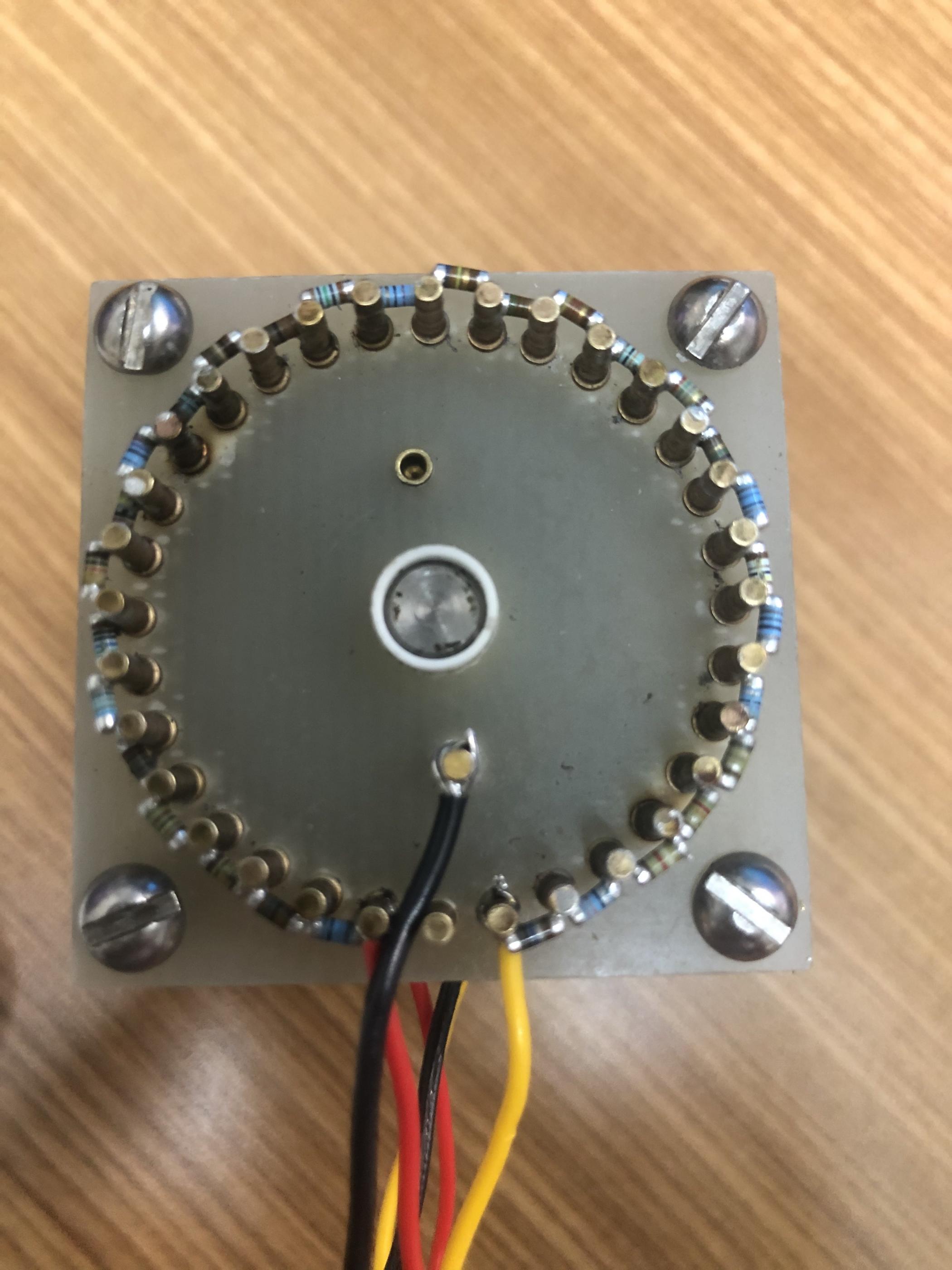

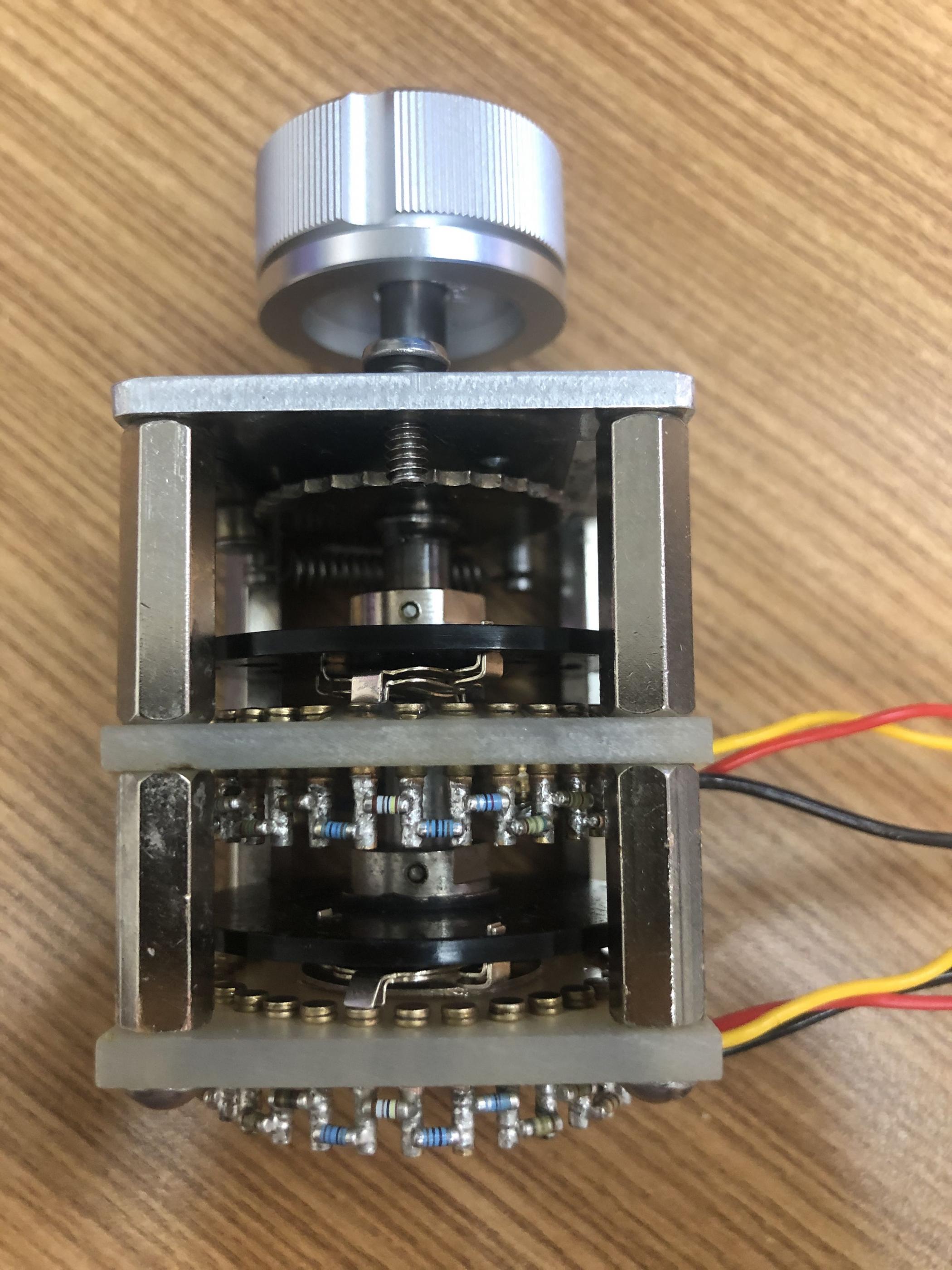

My friend gave me a pair of this excellent switches.

PRR
Joined 2003
> What makes it so good?
The Shallcross/Shallco (and another brand, Daven, also IRC) were PROFESSIONAL attenuators invented in the 1930s for talking-movie and broadcast applications, where reliability was more important than the cost. Find pictures online. Solid contacts with selected metal plating, real springs, solid wafers.
http://www.technicalaudio.com/pdf/Daven/Daven_attenuator_switch_lab_Catalog.pdf
