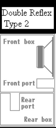

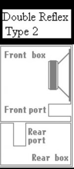

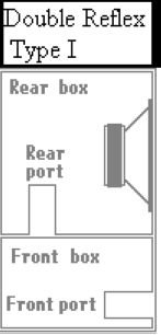

This type can be modelled, using Adire drivers, on LSPCAD for Adire, which is freeware.
Notice that all three boxes about to be shown have different port configurations.
Note: If you can find an Adire driver with Lower Qts than the one you woant to model, , you can just add a series resistor to the Adire driver to raise the Adire's Qts to equal any non-Adire driver you have in mind. Tips on how to do that in coming post.
And here is the Weems/Augspurger, (Weems gives full credit to Augspurger), type.
Here are two posts on it, #34 and 35, with instructions from Weems' Great Sound Speaker Manual.
http://www.diyaudio.com/forums/showthread.php?postid=93570#post93570
the thumbnail also shows how to add a series resistor to raise the Qts-which you can then model on LspCAD to convert the Qts of an Adire woofer to one identical to a non-Adire woofer you might have in mind. 🙂

My question has to do with the first picture Kelticwizard showed from LspCad for Adire. Is there an equation out there for determining the optimum size of that bottom box? I'm searching Claudio Negro's page for something like this, because that is all I need to finish off my potentially patentable design. It's like a very high order vented box design that integrates three chambers.

There is a MathCad worksheet that analyzes the first configuration shown above on my webite's models page. If I remember correctly, the worksheet is set up to analyze a Fostex provided design. Somebody sent me measured results for this configuration and they matched the worksheet predictions very closely. All you need to do is iterate the variables input to the worksheet to get a response that meets your goals.
