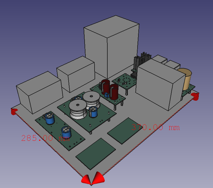

I designed a separate PSU chassis for my preamp: it has two hefty transformers, one each for analog and DSP sections, along with three chonky chokes for LCRC filtering (rail hum is low single-digit millivolts before regulators). Throw in a few capacitors & silicon and there's hardly any room left for preamping.
