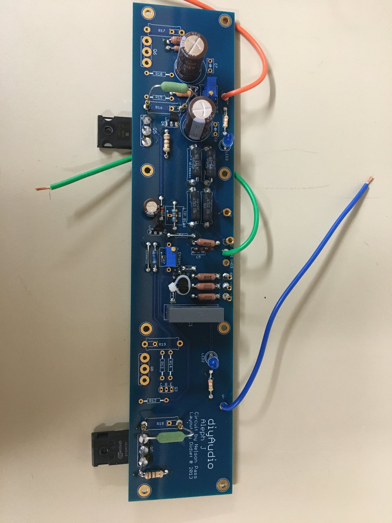

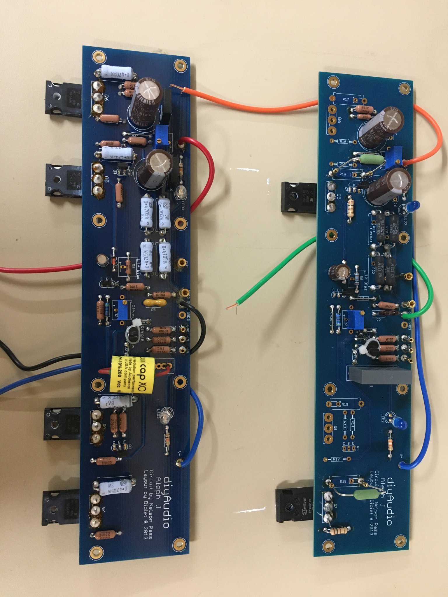

No. The ALEPH series of amplifiers uses an ALEPH Current Source circuit. The ALEPH J build guide has a description of the circuit, I would NOT do it justice explaining it.
Here is the thread for the SemiSouth version: https://www.diyaudio.com/community/threads/semisouth-aleph-j.176857/
Attached are the ALEPH J PCB and the SemiSouth version together and the SemiSouth version alone.

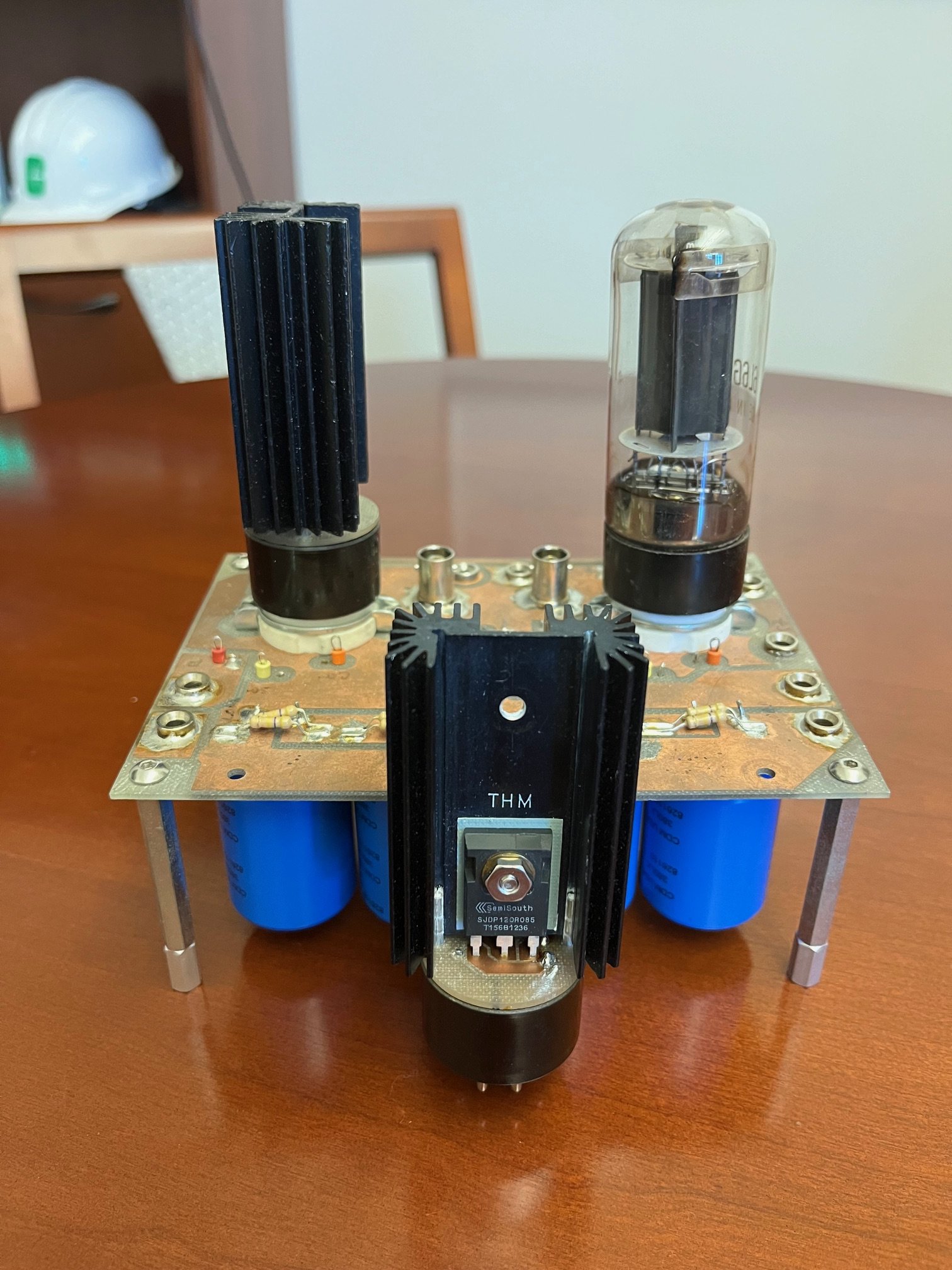

Thanks guys for the pictures and threads. Very Helpful ! I'm trying to get my amp done before April. Though my job at a Museum, I met a gentleman named Mike Mazzola, It turns out to be the same Mike Mazzola from Semi South. He is a really Nice, Cool and passionate guy. We are working on Museum Experience for Innovation Day comparing a drop in Tube replacement using SiC Jfet for guitar Amplifiers. There will be guitar playing demo, guest playing guitar to comparing the sounds of Tube Vs SiC Jfet

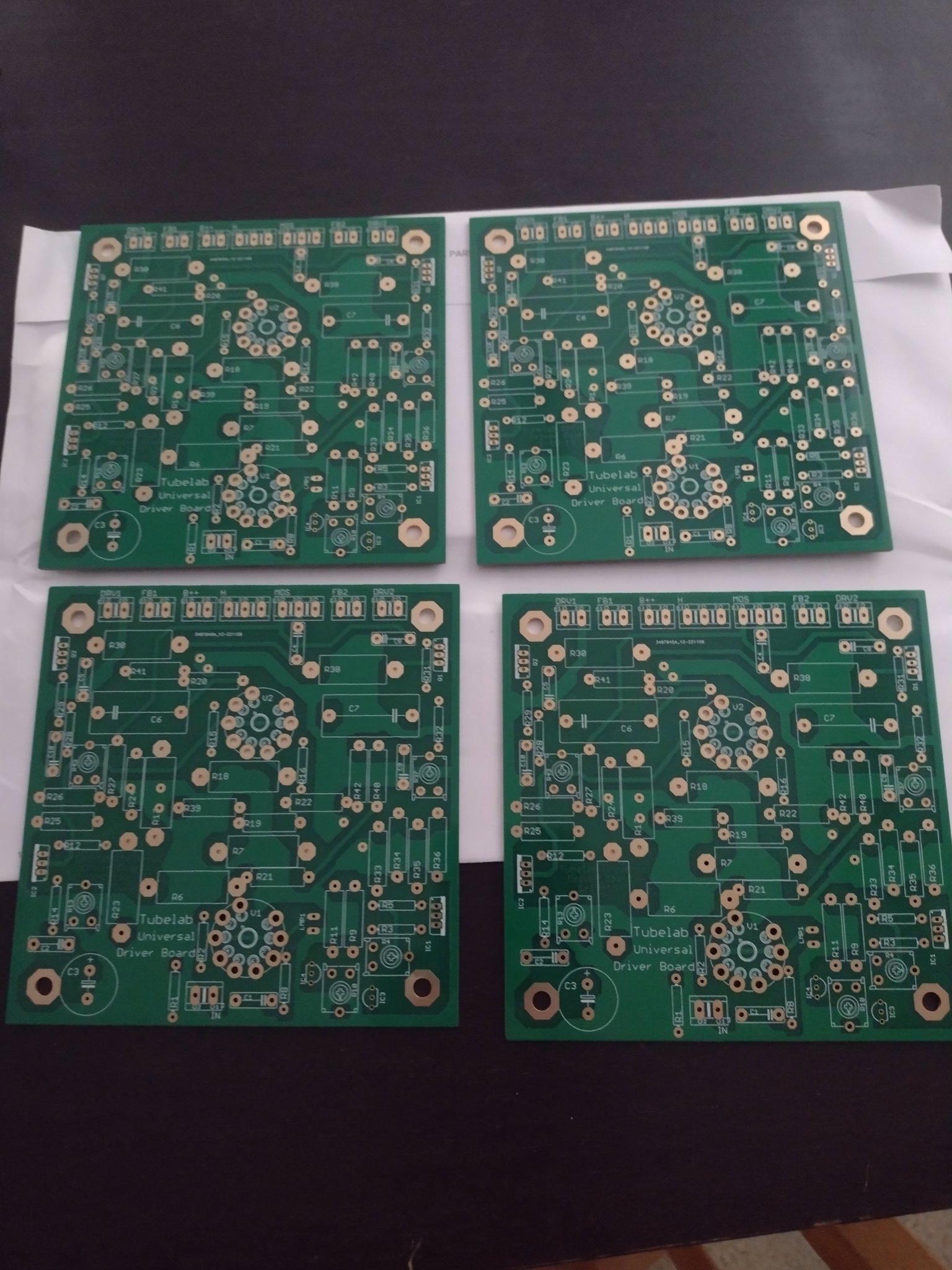

output tubes - for best results, they need low impedance drive
ask George, he devised funny Power Drive, with reason

Funny that you mentioned George, I've actual have his universal driver board that I got over a year ago. I heard that he has suspended sales on all his boards at this moment. But the picture SiC Jfets "Tube" substitute was developed by the fine folks who developed the Semi South SiC Jfet. One of the engineers is a guitarist, and during "Innovation Day" in April there will be three Fender Tweed Champ build kits from Mojotone. For the demonstration there will be Champ amp with a 6V6 and one with the SIc Jfet. The proof is in the listening. I have not heard the SiC Jfet, so I'm excited to listening to it during Innovation day.ask George, he devised funny Power Drive, with reason
