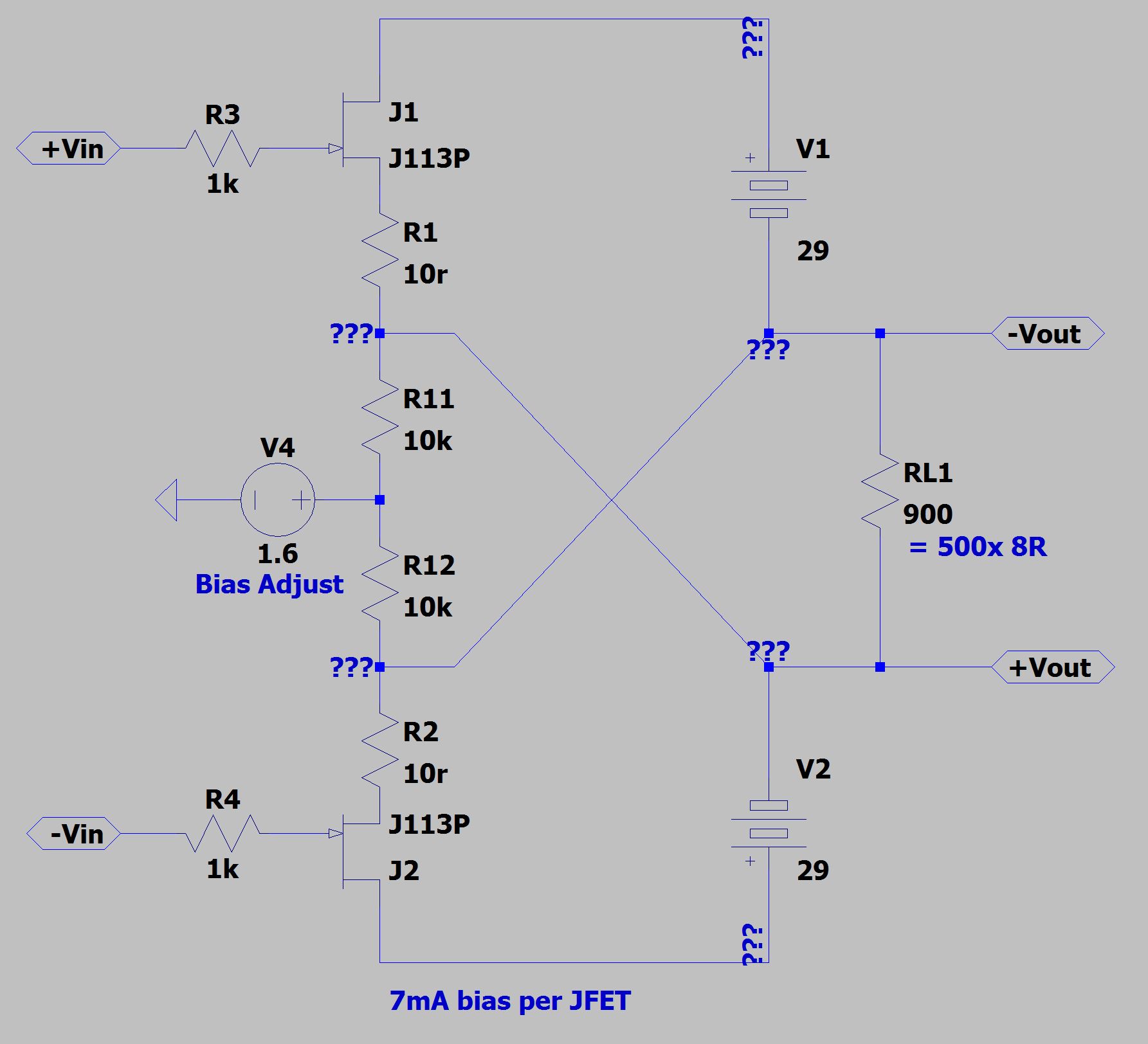

I have 2 pairs of Semisouth R100 JFETs. Having successfully breadboarded a J113 circlotron circuit, I am considering trying a point-to-point lashup of a pair of R100s in a circlotron configuration. Has anyone already tried this?

Thanks guys. I believe that I just need to invert the polarity of the Bias Adjust in this circuit for the Semisouth R100 and any normal N-MOSFET as well. .. and reduce the value of the Source R.
