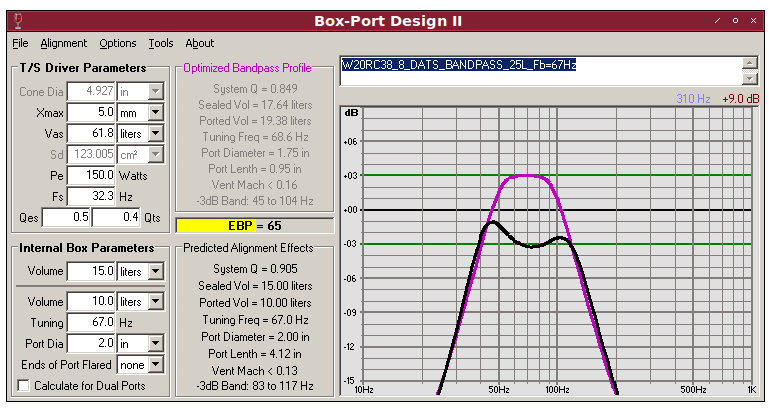

Check your Fb on that BP build. I'm betting that they're lower than expected. I used to have a similar bandpass response with my Enigma build. Turned out that Fb was lower than expected, because the vent length calculation rules lose accuracy when the vents start to exceed about 10% of the chamber's volume. I had to cut them back about 30% or so to achieve target Fb and a flatter passband response.
Thanks for your advice.
The response is deliberate.
I like my bass to have a bit of boost at 50Hz~40Hz.
Below is my box sim for a Triple Chamber Bandpass using two Dayton DA135-8.
For this BP, I went for a wider bandwidth instead of a flat response.
In the final build, the response is exactly what the sim predicted.

That's different to the previous response you posted, which was this ...[snip]
[/snip]
The above response is what I'd expect to see if the bandpass alignment was tuned too low.
Yes, it is different. I tuned it that way.
I found the box sim for this BP.
It came out exactly as predicted.
If I had wanted a flat response, the box would be about 37 liters.
I preferred a compact 25L.
Moreover, with a flat response, the bandwidth is narrower.
That was not what I was going for.
BP are very sensitive to T/S.
If they are not accurate, the sim will be off.
