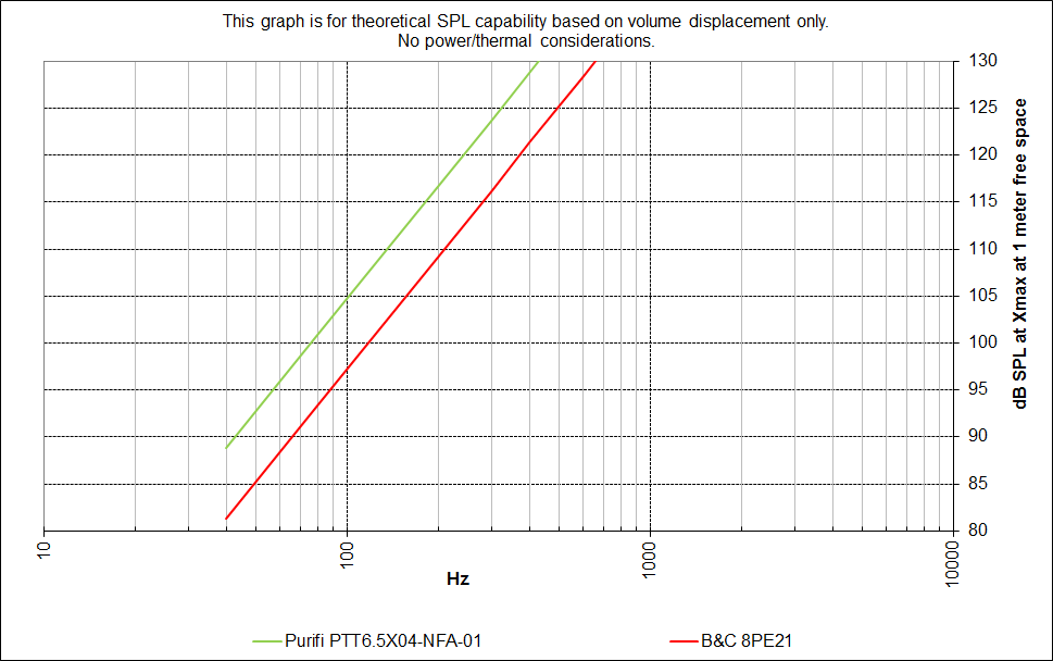

Boiled down to a basic level (and ignoring some things), volume displacement determines maximum output. In free space, you wind up with a plot like this:
The higher you cross them over, the more output you can get out of them before running out of excursion. Cabin gain has to be added to these numbers also.
In some high SPL vehicles people want the midrange and midbass to keep up with their subwoofers. Other people (that actually want to be able to hear long term) only need those drivers to play at sound quality levels. I still can't figure out where you fit on that scale.
With multiple DSP presents, it's easier to run higher high-pass cross points in high SPL mode, and lower cross points for sound quality. Doing that can give you more output capability when you want it.
Your previous door speakers had high resonance, high sensitivity, and are basically pro-audio style drivers. This normally comes with low Xmax as well (like with the B&C ones). When this is carried far enough, you get into true midrange drivers, not midbasses like you typically want in a car. Pro-style drivers typically handle high power better, have larger voice coils, etc., so they have benefits. It all depends on how you want to use them.
I'm not suggesting Purifi is the right way to go for you, it's just an example of a high displacement, low distortion 6.5 inch. If you want to modify your doors and make an 8 inch fit, that's certainly an option, and some people like going more custom. Others are happier to try to fit things in a standard configuration - which is why I threw the 6.5 inch high displacement idea out there.
