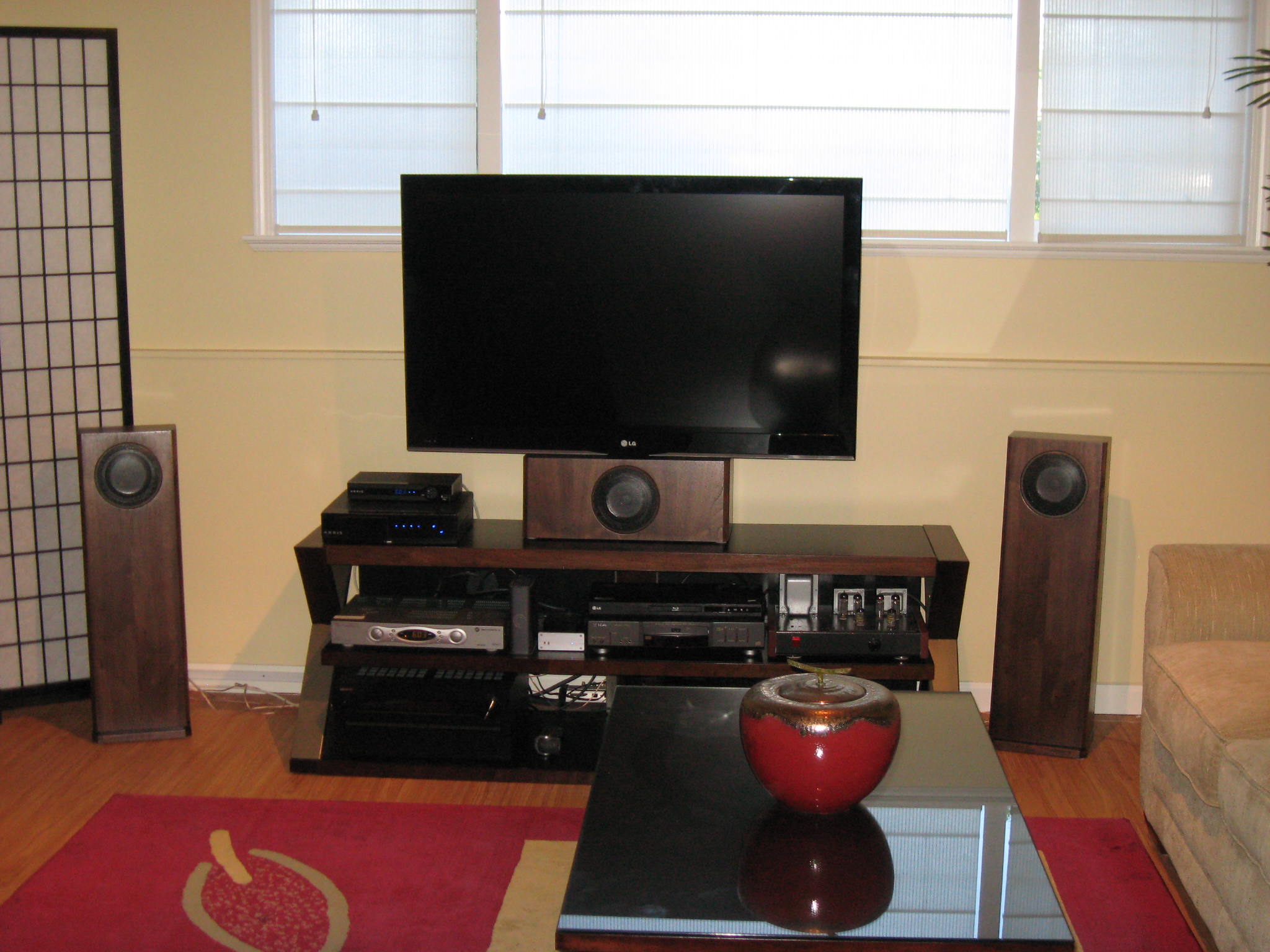

As much as I enjoyed A7s in the front row of a small room HT rig ( currently driven by an Onkyo receiver) I don't regret upgrading that phalanx to A10Ps, although the metal 10.3s wouldn't be hurtful either.
If you're talking about the AVR S700W, even after de-rating the power specs by at least 25%, you probably have more than enough power for the room described.

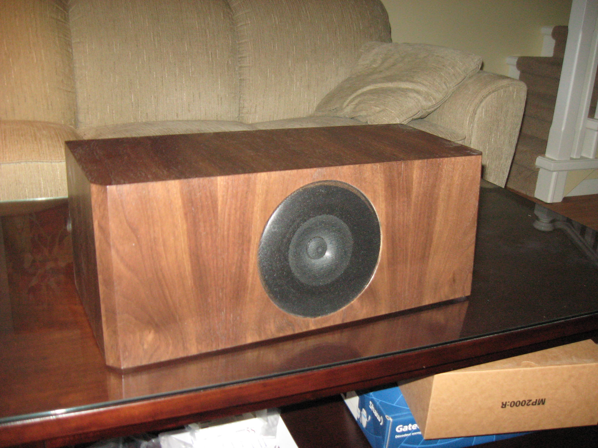

The centre channel sits immediately under the 42" screen ( I know, hopelessly small for the 10 ft viewing distance), and the L&R main enclosures place the drivers probably 4" above that enclosure's acoustic centre .
All of those enclosures are vented ( designs by Dave ) - I've not spent significant time listening to any of the 10s in sealed enclosures, so advice on that choice is open to the floor for discussion.
A pair of SDX 10s XO'd about where you're thinking would be a great start - when you run the Audyssey speaker set-up protocol you'll likely find the default finding of lower than 120Hz if you spec the front row speakers as large. In my own case (7.1 with front height and rear surrounds using CHP70 and Alpair 6s respectively) , I manually adjusted the LFE channel XO to 80Hz after running the automated process. I'm using a Dayton AP150 to power my own woofers - soon to be a pair bridged in mono upon return of one from loan.
I'd plan on placing the subs separately - in my case a pair of front wall corners. This certainly works aesthetically, as the room's furnishing layout somewhat constrains placement - they are heard well enough, and not really seen, which makes Mrs B happy - always a optimal compromise.

Chris has his A10p in the larger of the compact floorstanders… the smaller compact floorstander has the same alignment as the CGR. And he has a centre that is the same alignment (and size, different shape) as the CGR.

Pensils for this model would place the driver higher than might easily align with acoustic center of the center enclosure, something I generally try for. Perhaps not readily apparent from the photos, but both enclosure designs have a 5dg slant to the front baffles.
