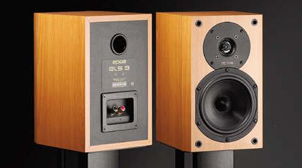

4 ohm is usually easier and gets away with a smaller coil. 1mH and 10uF is near enough usually. The Epos ELS-3 used a polycone, but possibly the simple 4 ohm filter works well enough. I happen to have a couple of these 4 ohm basses, hence my interest.
But Troels Gravesen usually knows what he is doing too. These are 8 ohm (nominal) drivers.
