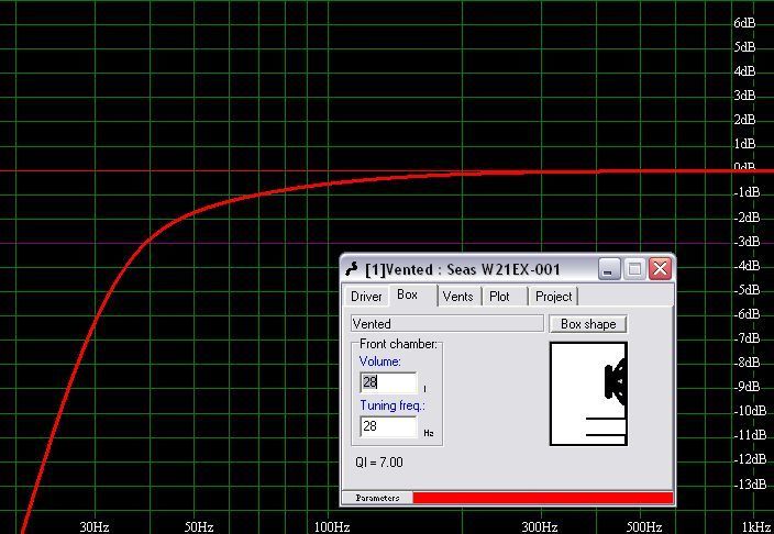

R rho Member Joined 2003 2007-12-05 7:28 pm #1 2007-12-05 7:28 pm #1 CD22RN4X Anyone ever used this woofer as a subwoofer or a woofer in a 3-way design? According to the Dutch distributor of SEAS you can use it in a 28liter BR. How does it perform in such a small enclosure? S sreten R.I.P. Joined 2003 2007-12-06 12:16 pm #2 2007-12-06 12:16 pm #2 Hi, That about as big as it can get, very well tuned to ~ 28Hz, -10dB 25Hz. 🙂/sreten. Attachments guff.jpg 65.6 KB · Views: 463 Status Not open for further replies.
