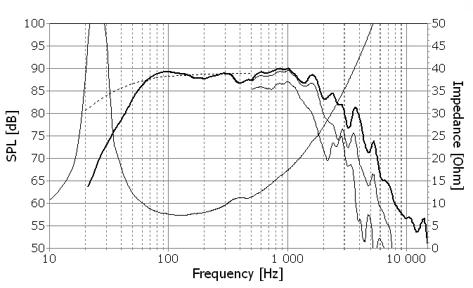

What is the crossover frequency for Seas A26? Will be grateful for that info.

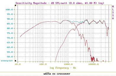

system7 Member 2008-08-03 1:32 am Portsmouth UK 2016-06-07 2:57 am #4 2016-06-07 2:57 am #4 SEAS A26 Kit Most likely 2kHz, IMO. That's why you need the big tweeter. Without any bass coil, the -6dB point of the SEAS A26RE4 woofer is certainly about 2kHz. Below. Peter Comeau used a tidge of slope and a notch in his similar WDA25 EX design, but not much: http://www.hi-fiworld.co.uk/loudspeakers/68-technology/142-designing-loudspeakers-wd25a-the-final-crossover.html Attachments SEAS A26RE4 Woofer.PNG 88.6 KB · Views: 285 Peter Comeau WD25A EX.JPG 35.4 KB · Views: 282 Last edited: 2016-06-07 3:01 am ••• More options Share

N nugat Member 2016-04-20 12:27 am 2016-06-07 8:04 pm #6 2016-06-07 8:04 pm #6 From the woofer's frequency response chart it looks like 1500-1600hz is the most it should attempt. The tweeter looks like still good at 1300-1400. So maybe 1500hz is a good meeting point? ••• More options Share
