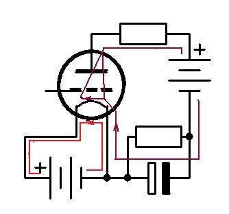

Electrons always go from minus to positive, also in the heater wire.On the way from -5V to +5V it loses electrons to the outside direction anode.All the electrons flowing away on the positive side have to come from the -5V end without tap.
By feeding electrons to the tap releaves the first part of the heater from conducting the hole Ia.
Without the tap the negatieve side of the heater gets more current and hotter.

We can agree that the current in/out of the terminals can be changed. But the bias-voltage at every point along the filament is effectively the same, whether you have a centre-tap or not. It's the bias voltage that determines the current distribution from the oxide coating.
The positive side takes more of the current: V(grid-k) is lower = hotter bias.
Electrons can't go in two directions in the same conductor at the same time. In the heater current flows from minus to positive.Those who leaves the cathode has to come from the negative side. With more emission on the positieve side (hotter bias) means more electrons pass through the negatieve side to get there. Result is the more you get to the positive side the less current flows.
The negatieve side starts with If+Ia and at the positive side is only If. With a resistor between minus and tap part of the bigger current is bridged and pass to the less current part.

The Negative side and the centre-tap are already bridged by the filament substrate - the non-emissive part of the filament. To be specific, for the EML DHTs half the filament amounts to about 1.8Ω while it is heated.
Given that low value resistance is already present across these two nodes, what value of external resistor are you proposing to apply, that will make any (substantial) difference?
Electrons always go from minus to positive, also in the heater wire.On the way from -5V to +5V it loses electrons to the outside direction anode.All the electrons flowing away on the positive side have to come from the -5V end without tap. By feeding electrons to the tap releaves the first part of the heater from conducting the hole Ia. Without the tap the negatieve side of the heater gets more current and hotter.
You are worrying about the heating effect of the anode current in the actual substrate of the filament?
Putting some numbers in, based on EML 300B Uf=5V If1.35A; Ia=70mA
Effective hot resistance of the filament substrate is 3.7Ω
Power dissipation in HALF of the filament:
- Due to heating current: ca. 3.4W
- due to the whole anode current Ia: ca. 0.009W
There is no need to be concerned about this negligible power dissipation increase - even if you could change it.
With a heater current of 1200mA the difference of half the anode current 70/2mA between the two heater sections is only 3%, not very much indeed. The resistor i proposed was an answer to the question, what to do with a center tap, not to solve a real issue. Question what value for the resistor, suppose Ia=70mA, the rsistor is 5V/70mA=~70Ω
