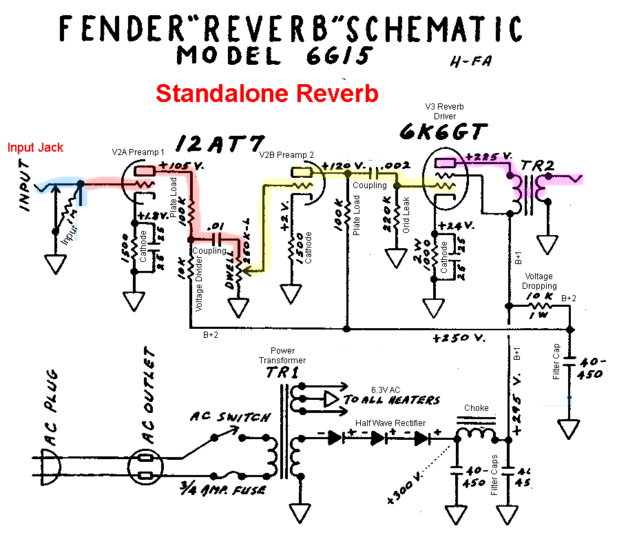

Does anyone have a schematic for a simple single ended guitar amplifier using a 6K6 output tube? I have a PT, and a 9.2K OPT that should work well. I recently built a 5F1 head amp using leftover parts and iron I had on hand and noticed I had iron that would suit the 6K6's I found in my tube stash.

the 6K6 should work in most 6V6 applications if you adjust the cathode resistor and make sure you don't exceed the g2 voltage. Valve Wizard and the datasheets should be all you need. https://www.valvewizard.co.uk/se.html

Build another Champ or an AX 84 (many tasty flavours available) or any 5W single ended tube amplifier, only substituting power tube and OT by what you have.
Get biasing (suggested cathode resistor) from proper datasheet.
Amp will be 90% of what each project offers, only with a small and unimportant RMS power difference.

Isn't that a 6G15 with a bunch of back-end left off?a simple single ended guitar amplifier using a 6K6 output tube?

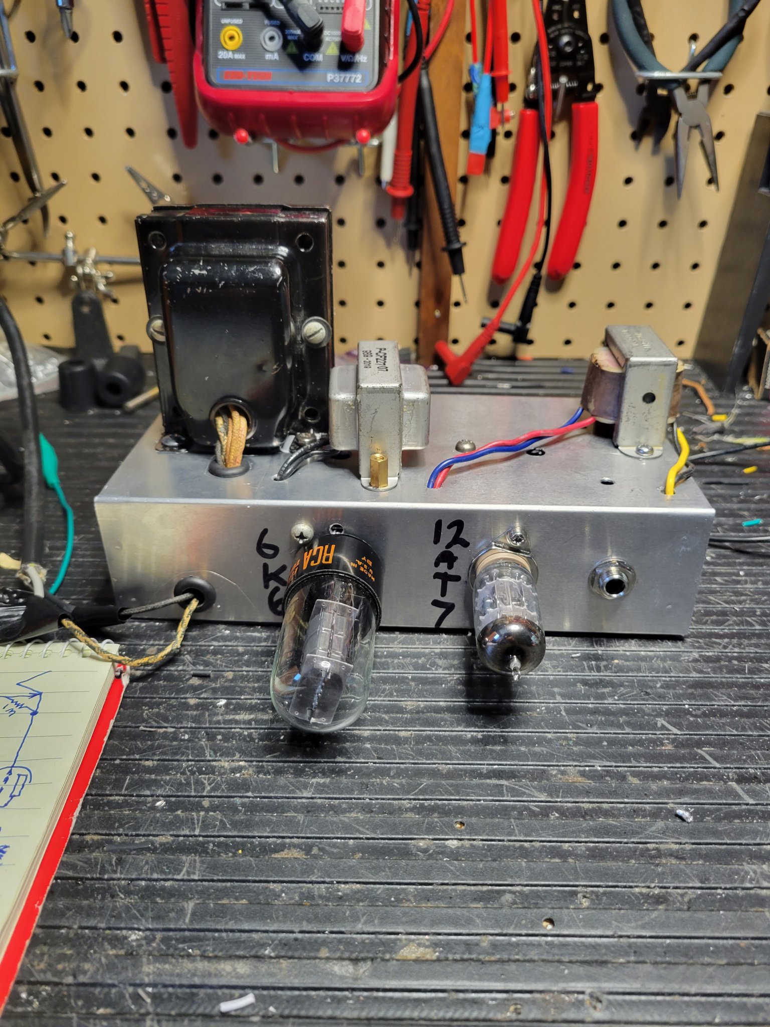

This is what I'm playing with. Since it's going to power a speaker, and not a reverb tank, I'll drop the 6K6 cathode resistor from 1000 ohms to around 480 ohms. I also have a 7.9K OPT to use. The values of the coupling caps will need to have a higher value.Isn't that a 6G15 with a bunch of back-end left off?
https://robrobinette.com/How_Spring_Reverb_Works.htm
Diddle 'voltage divider' for appropriate sensitivity. 12AT7 is fine except not in stock at Barney's Music And Bait on holiday weekend; use 12AX7 like everybody does.
I'm just not sure what values to start with.

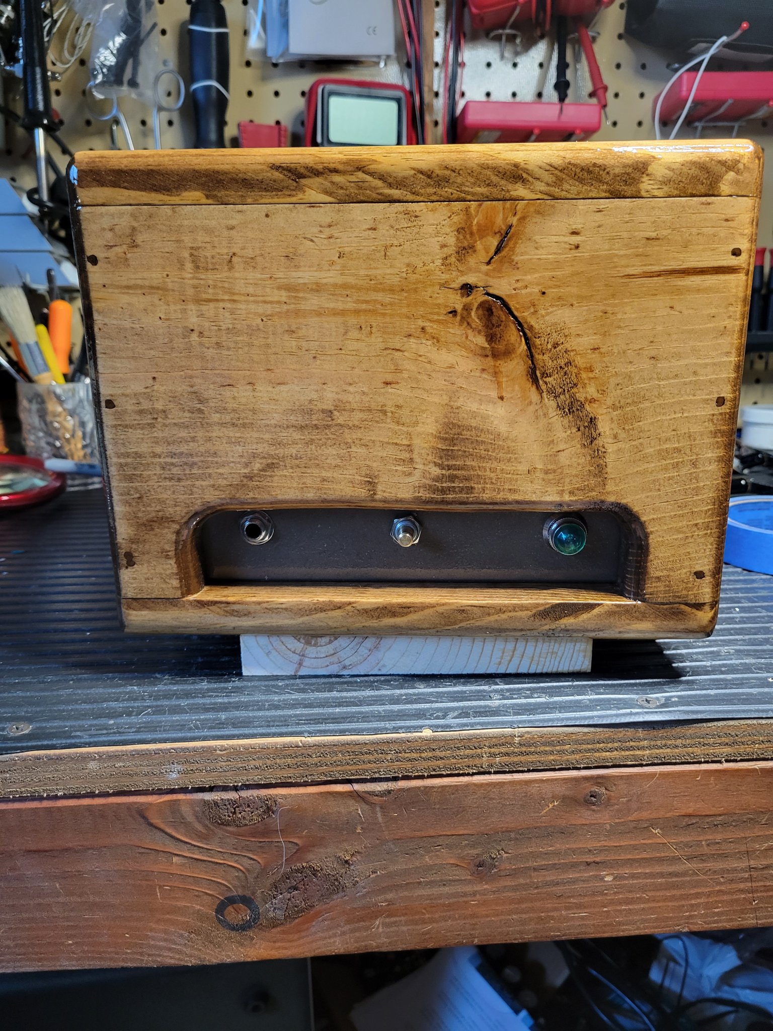

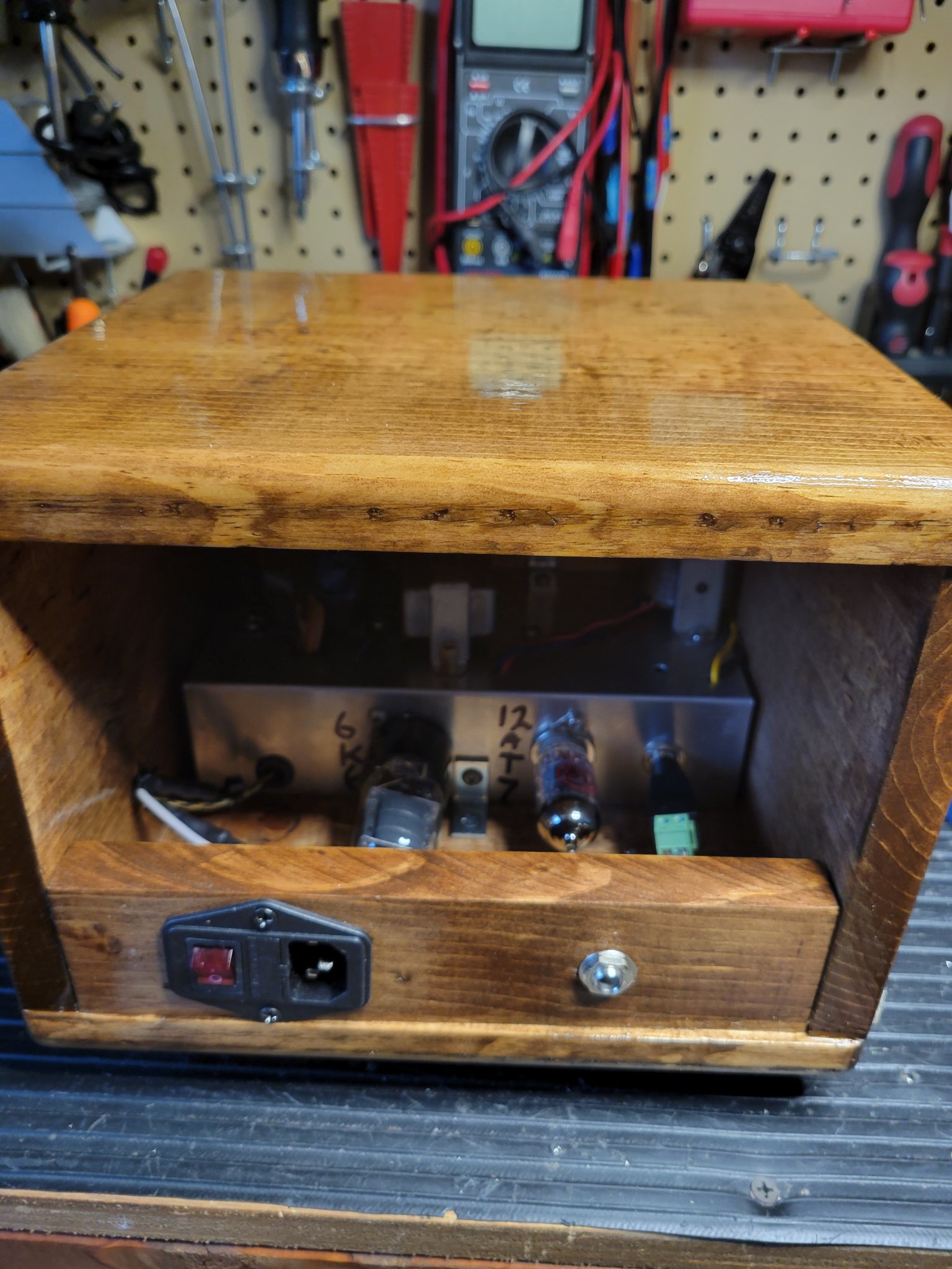

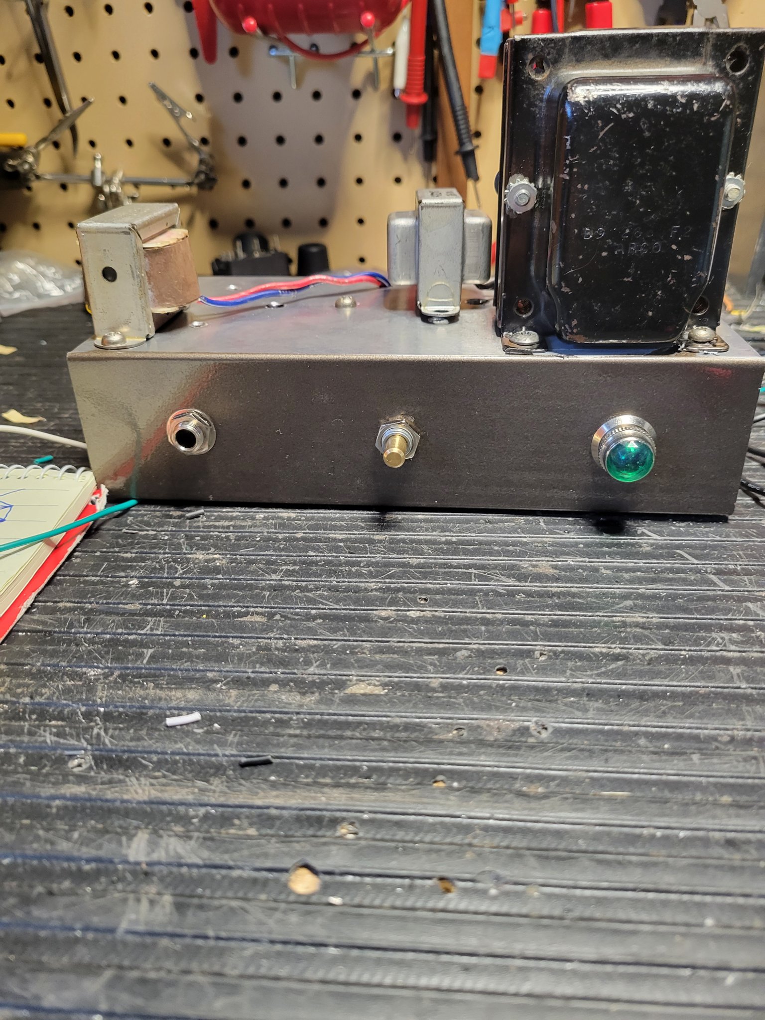

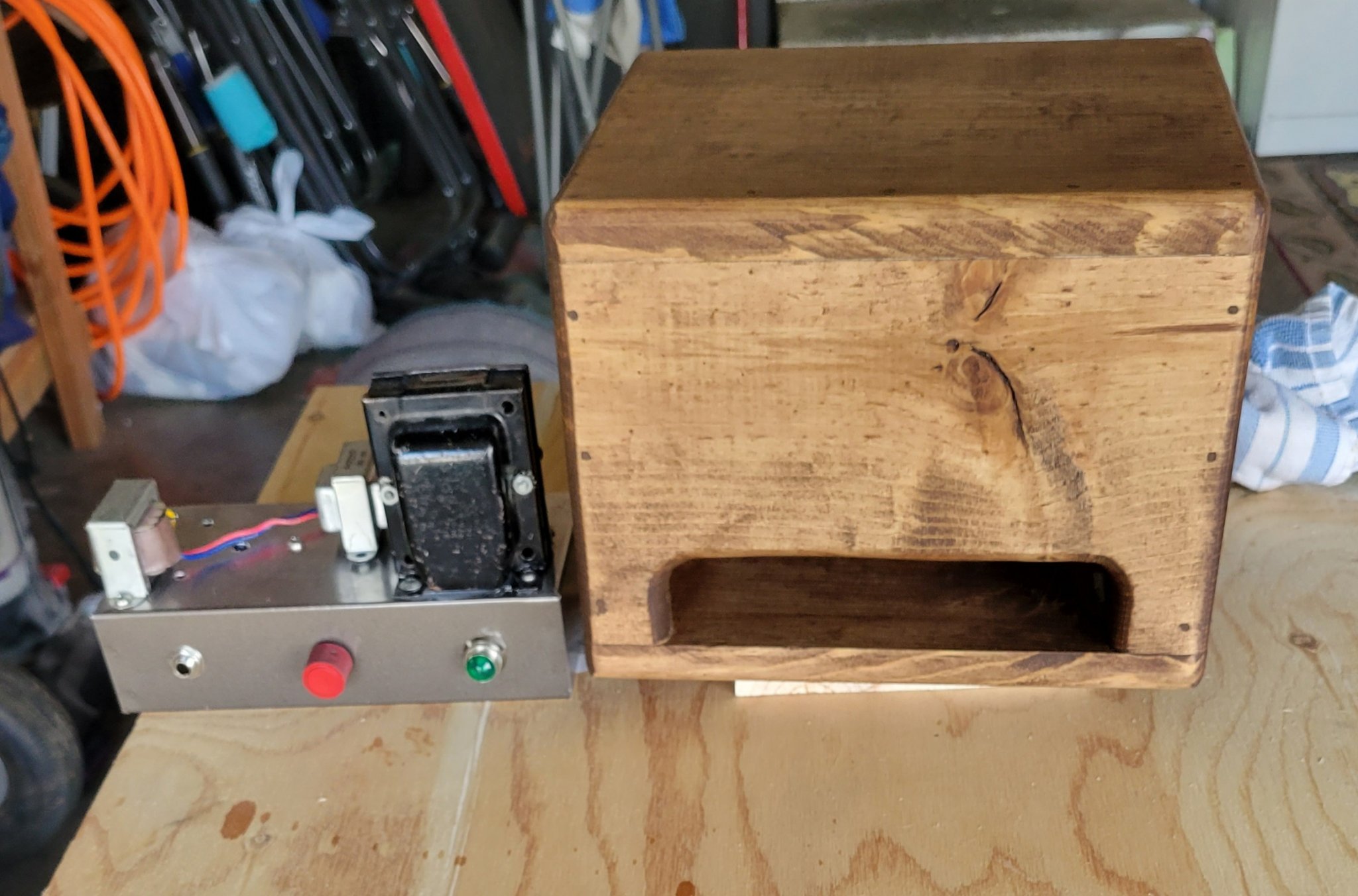

Ok, I used the schematic that PRR posted above. It's half of the Fender 6G15 reverb unit and with a few tweaks works. I used .022uf coupling caps, a 470 ohm cathode resistor ot the 6K6 and the 7.3K OPT I had on hand. A 12AX7 was too much gain and the amp broke up too early. The 12AY7 sounded good, but wasn't enough gain to get any crunch out of it. That may be just fine for some.
The 12AT7 the schematic originally calls for probably the best for most.
In the end, not bad for a little amp built from left over bits I had laying around.

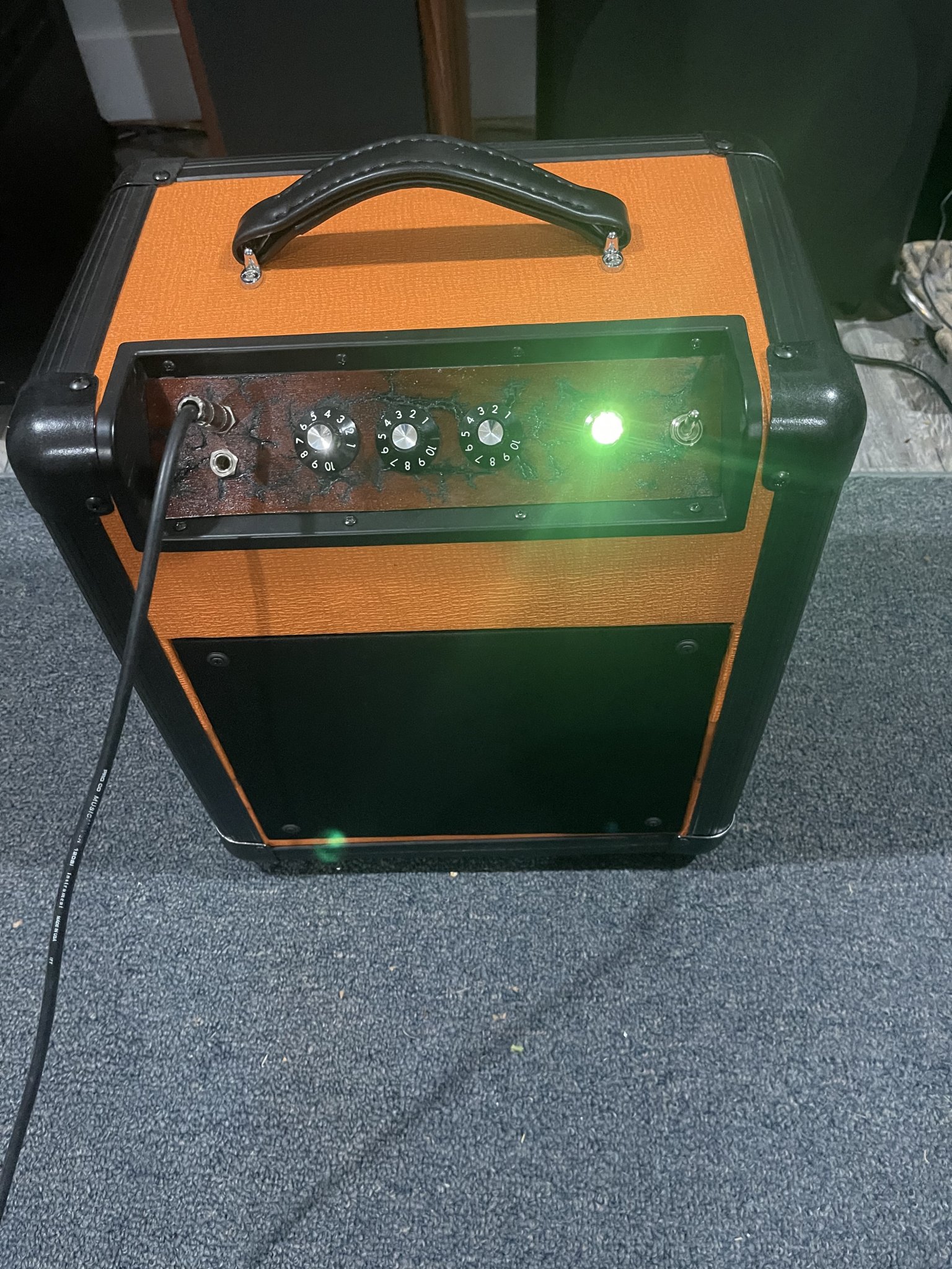

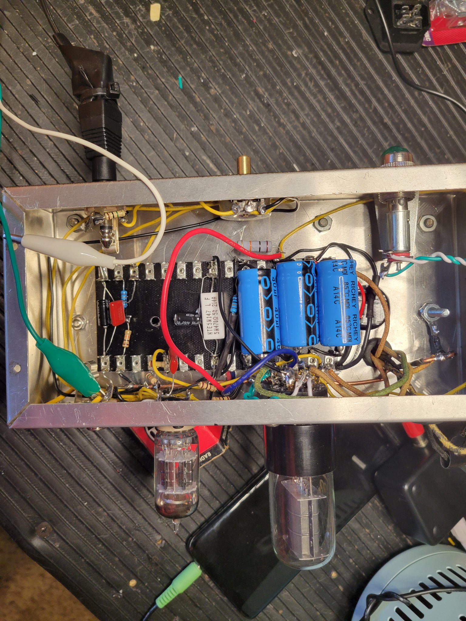

Nice. I've built several small SE tube guitar amps. They're fun to build.Here’s my little Fender clone just finished.
My last wrong forum post I promise. 😁 View attachment 1077190
This last one was just to see what I could come up with not spending any money, just using whatever I had laying around. Next I want to build a Matchless Spitfire PP 6BQ5 combo.
