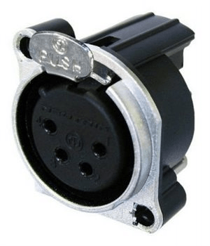

Please recommend some screws that I can use for 4 pin XLR Neutrik connector. https://uk.farnell.com/neutrik/nc4fd-lx-b/socket-xlr-black-4pole/dp/1390122
Ideally something like this:
If you are fixing into an aluminium or steel chassis, https://uk.rs-online.com/web/c/fast...ews/?applied-dimensions=4294475694,4294474738
I much prefer the behind panel version: NC4FBH or NC4FBH-B for black. Much cleaner looking. I use M3 screws and run a tap thru the ears. Countersink if you want to go to the trouble (I did). These are set up for M2.5 fasteners, but those are difficult to come by in the US. M3 works just fine.
