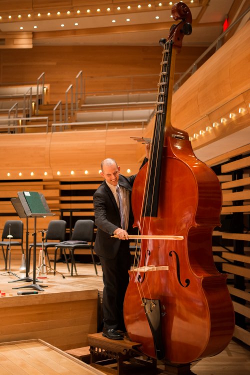

a grown up sized double bass sounds far better and fuller than the 3/4
OTOH, the stock double-bass is clearly "short" compared to the assumed-perfect violin. Harry Brandt and Carla Hutchens scaled to the "right size" 'contrabass violin', but there seems to be only a few in the world.
https://en.wikipedia.org/wiki/Violin_octet
Somehow the Octobass is at least as common but I think it is tuned lower. And you stand on a stool. And nobody can finger-fret it, it has lever-frets. And a stool is built-on.
