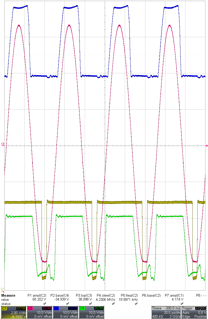

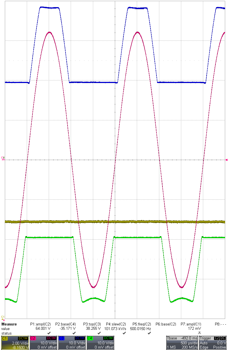

Maybe this can help you. It from a class G made with TDA7293.
The yellow trace (C1) is the clip detector output, red (C2)it is the output and blue and green are the variable supply lines.

@sesebe:
I read the thread you linked to. You didn't use any external components but just brought pin 5 to a connector/header. So what you show in yellow in the plots is the behavior of pin 5, which is to go low when there is clipping.
