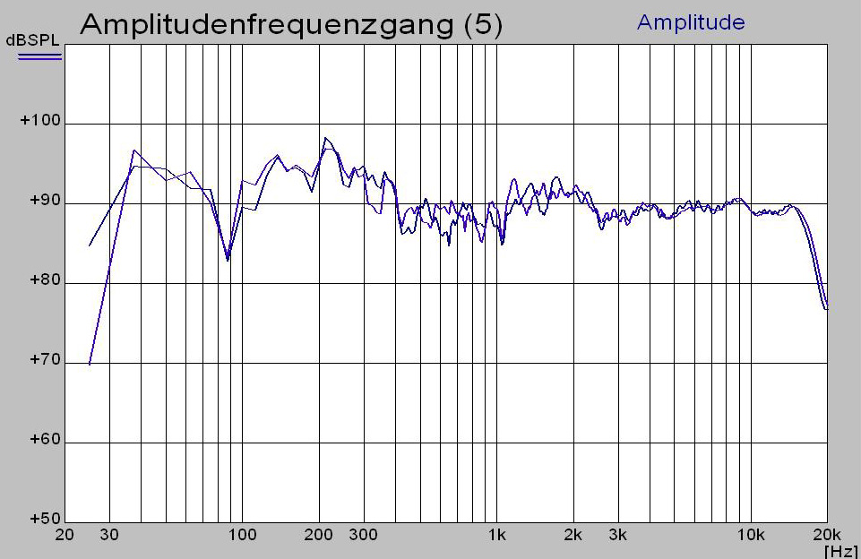

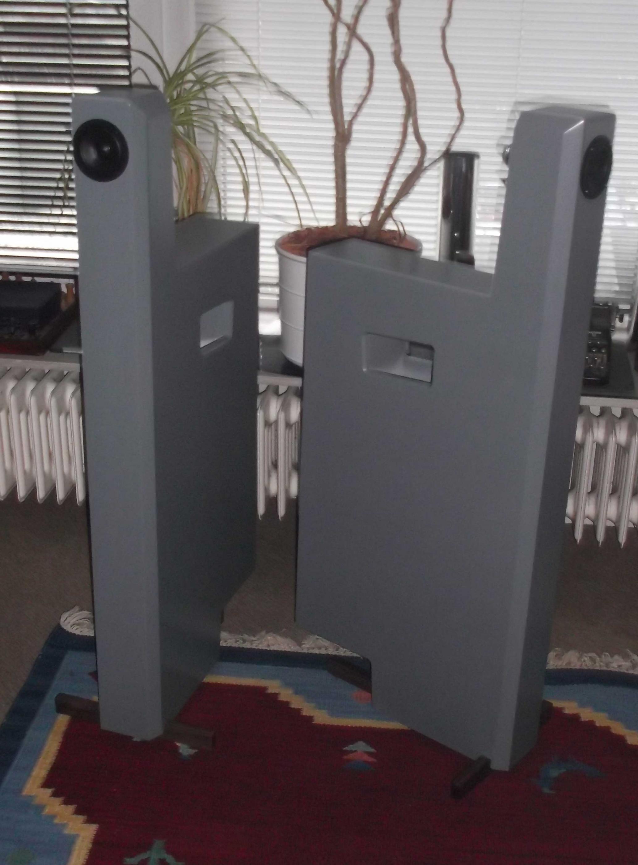

Mini Posaune
Hello,
i made a superb experience with both drivers,
http://www.diyaudio.com/forums/full-range/249361-mini-posaune.html
MPmess
Hello,
MPmess
