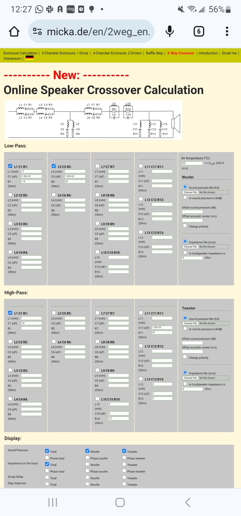

I am using it in a two-way with an SB Acoustics tweeter, and just want to quickly model the upper freq area in this online crossover tool that allows FRD and ZMA files, so I can pick values for my first go-around with the crossover. Right now, planning an easy first order crossover.

I am using the SB Acoustics SB21SDC-C000-4 tweeter.

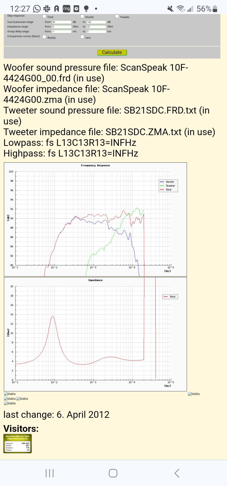

Woofer crossover: 0.2mH in series, and 23.5R in parallel to slightly tame the impedance spike
Tweeter: 10uF in series
Not too bad for a simple first order setup. Of course it does not yet account for baffle effect.
Parts come today. Should be able to wire up and test it out this weekend.
