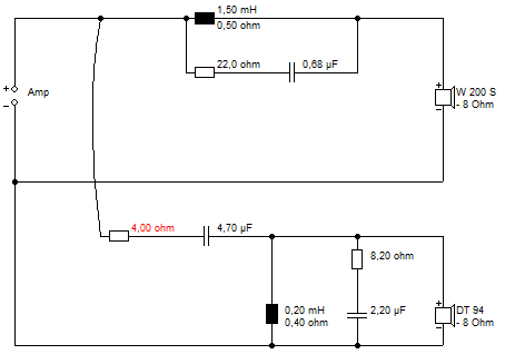

I know we've had some lively conversations about those Scan 18W woofers.
It actually does seem the best thing to do with them is a coil and a notch with a crossover around 2.2kHz.
Troels Gravesen is quite smitten by the new Scan 18W/8542-10 :
Studio-101-mkII
I must try that crossover idea of his. It is in my back catalogue:

Seems like Room Gain works just like Troels usually models it.
What did you think of Troels' new design? Studio-101-mkII
I wonder if it would work with your driver? Be interested to see some sims.
